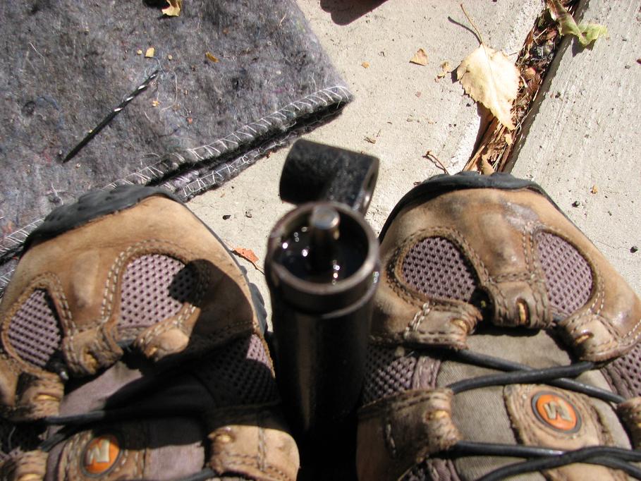

The front end of my engine sounded like that as well. I found the old tensioner to have a leaking seal. The plastic safety bushing likely saved my valves from the old tensioner.
Leaking Tensioner.jpg (127.73 KiB) Viewed 3669 times

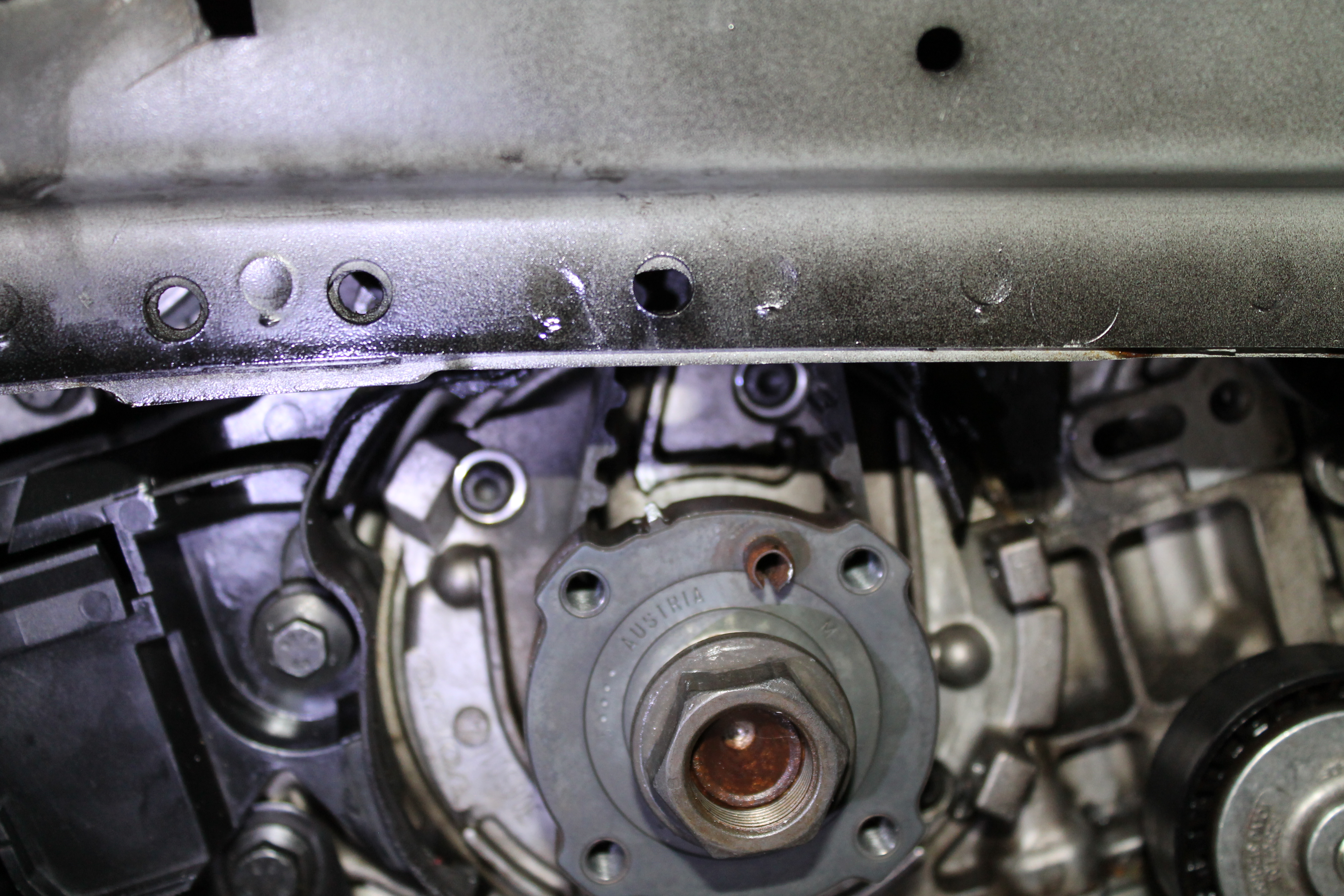

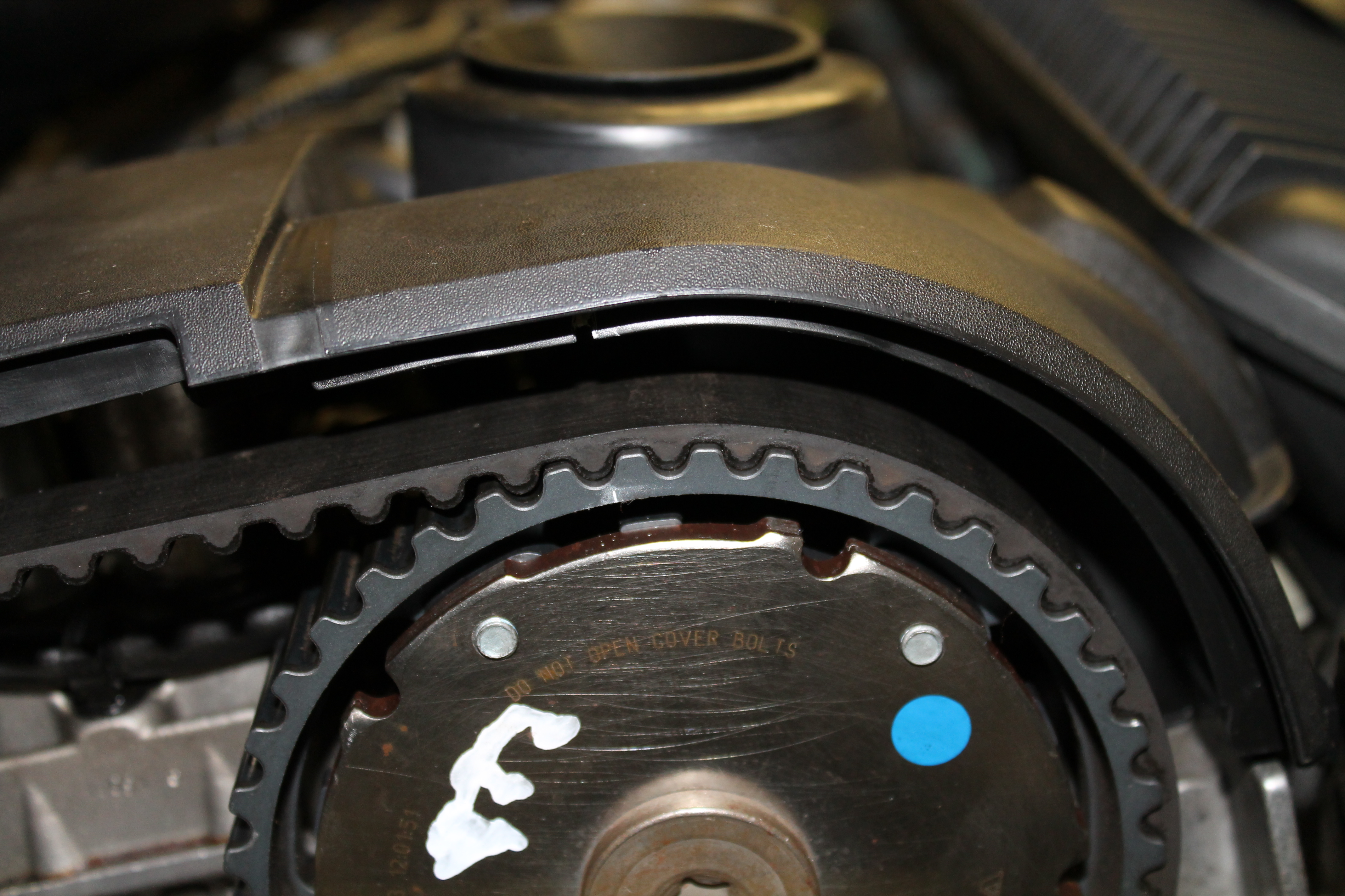

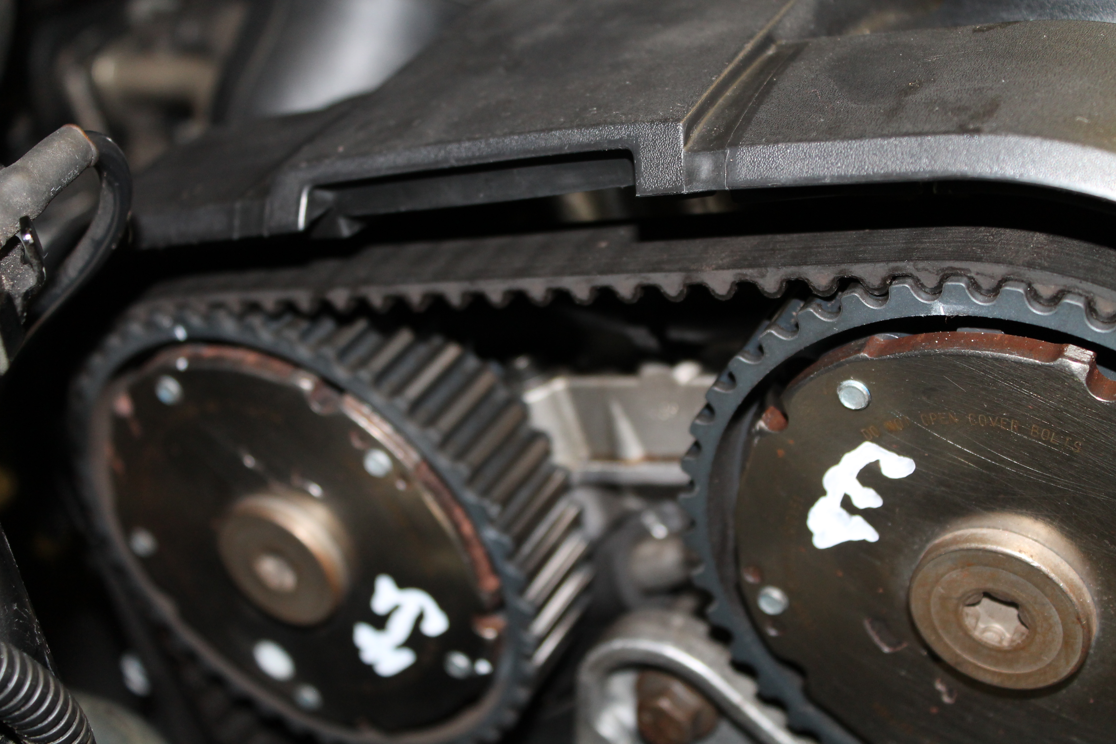

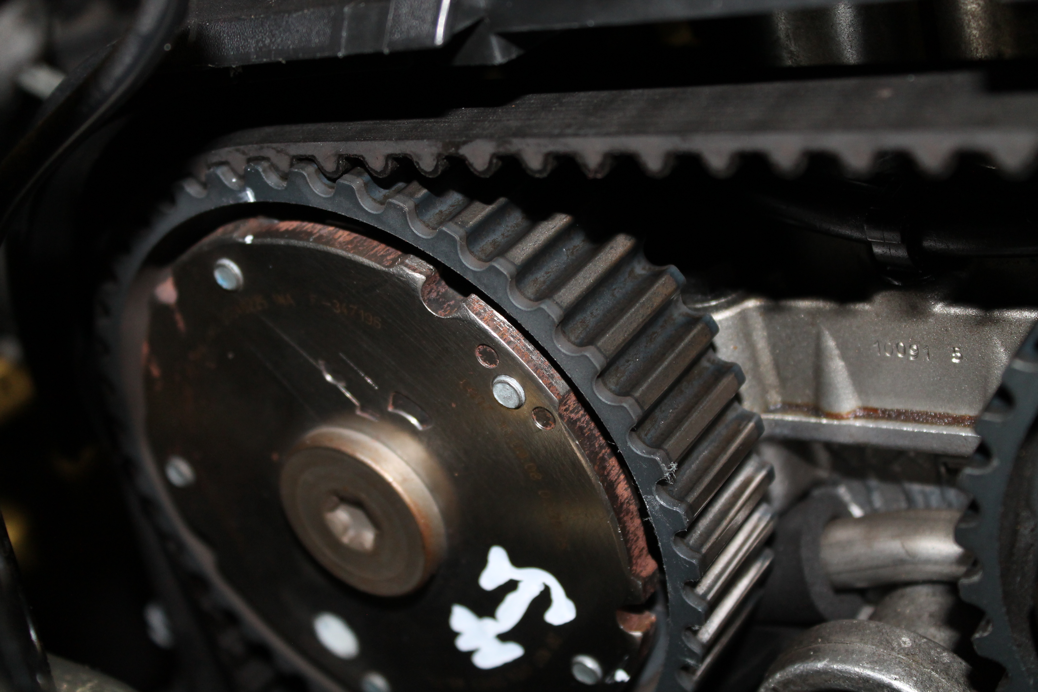

Hi Everyone,
I have a 2011 C70 that I have to replace the camshaft seals on and I have read all the procedures but I am a little nervous in making sure the timing marks are all aligned before beginning the process. I have taken some pictures, and was wondering if anyone can verify if I am good to go? I am not new to mechanical work but very new to a Volvo. Attaching pictures and if someone could get back to me, that would be great.
Thanks in Advance,
MJ67
