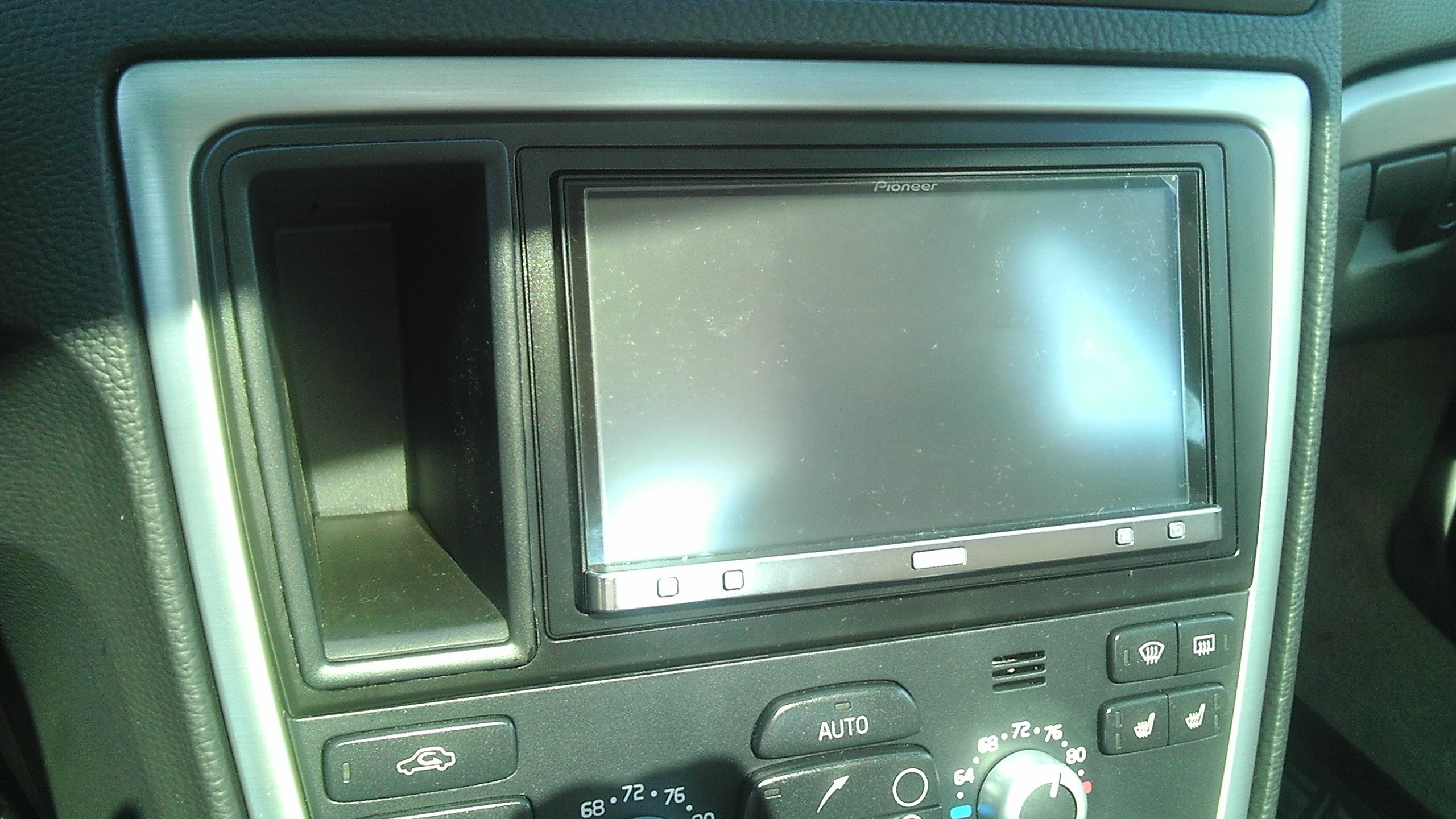

I ran the mic & GPS wires behind the glove box, up the pillar and tucked along the top edge of the window. The mic itself is clipped onto the lip of the headliner next to the overhead light. I used a wire harness adapter (P/N is listed above) so I didn’t have to cut any wires.
I've not given the backup camera much thought just yet, but I need to run two cables; one for the video signal and one for the reverse signal. I plan to run the wires down the center console, under the carpet and along the driver's side of the trunk. Pioneer say the reverse wire needs to be connected to the transmission but from what I've learned, the it only needs to be connected to the reverse light socket so that'll be easy.

Update - a little late but better than nothing, right?
I figured out the noise problem. The radio to Volvo amp adapter cable was not wired properly. I had to crack it open and do it right. The problem was that the negative leads from the RCA jacks were connected to the chassis ground wire, which was detailed in the documentation. I fixed it and no more whine!
I also took some time to Dremmel a hole so I could have my cubby-hole. I also purchased the "ARLiberator" app for my 'droid and its made a world of difference. It really converts your radio into the screen for your phone. Any app I have, I can use. The need to wire the parking brake is gone, so I removed the PAC module. I usually have music playing while I view my GPS or Torque. There's a few hiccups once in a while when I connect to the radio, but a heck of a lot better than the 'stock' Pioneer apps.
I still have to get around to the rear-view camera and connecting the radio to the dimmer. It can get really bright at night, especially when you're looking at an app that has a white background.
