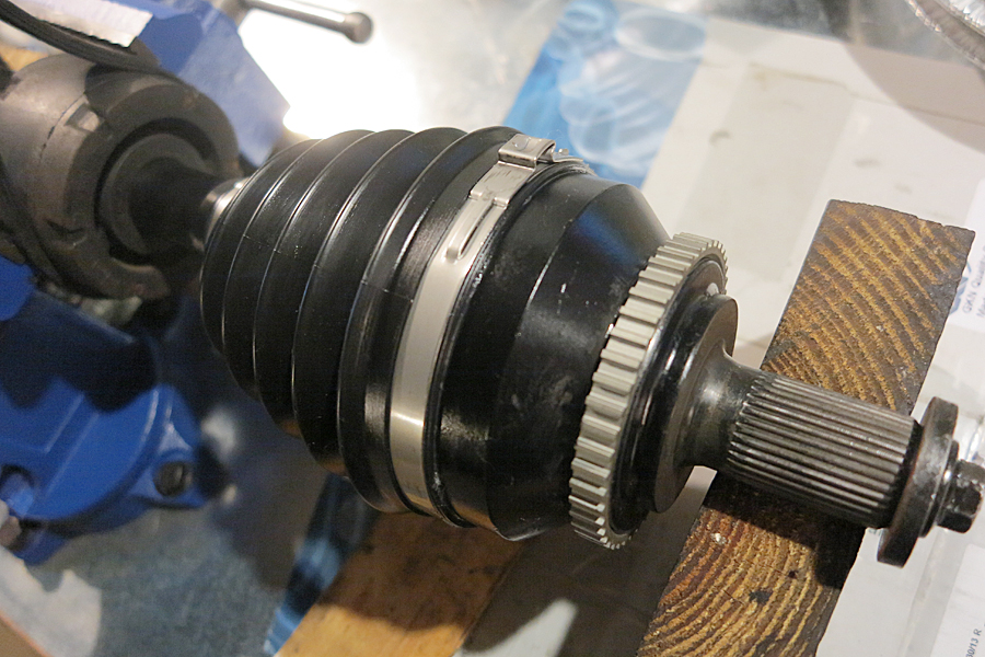

It has been more than 24 hours for the thread-locker to secure the reluctor ring, preparing to assemble the driver's side axle. Here is my progress.
Reluctor ring properly seated and secured

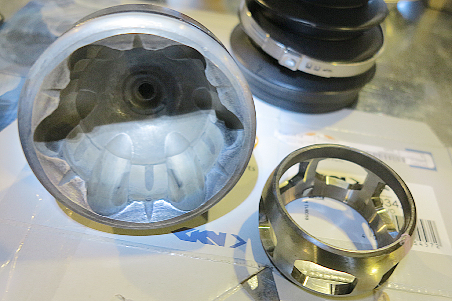

1/2" painter's knife which is normally used for speckling is a handy tool for applying grease - clean method without getting grease all over the rubber glove and loosing grip.
Greasing is a three-step process. There is no need to put any grease inside the boot. The center piece cv cavity where axle shaft would slide in holds 80 gms. 1st - apply on all surfaces for assembly, 2nd - fill and a press with 3/4" deep socket will move the grease to ball housing, 3rd, fill it again the 2nd time with 80 gms then align the cv joint over the shaft and assemble it with gentle taps going over the c-clip.
