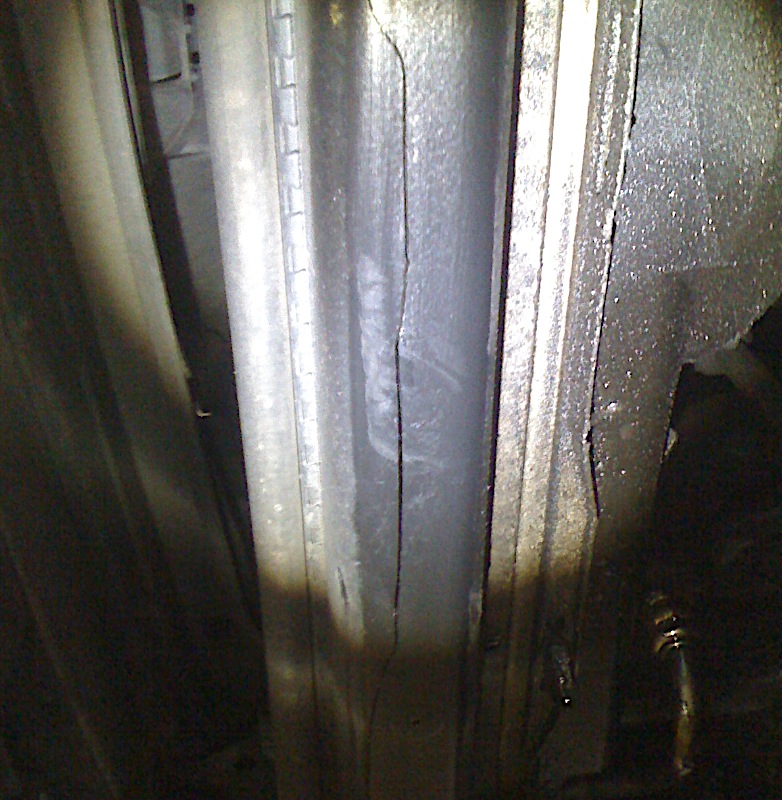

What a cracked intercooler looks like. Again, this would be down the list on possibilities.
Air rushes out of it, and the car develops little or no boost. (NO CODES thrown in this condition :shock:)
