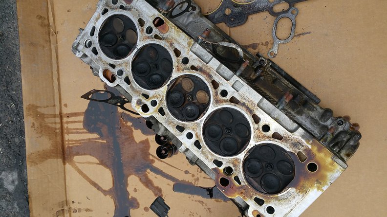

The relief cuts on the top of the pistons are perfectly normal, they are made that way, but if there are any sharp, burred, edges from places where the pistons slapped the valves that sound be filed down or sanded to get the sharp edge off of them.

The pistons look fine.

When you clean up the pistons (if that's the plan) you'll get a chance to see more closely. If a Scotchbrite pad gets caught on any burrs it may pay to raise pistons to the top position and run a sharp flat blade over them.
