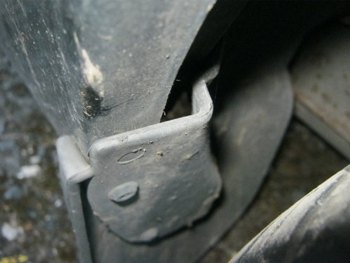

I have verified it would correctly fit my 1995 940 wagon and a friend sent a photo of the same mudflap correctly mounted on a 1994 960 wagon as follows.
Mudflap 9134617 mounted on 1994  960 wagon
mudflap on 1994 960.jpg (44.38 KiB) Viewed 1736 times

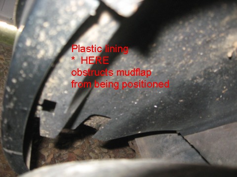

Below is a photo of where the rear fender on my V90 where the mudflap should go. I hope the photo shows how the lining of the fender prevents the mudflap from being mounted. To mount the mudflap would need some significant cutting away of either the fender lining or of the mudflap.
Fender lining on 1998 V90 prevents mudflap from being fitted.
V90 lining obstrcts.jpg (53.91 KiB) Viewed 1736 times
I think my ideal solution is to find a Volvo datasheet explaining the modification needed or, failing that, a clear photo showing the mudflap mounted on a V90.
Thanks again for the help.

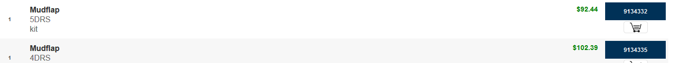

martin calva wrote:My rear mudflap kit is part number 9134612...
Go to this Volvo Dealer's Site, and notice your part number above.
Scroll down the page to "Product Assemblies," then click on
Cover plates, air guides, mudflaps
and you will see, as shown in enclosed photo below (use horizontal scroll bar), Mudflap 5DRS kit - 9134332
There is a programming error....9134332 vs 9134612 are not the same, but on first page cited above, your number was there, but on second page cited above, my number was there.
