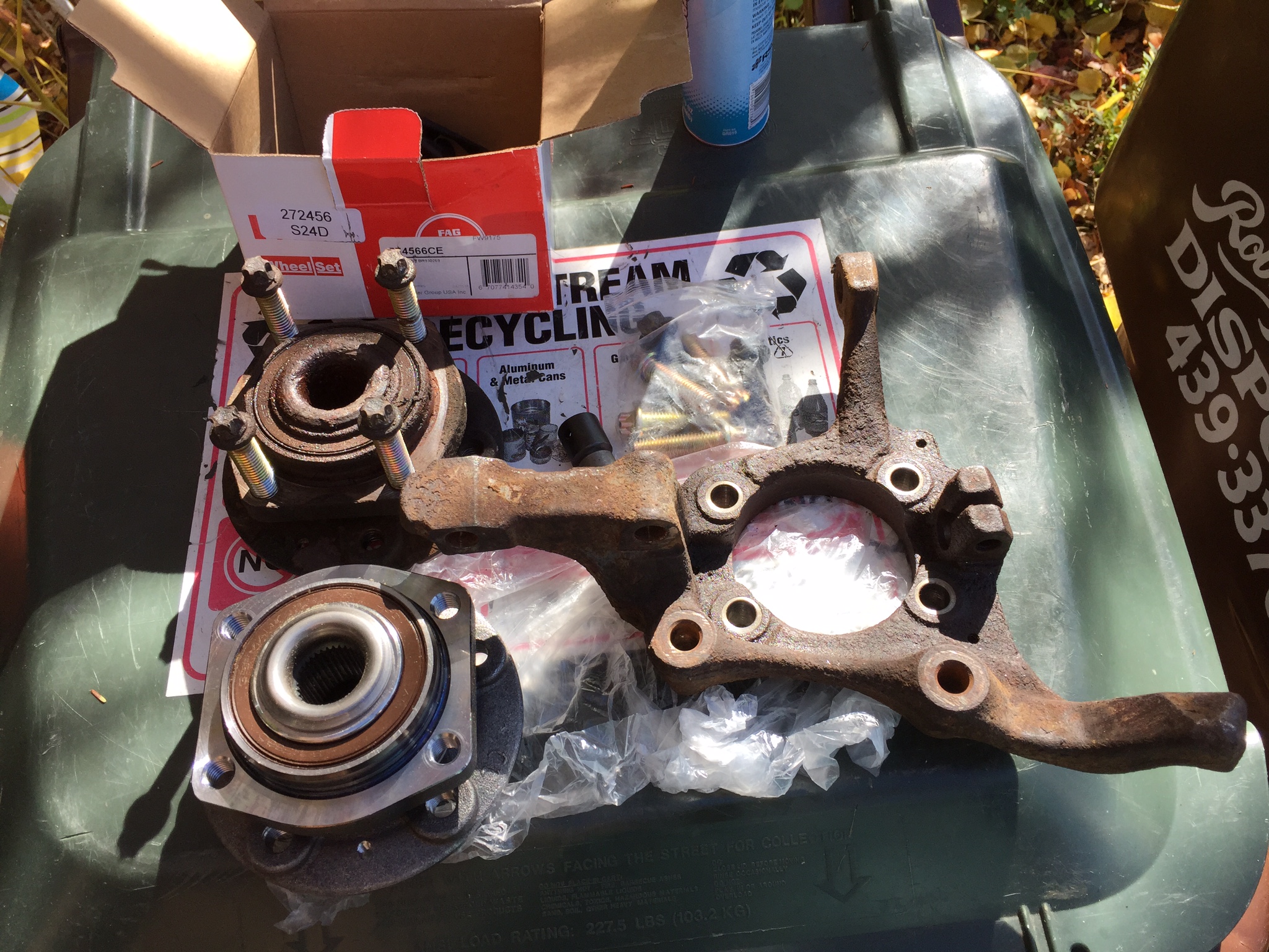

What is the crud around the edge of the axle in front of the reluctance ring in the picture? As I recall I had a rubber cup at that surface on the '99. It was like a seal of sorts.

Nasty combination of rust and crap. No evidence of a seal; rubber, harp, or other.
There is actually a customer service bulletin on this in Alldata about adding this to cars.
I spent about 30 minutes chipping off the rust and wire brushing the hub back to serviceable and get a clean smooth mounting surface for the bearing

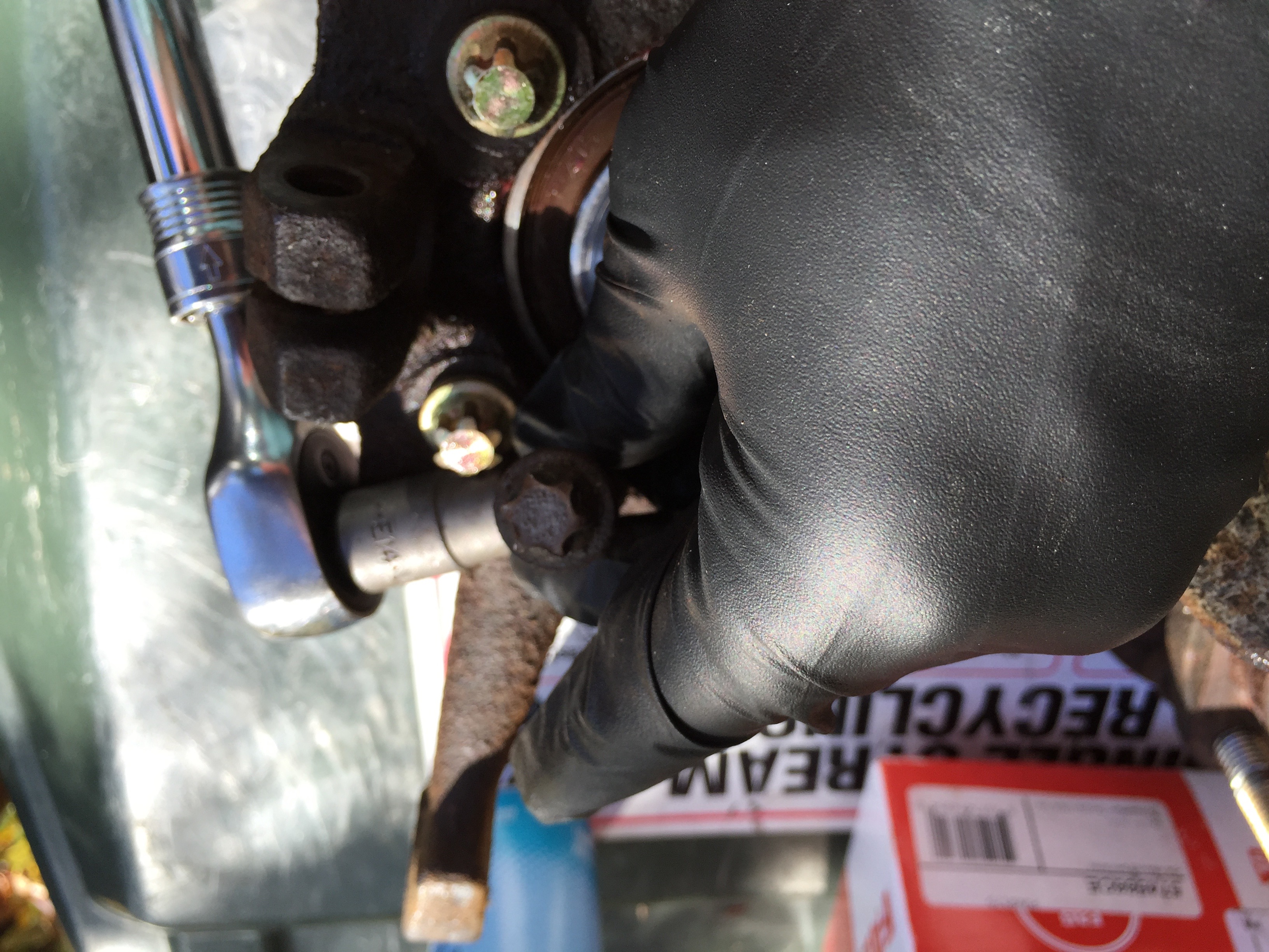

Bit of a curve ball on my new wheel bearing
The old on comes off with a External Torx E14 socket - these bolts needed to be PB-Blasted, rattled for a minute, then came off with an 18 inch breaker bar.
My replacement bearing (OEM FAG from eEuro) had socket screws which were slightly bigger than E14 - a 6 point 11mm hex socket worked fine for the high torque - which is 48 ft lbs plus 60 degree angle turn, lubricated. Thats probably an end torque of near 200 ft lbs

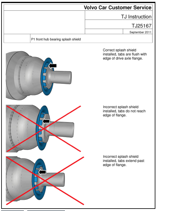

Splash shield TSB from 2011 - adds a plastic shield to the back of the hub to stop your FWB from looking like mine

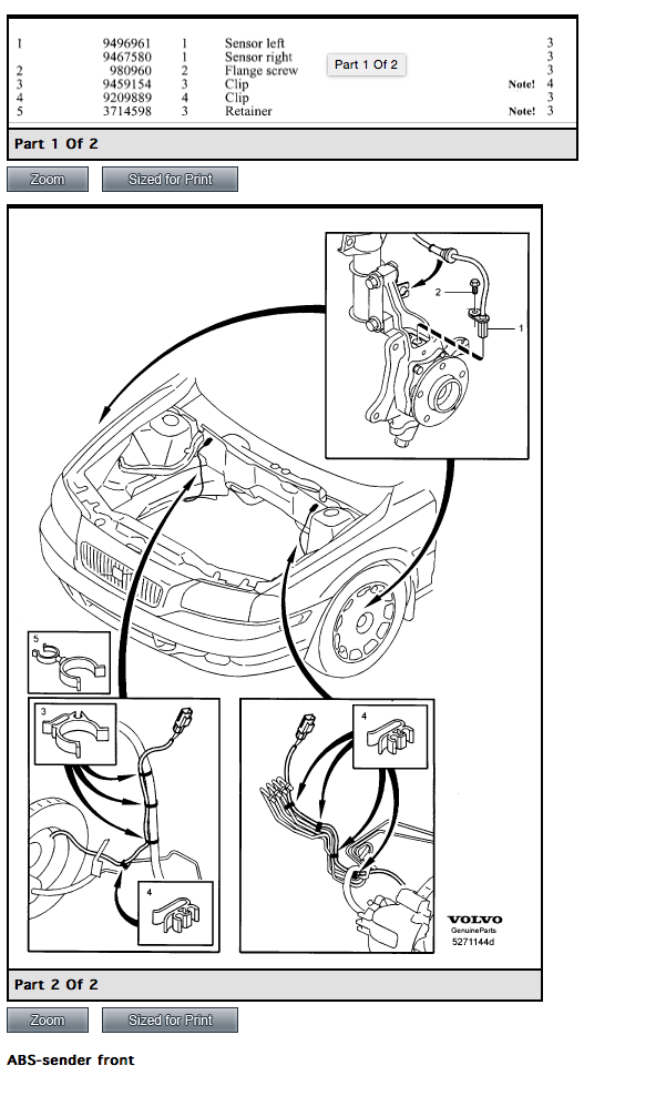

OKay - it cold wet and snotty outside.
Can someone in warm LA country tell me where the front passenger side ABS sensor connect socket is on the late P80s please?
I want to check resistance before I replace this one.
Ah, found it in Alldata...
