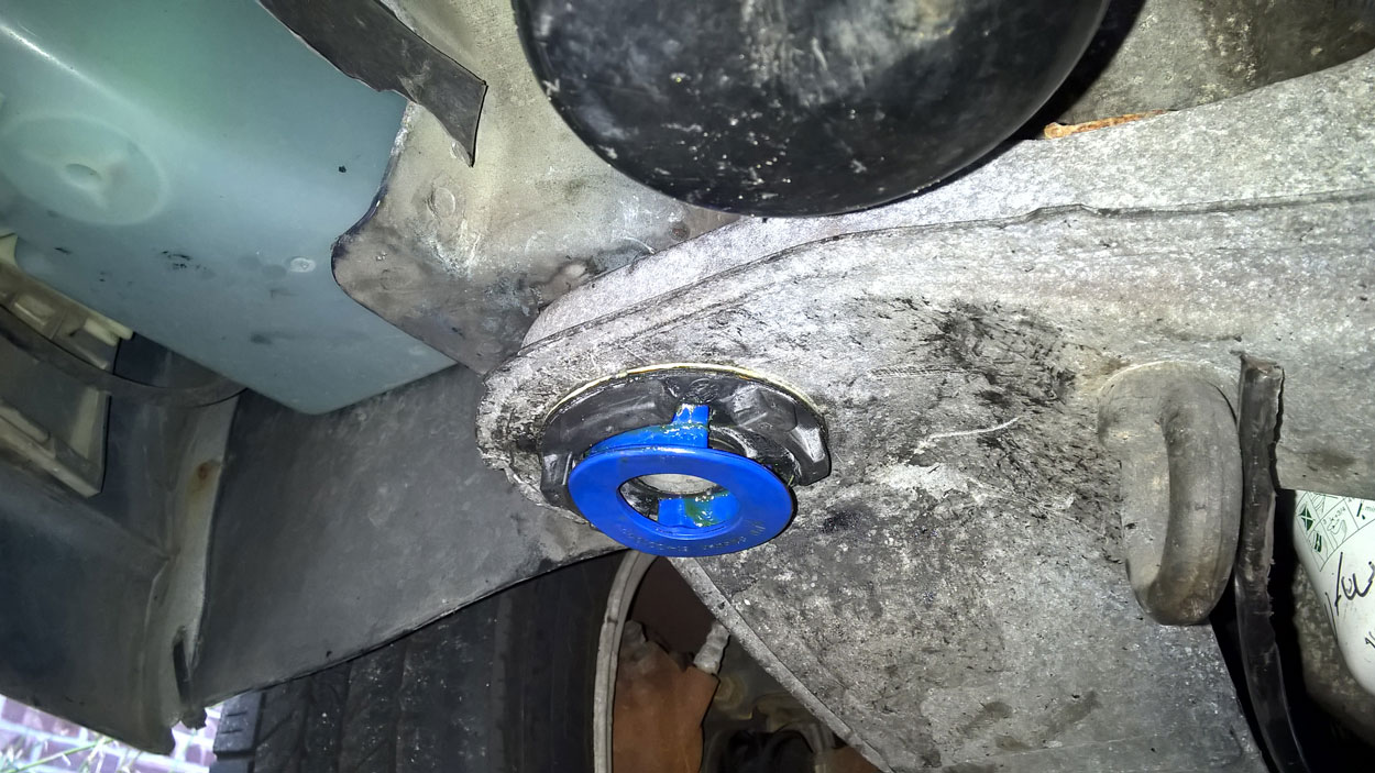

theWIFES_S70 wrote: 28 Nov 2017, 19:00 As for the inserts, they suck. I couldn't get them in...
The proparts bushes aren't open all the way through. There's a film of rubber about 1-2mm thick about half way that has to be sliced or cut otherwise the inserts can't get past that half way point. The OE bushes are open clear through thus the inserts will push in all the way without modification.
I also noticed on the proparts bushes that the holes that the inserts go through aren't quite as big as the holes on the OE bush.
Basically the inserts are made to fit the OE bushes. You might have trouble getting them into aftermarket bushes.

Yes, the inserts are made to work only with the OE bushings. I've heard that they won't fit on aftermarket bushings, like Pro Parts.
