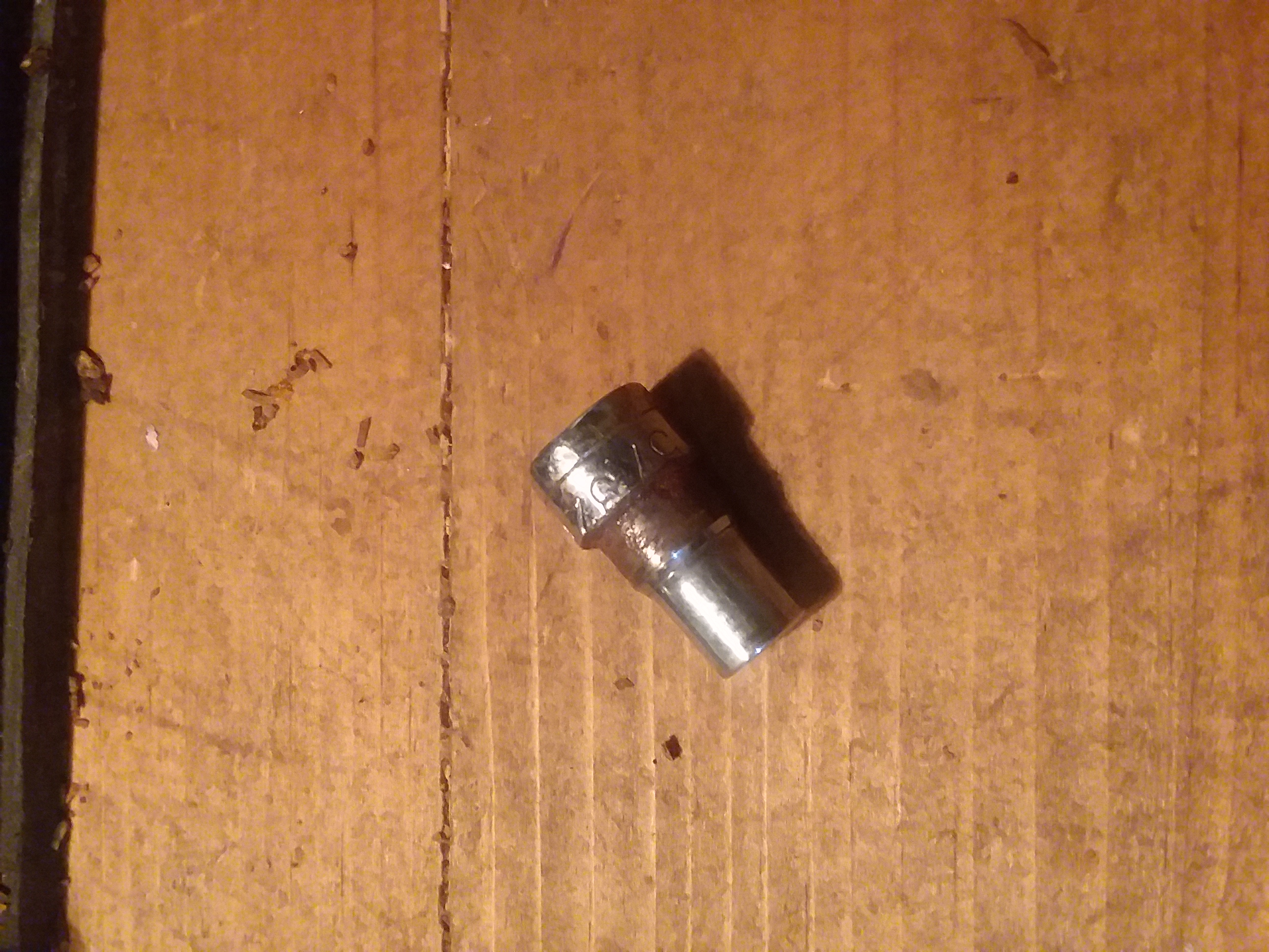

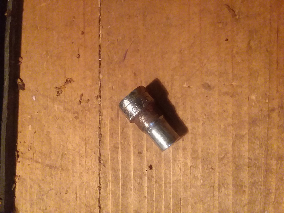

That's a good idea, torx head bolts. Also, just discovered this...the 10mm socket from those cheapo toy-like socket kits are shorter by 3mm - 4mm, and it can even be reduced quite a bit with a belt sander of sorts. Can make your own custom "stubby" socket.

Here's a tiny 3mm socket I turned in a sherline lathe to make it fit a controller board in a Ford.Archer wrote: 23 May 2018, 18:31 That's a good idea, torx head bolts. Also, just discovered this...the 10mm socket from those cheapo toy-like socket kits are shorter by 3mm - 4mm, and it can even be reduced quite a bit with a belt sander of sorts. Can make your own custom "stubby" socket.
Next day at AutoZone I see they sell the special slim socket doh.
