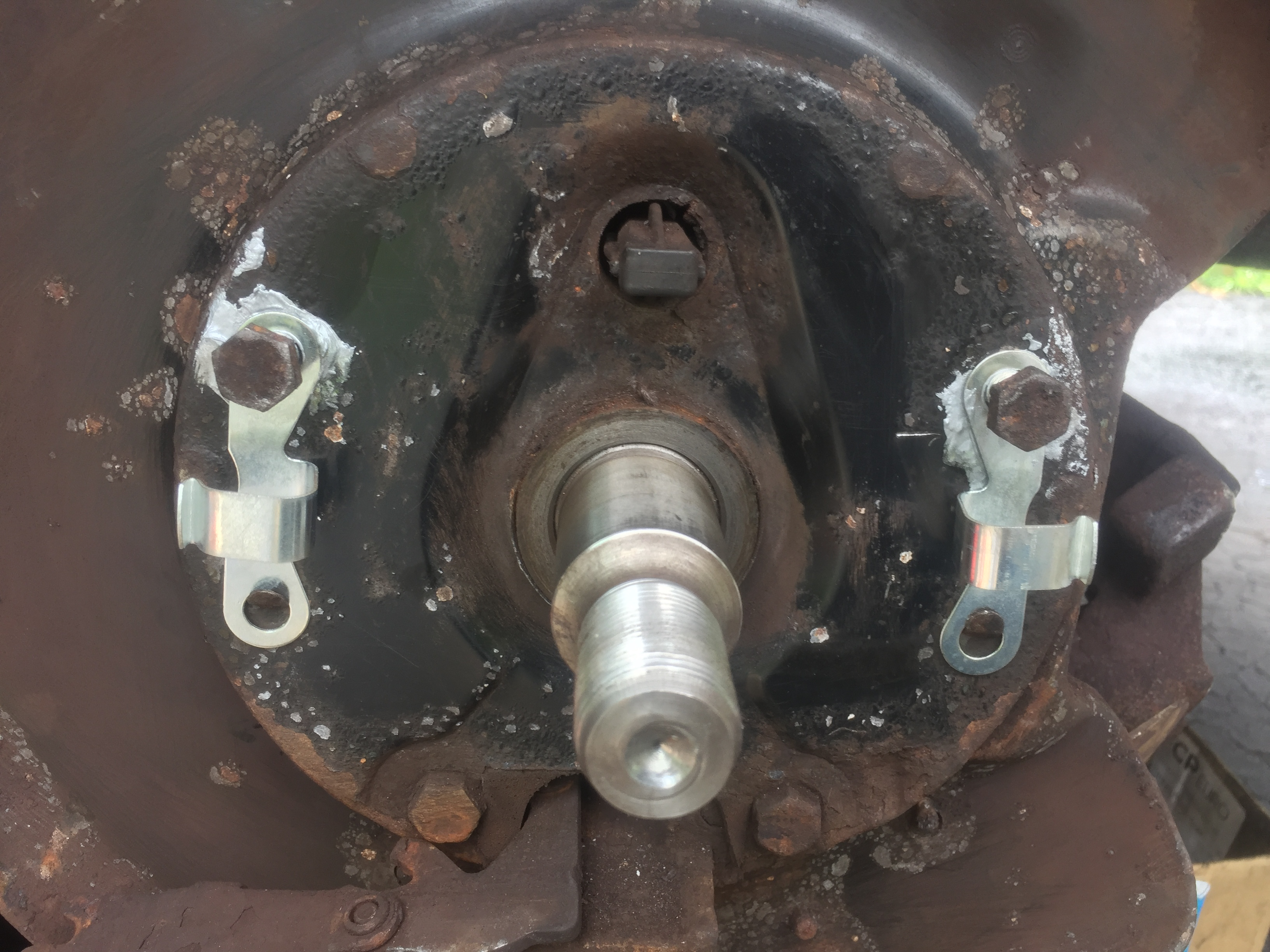

Here is what I found
211800

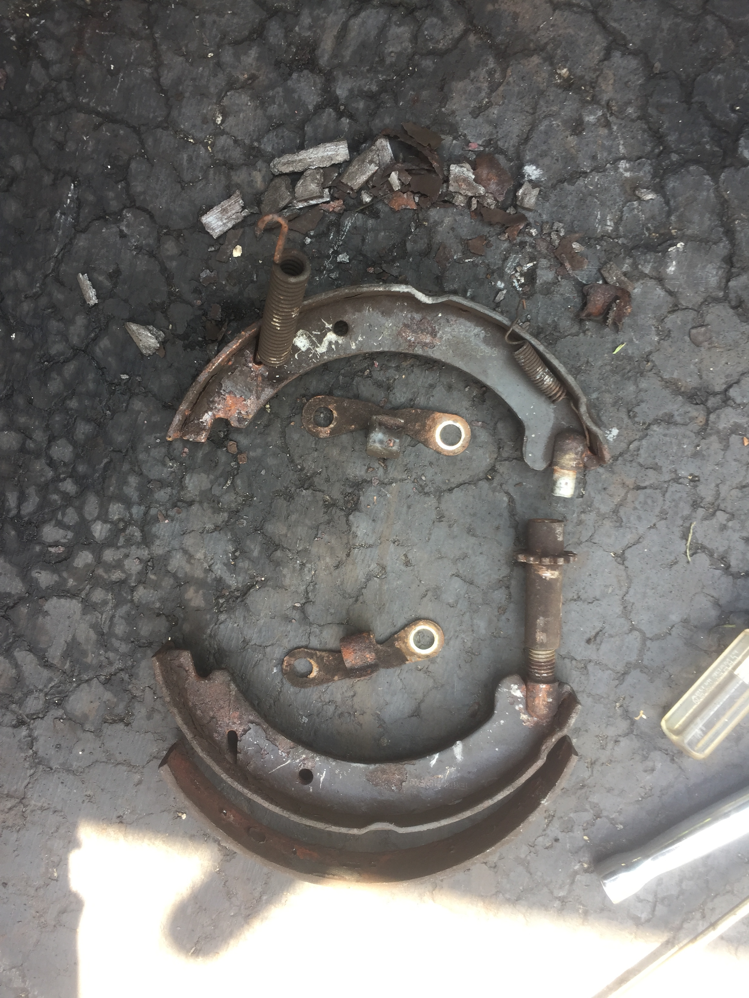

Went in to investigate squeak in left rear wheel, occurs after 20 minutes highway driving, wheel rev dependent, changes on side to side loading
Found right parking shoe completely delaminated
Left parking shoe down to 2mm
replaced left rear bearing with Centric from FCP
Textar parking shoes and hardware
Possible left rear caliper freezing up - inboard pad is worn to groove
Source new caliper, pins, hardware, pads.

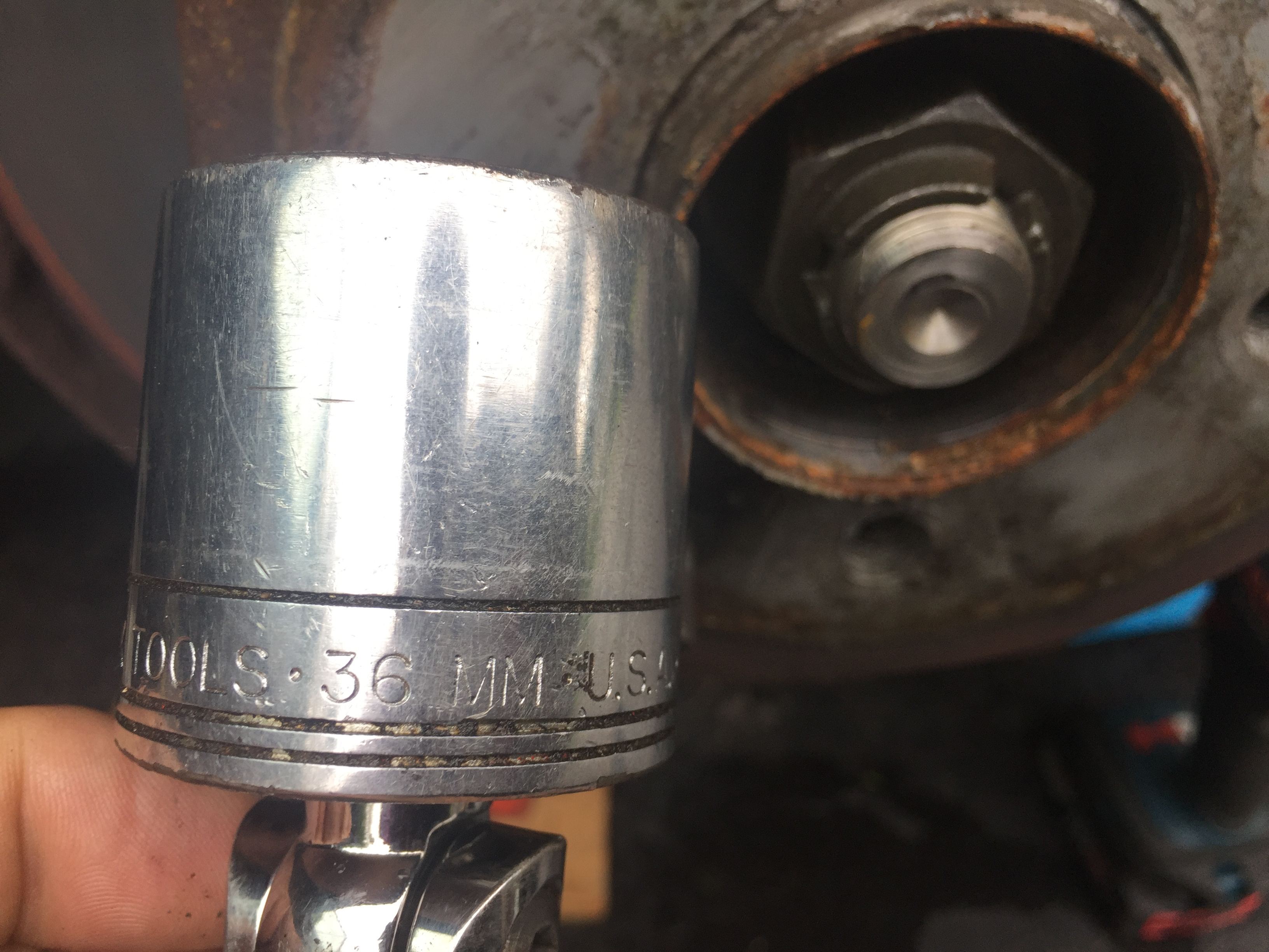

Tool notes
36 mm socket for rear hub nut. 120 Nm +30 torque Single use nut.
Rear caliper bolts M8

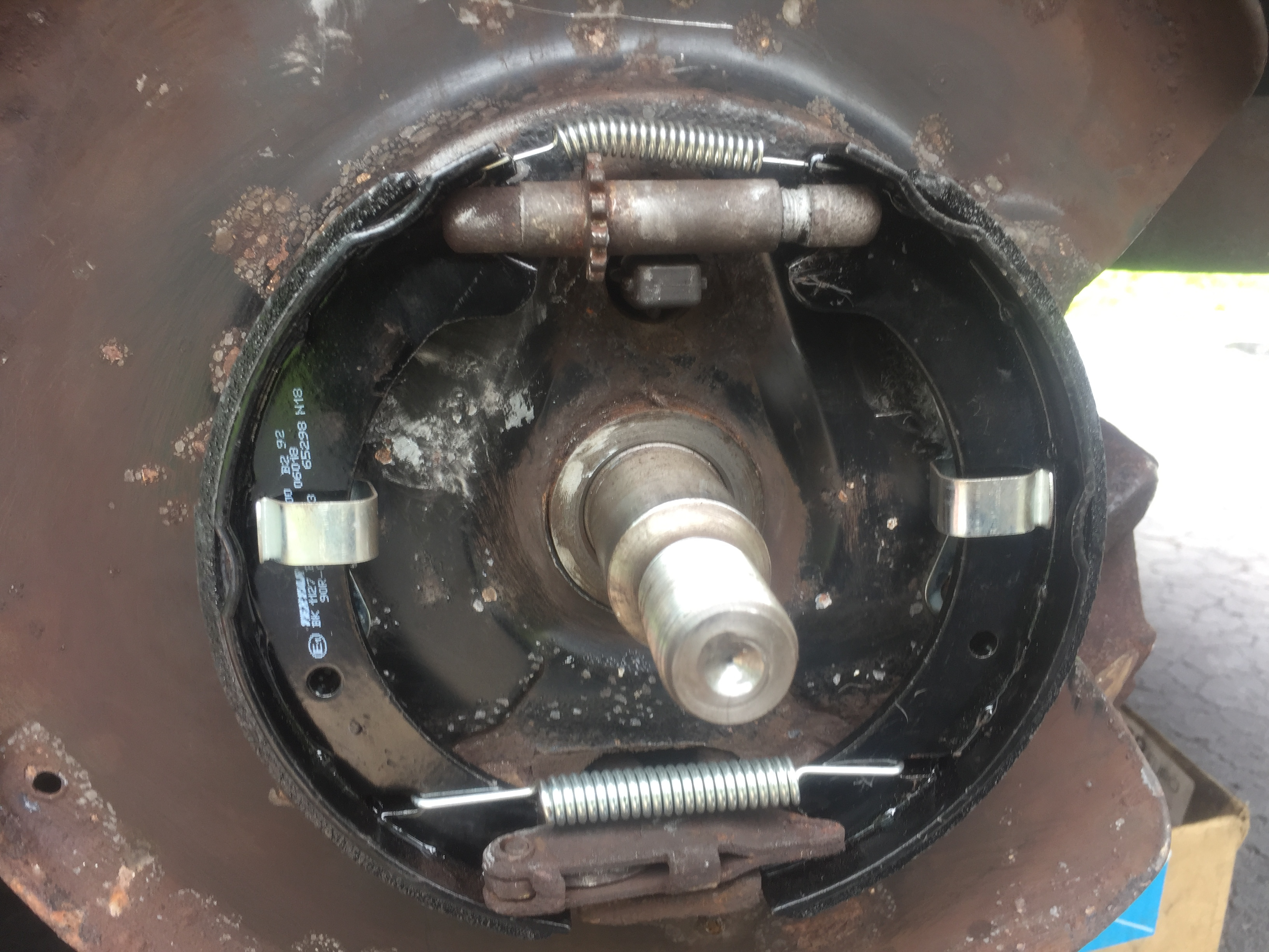

Document Parking shoe install procedure
Loosely mount shoes - do not put into brake plate clips yet.
insert and pin lower spring
Insert brake adjuster into top, insert upper spring
Insert shoes into clips
Using screwdriver as level, pry shoes into lower grooves.

Tool notes

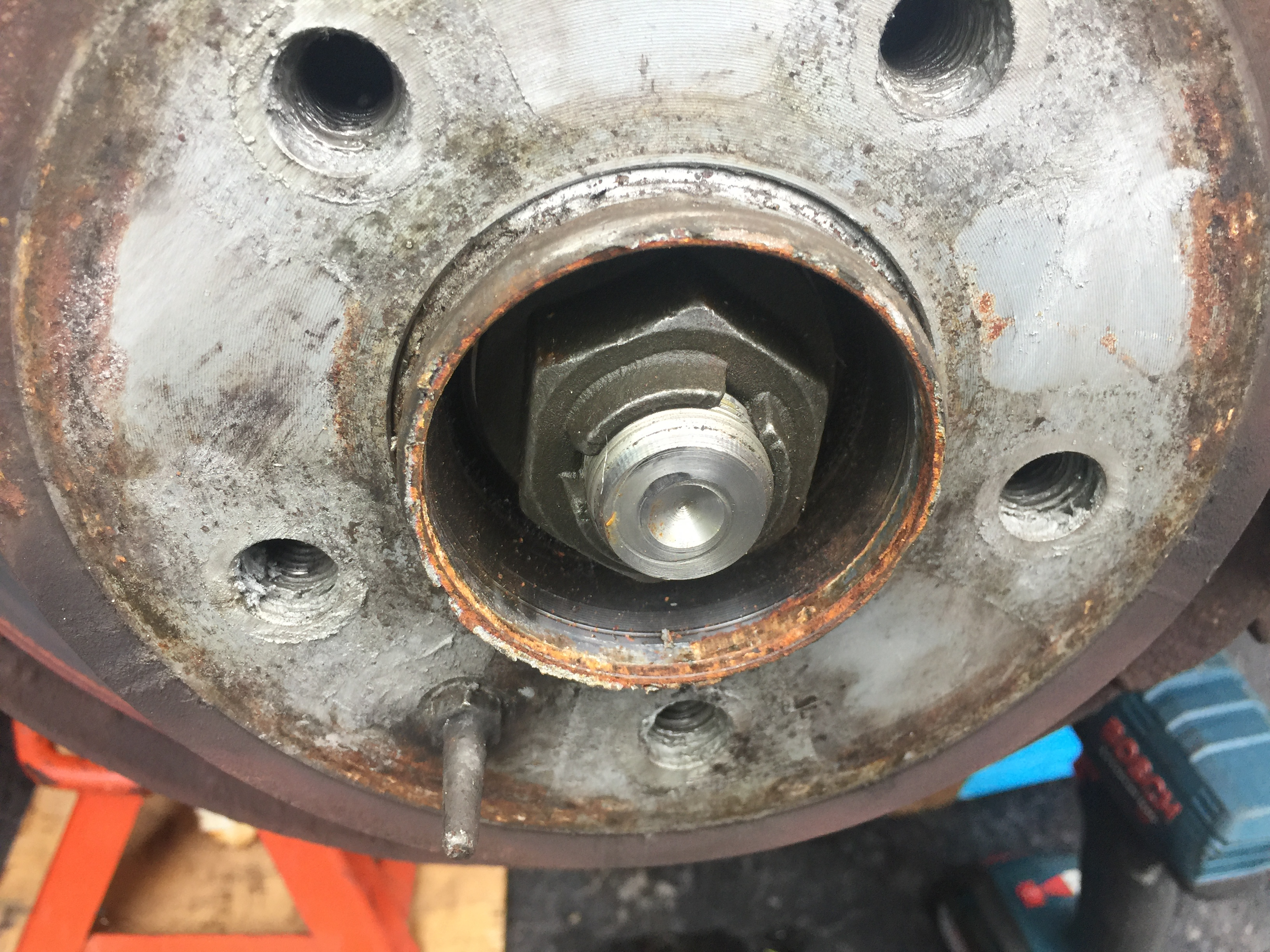

Note
Volvo calls for a new nut on the rear hub replacement
Part number 9200250, $10 part
I calculated the 120 Nm plus 30 degree torque Is well below the elastic limit, so I reused it and punchmarked it,
After 2000 miles, no motion.

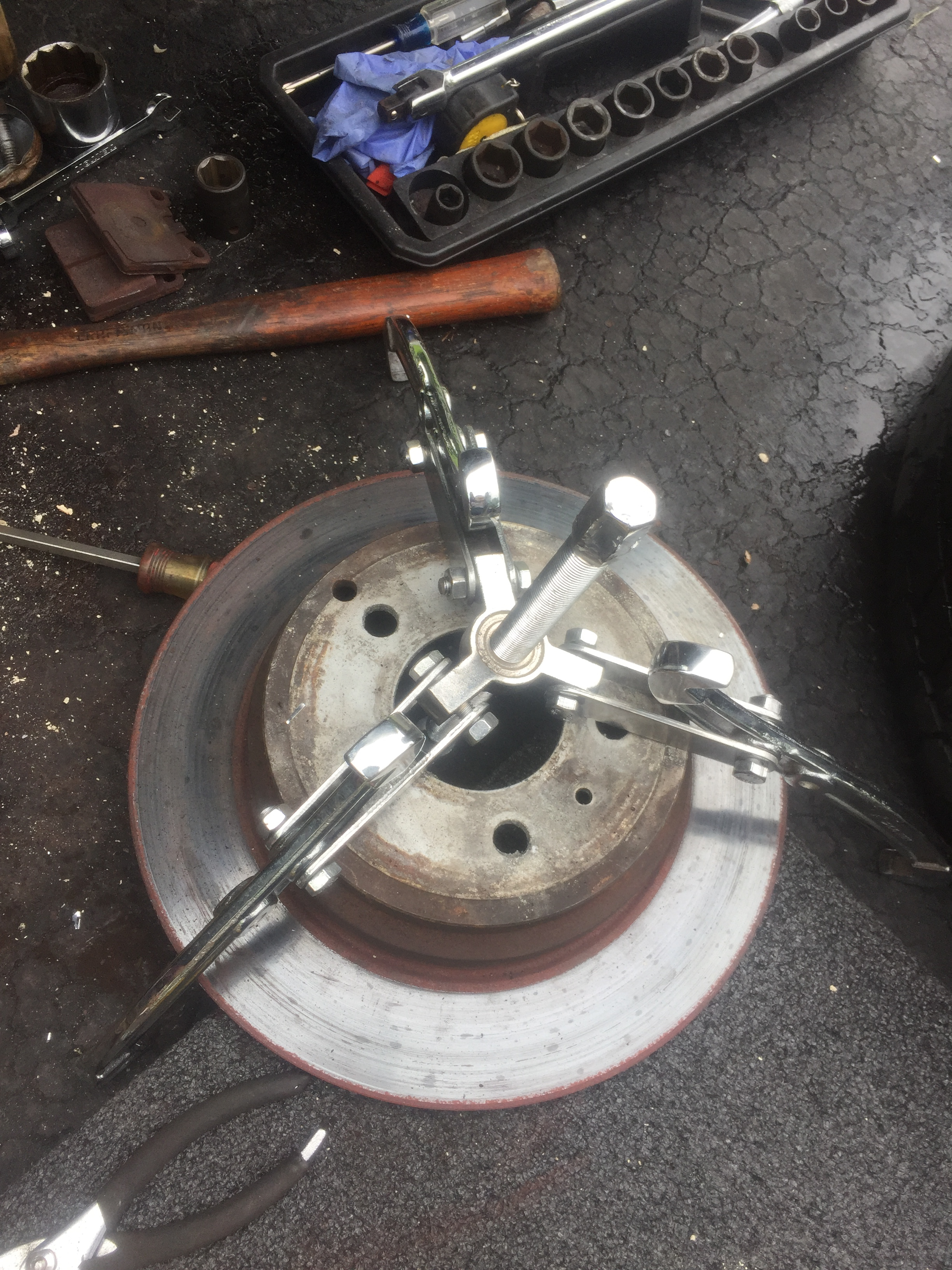

At 233xxx miles maybe Textar rearbrake shoes have worn out. Hmmm I do run them tight since it’s a stick car and the parking brake I still important, but that life sucks, 22 k miles
Had a hard time replacing the right rear rotor. Had to grind off the lip with a Dremel and was still really tight. Left one easier.
New Shoes were ATE from FCP. I’ll order new ones for stock as I have three cars that use these now
