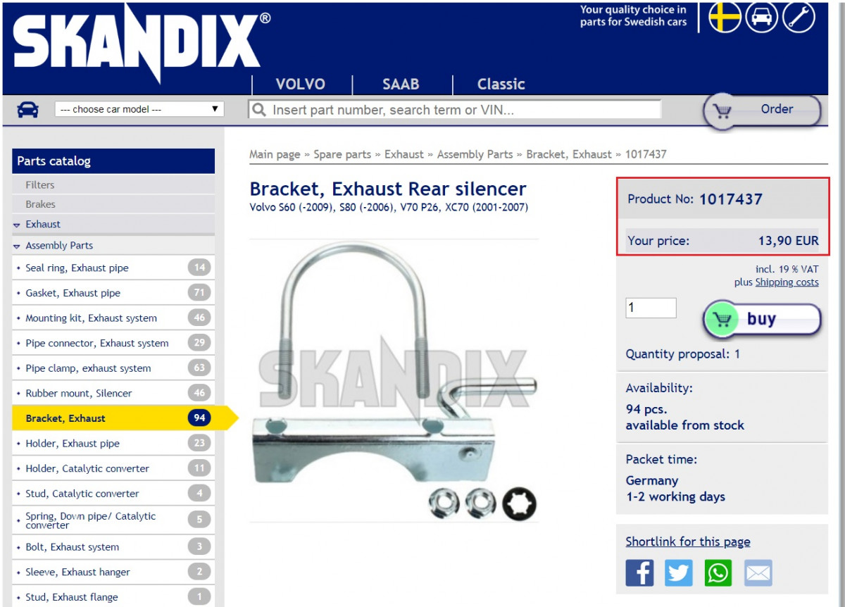

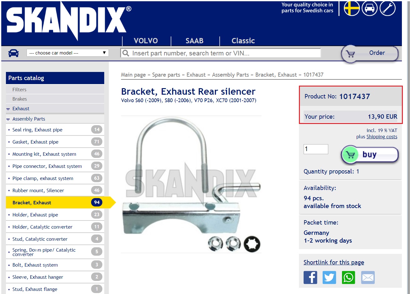

Looking at the video above, the REARMOST bracket is Skandix PN 1017437, about 14 EUROS.
Does anyone know if you can get this in the USA?
I think FCPEuro should carry this...

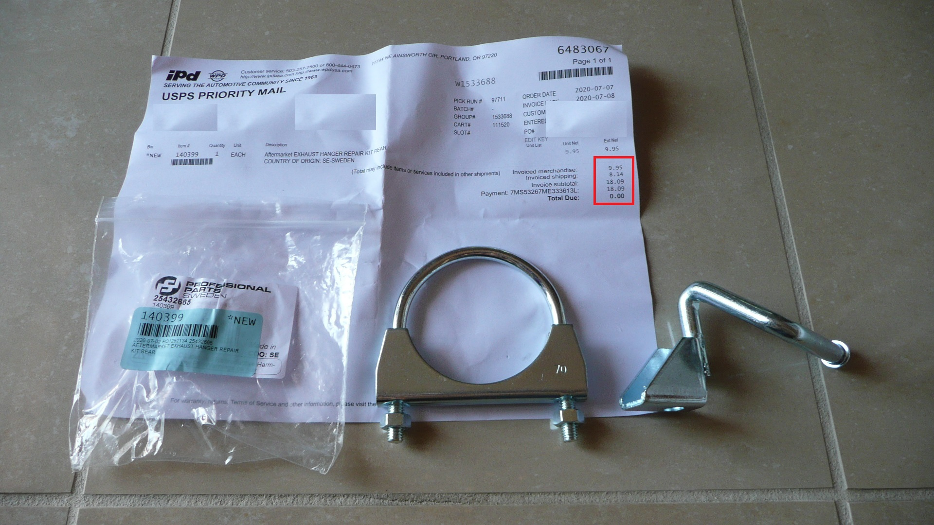

- FCPEuro currently does NOT carry this.
- However IPDUSA just got this back in stock for $9.95/each + shipping. Free shipping if your total purchase > certain $___ amount.
Since this is the only item I ordered, I pay a small shipping charge.
- Have NOT installed it on my 2004 V70 yet, but I know it fits perfectly from posts in the past by others.
- Here is a photo of the PPS...IPD website says this is made in Sweden...
Quality is excellent from what I can tell...
