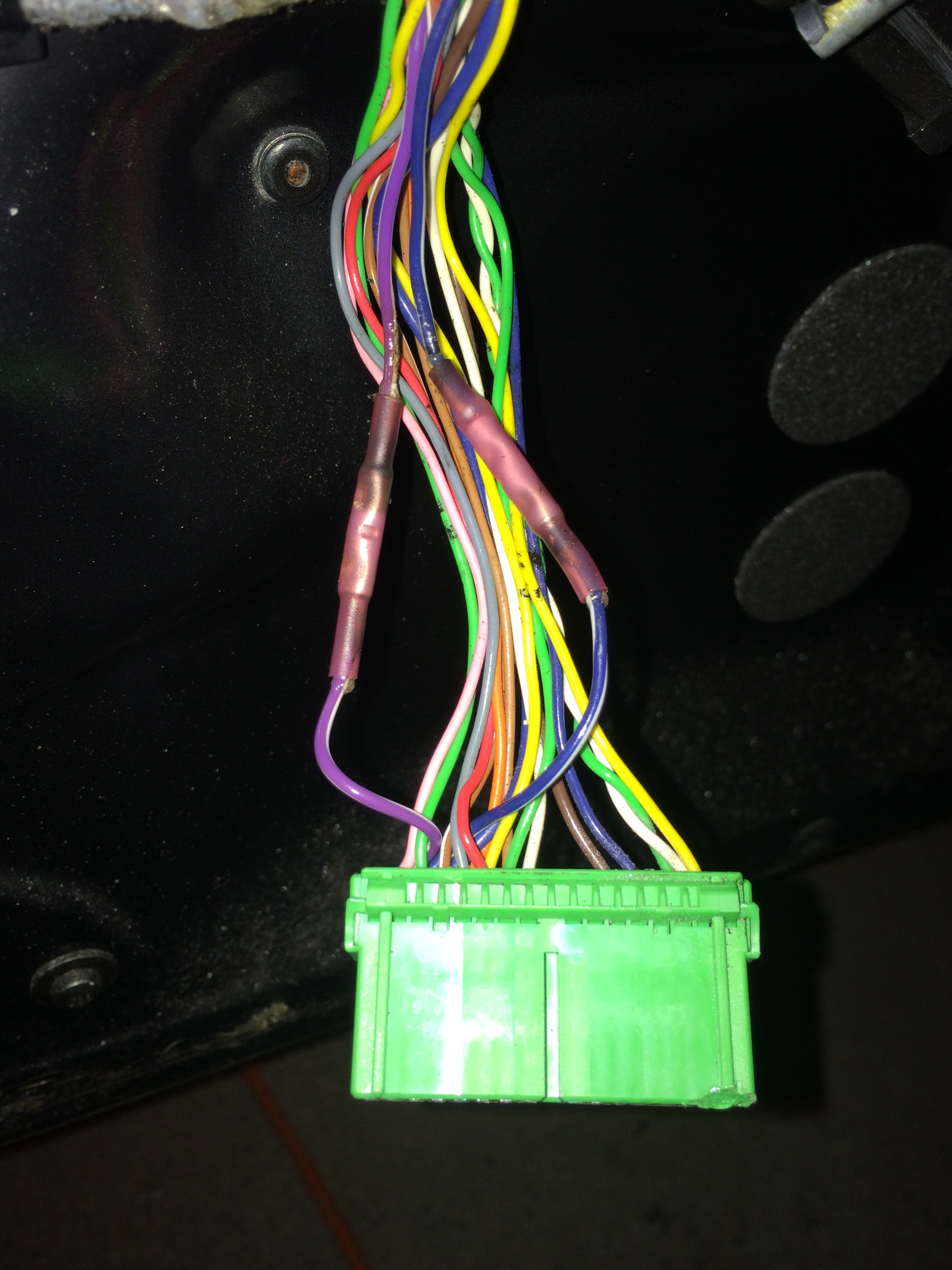

MoVolvos wrote: 06 Aug 2019, 19:16 I think you should back up a little. Remove one at a time each splice and take a look at the connection. Nothing too hard at all. Solder if you feel the wires are not bound together well.
Re-read my previous post, Mo (Aug 5, 12:57am). "I removed them, and the two wires attached to the door lock wires mentioned previously"
I'm not a fan of solder in places that see a lot of movement (maybe because I stink at soldering), so I used a crimping connector with a heat shrinking cover for water resistance.
Hoping that eliminates the phantom locking. Thanks for your concern and input.

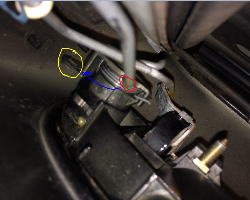

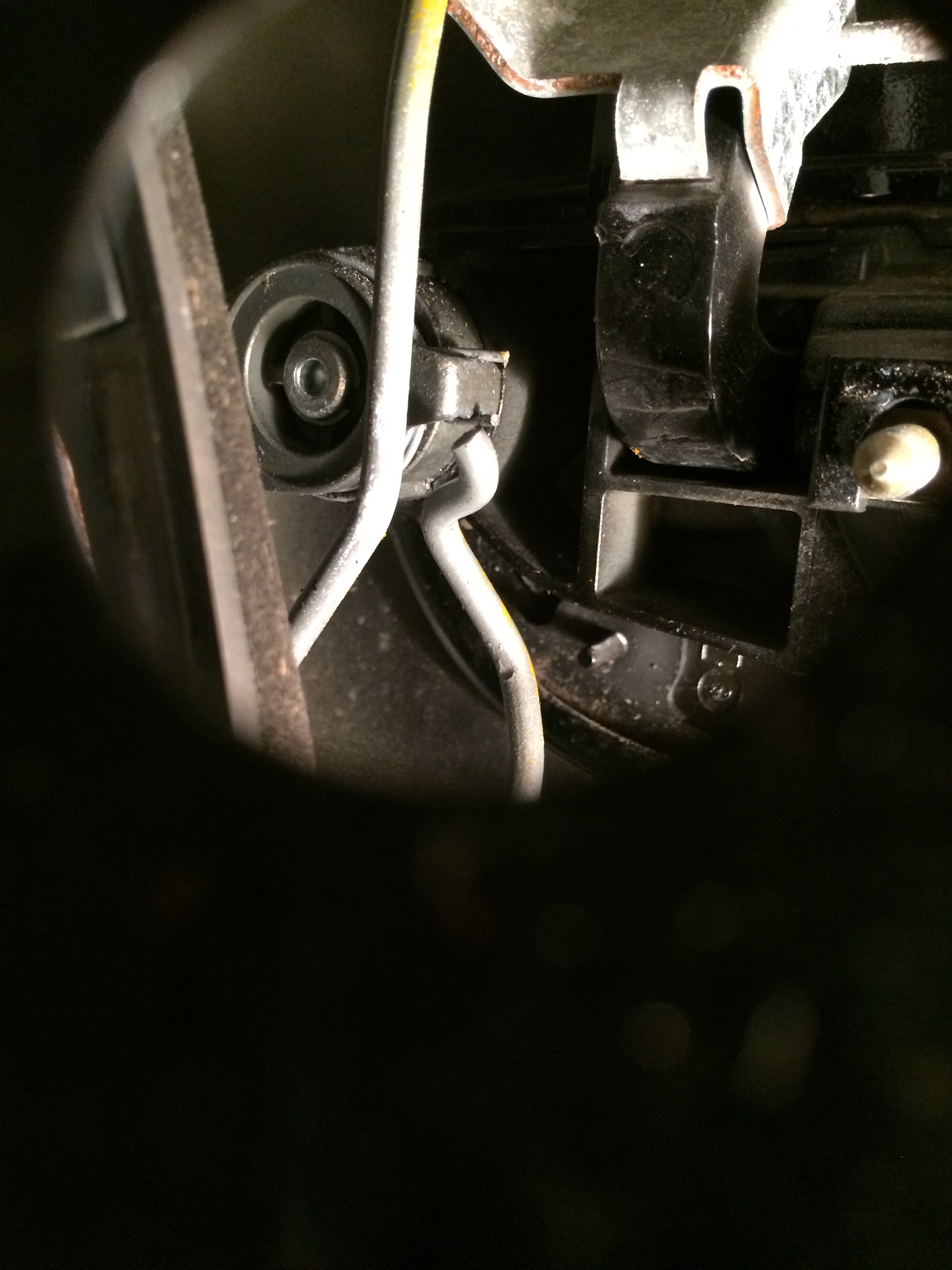

abscate wrote: 05 Aug 2019, 04:14 I thought the driver door key opens the driver door mechanically, ...
Once again, we have a winner! There is, indeed, a rod going from the lock mechanism up to the lock cylinder. Here's a view of the (disconnected) end of it, through one of the access holes in the door:
Here's a view from below-
Note the hole in the bracket circled in yellow.. Looks like the end of the rod (circled in red) should go in that hole. I'm able to do that, but it quickly falls out, as the hole is pretty large. Wondering if there should be a rubber grommet in there, or I saw mentioned in another thread something about a plastic clip that holds it in place. Can anyone confirm, or offer an alternate explanation of how to fasten the rod in place?

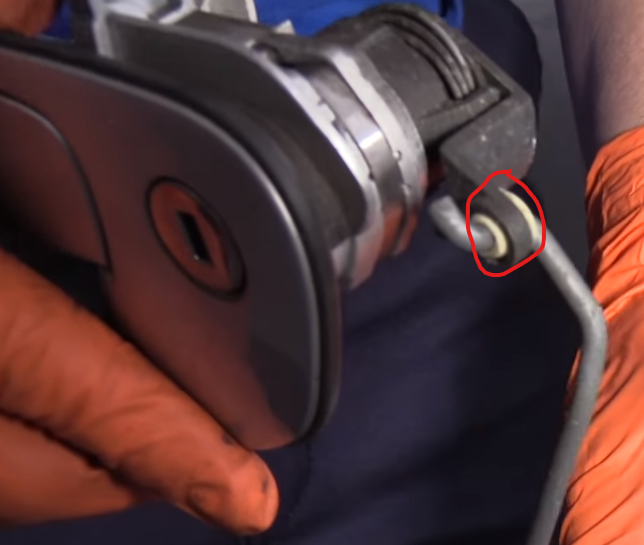

1A Auto and Sue to the rescue! Youtube video https://www.youtube.com/watch?v=YmxLDSXNW0s shows how to remove the driver side handle (on a 2002 V70), and reveals this:
There should be a grommet in that hole in the arm attached to the key lock!
I really think I'm on the home stretch here. Thanks again to MoVolvos, Abscate, & Pete. And, of course to Al Gore for creating the internet! :wink:

daughtersmechanic wrote: 08 Aug 2019, 13:34 1A Auto and Sue to the rescue! Youtube video https://www.youtube.com/watch?v=YmxLDSXNW0s shows how to remove the driver side handle (on a 2002 V70), and reveals this:
I think Al should get all the Gory for interconnecting us. By the way, I used one of the grommets in this kit and it worked for my 03 S80 T6.
