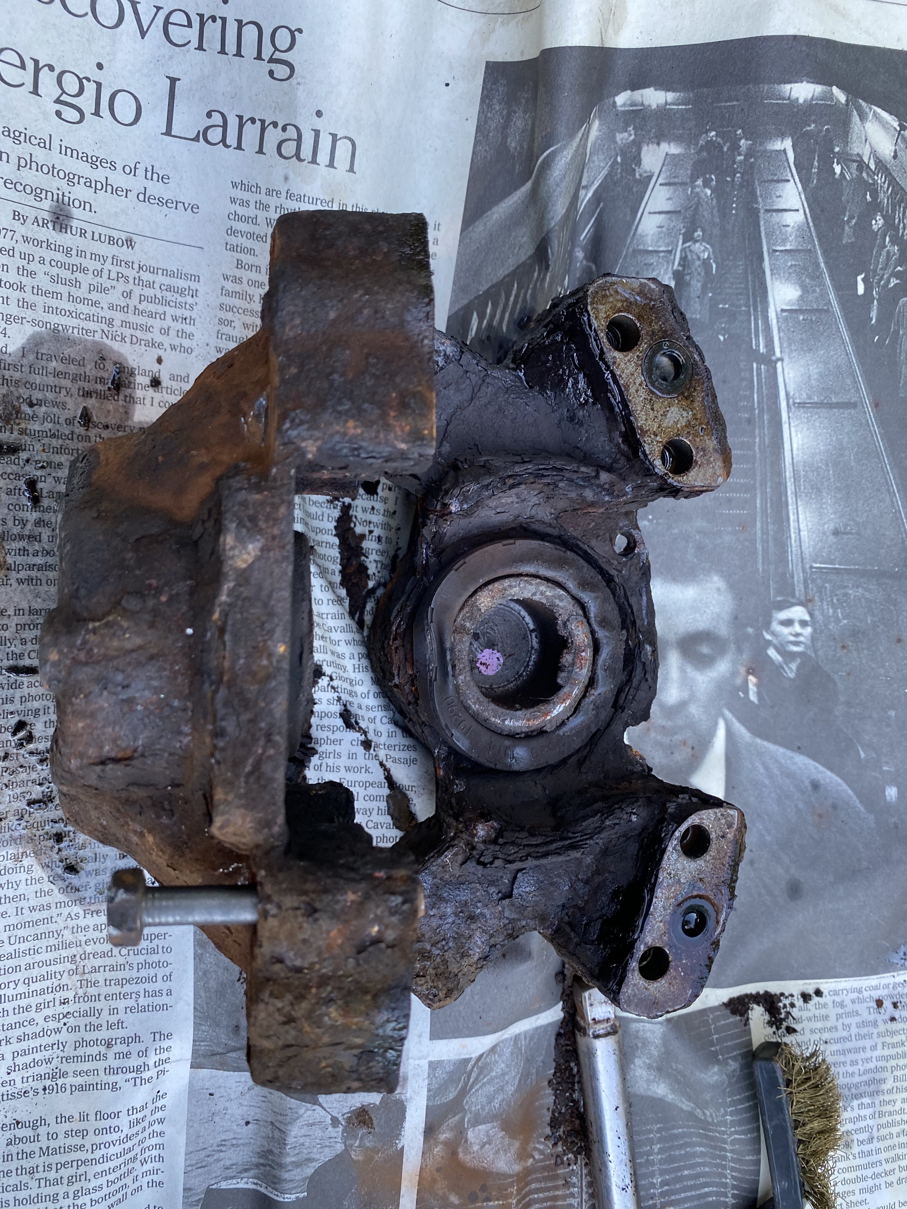

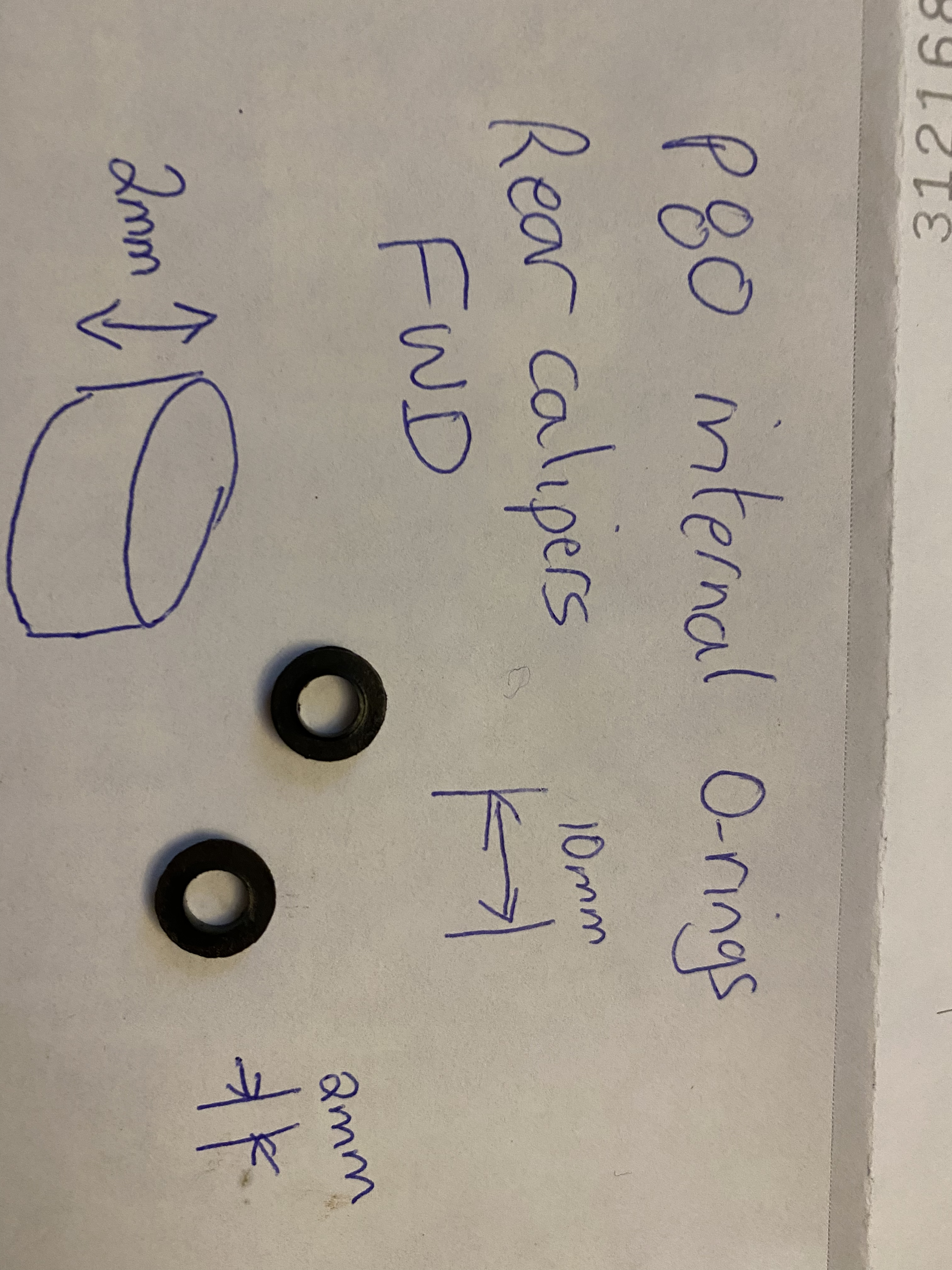

Cracked open those nasty boys and measured the internal o-ring
It’s an odd one indeed
11mm hex bolts M6 shanks. Only one other 11 mm hex head on a P80 I know of….
Rear caliper bolts are m7x45 and are avaiable at Belmetrics

Is that 10mm outer diameter and 2mm inner diameter? What is the ->| |<- 2mm?
FireFox31
Posts: 36172
Joined: 17 Feb 2013, 17:54
Has thanked: 1613 times
Been thanked: 4077 times
10 mm outer diameter
2mm thickness
2 mm height.
Its a cylindrical shape seal, not an O- ring
