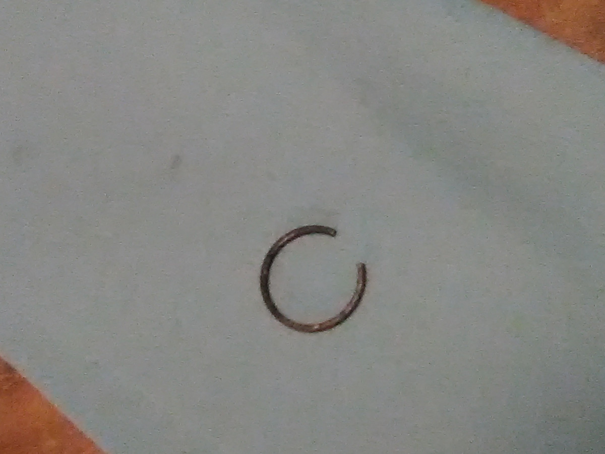

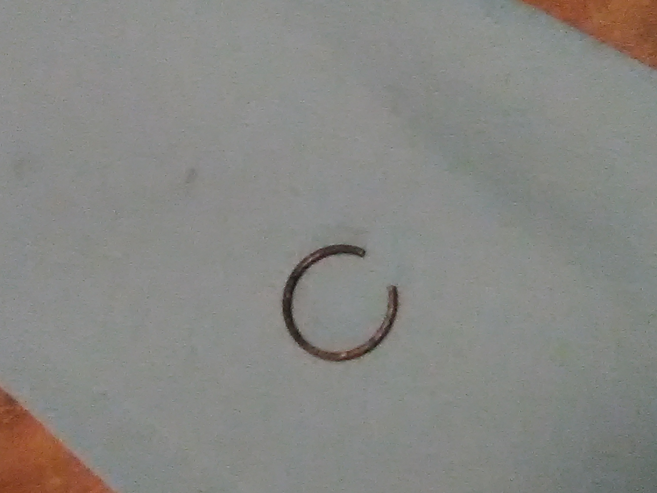

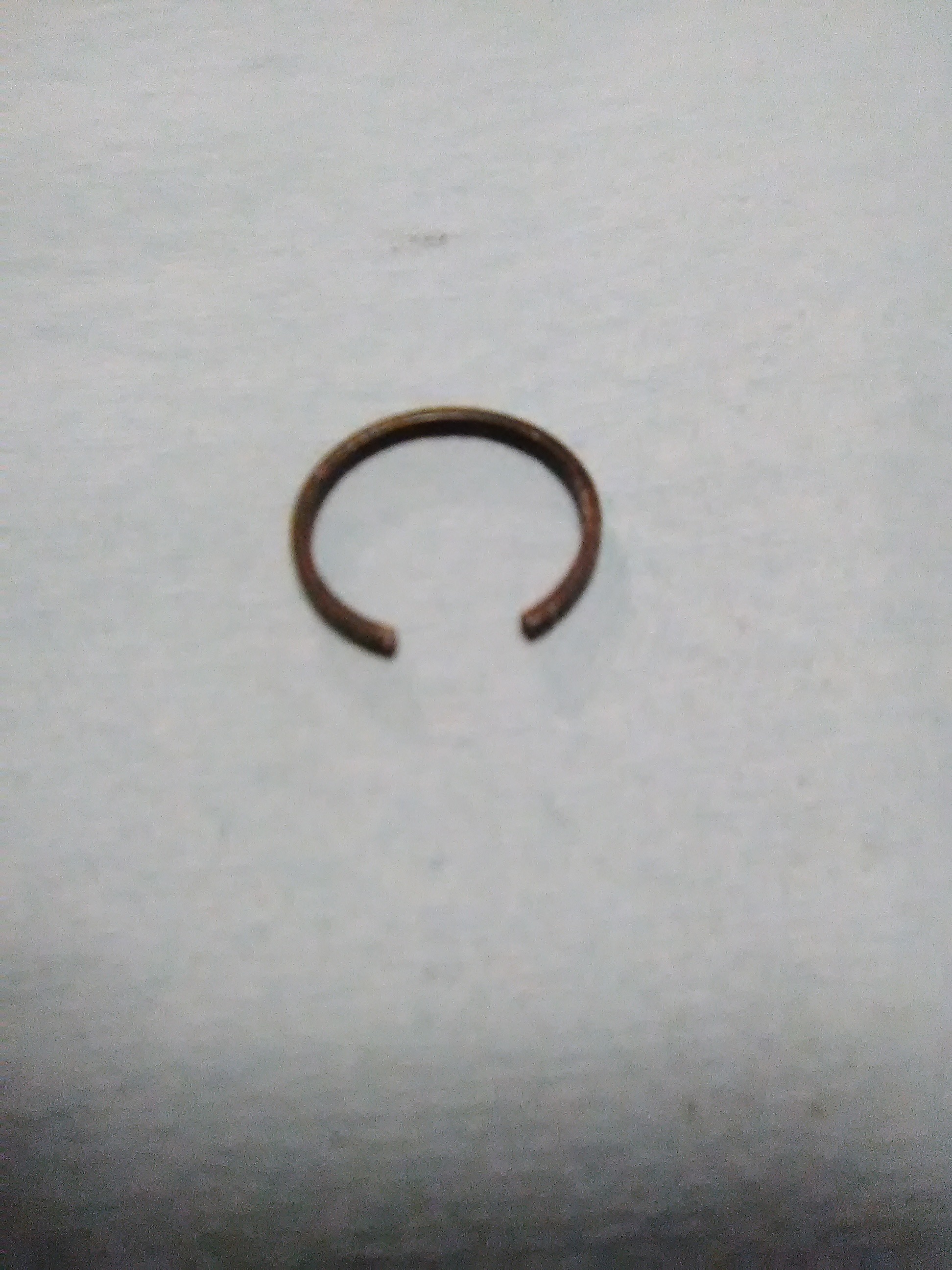

Here is a pic of the cir clip that was on the shaft. Are there parts/pieces missing? Just want to make sure I am putting right clip back in!
Thanks for your replies!

No looks ok but weird it looks rusted. I'd give it a light rub with fine paper to clean it before installing it again.
Well done on getting the axle out!
