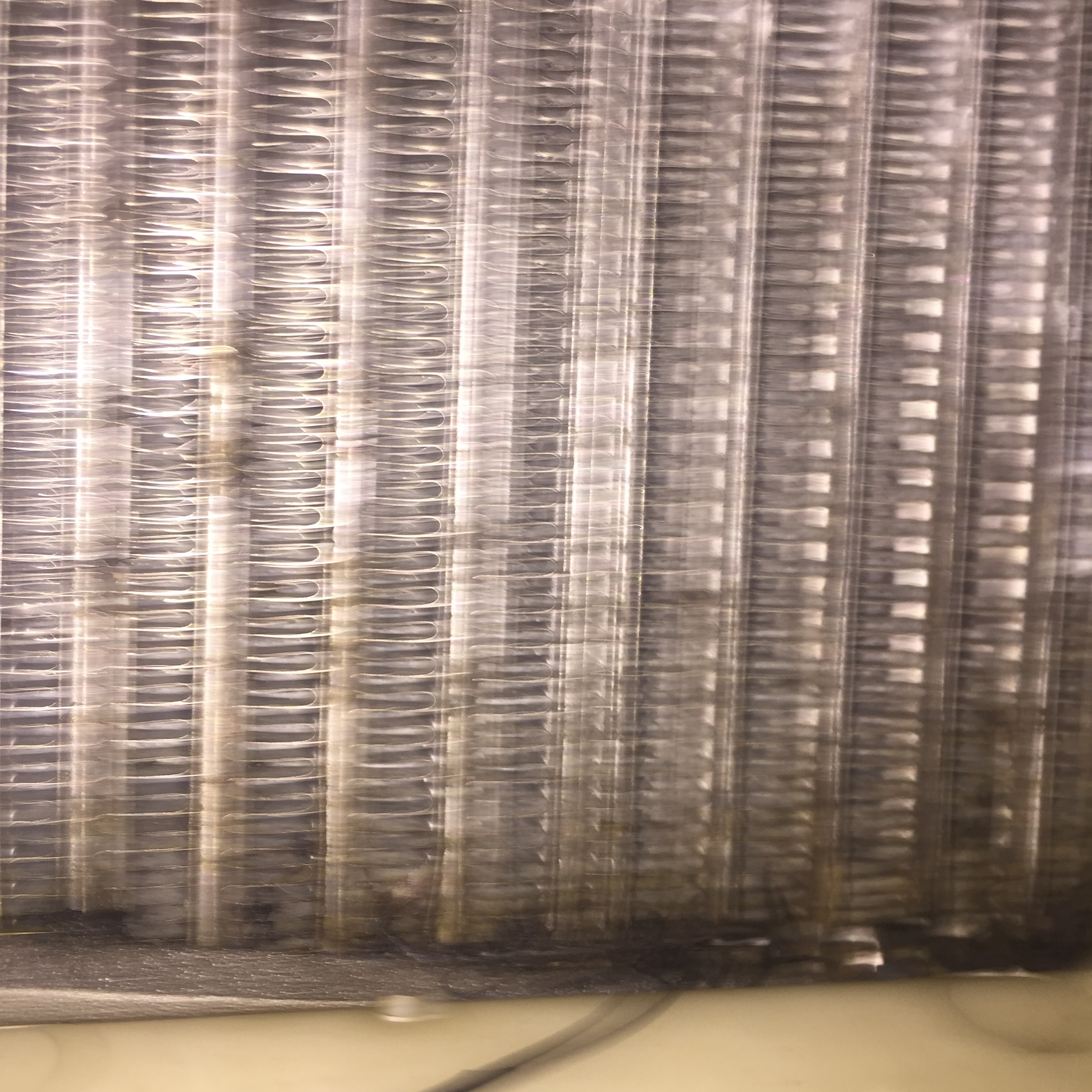

You need to replace every oring you touch in the system. The condensor can be inspected for physical damage and reused. Drier always gets replaced.
The evaporator usually look like this and need replacement

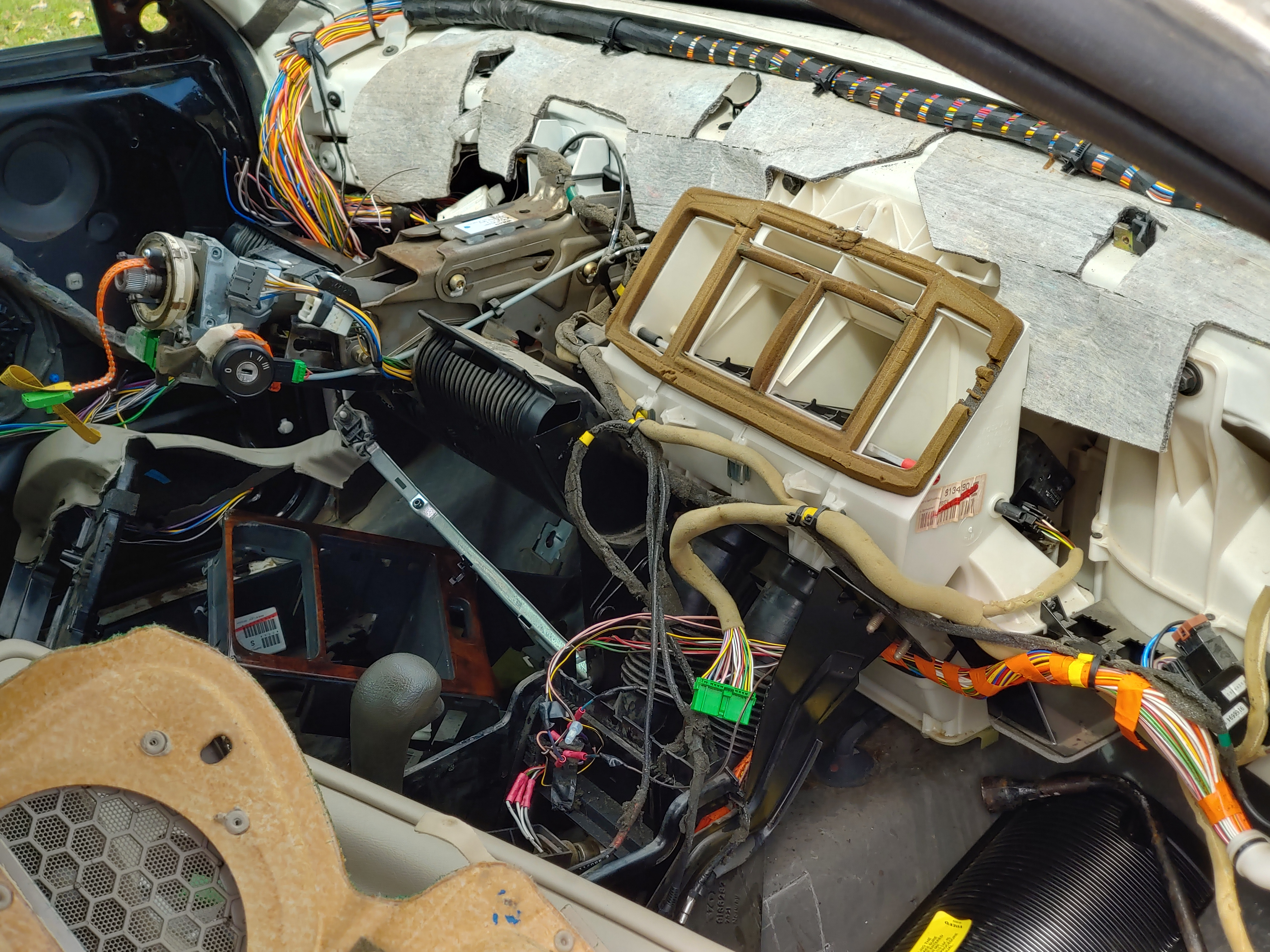

98 xc ac leak; any part replacement recommendations while cleaning engine bay?

friend ordered new evap yesterday eve. ill add drier to my cart.abscate wrote: 24 Jul 2020, 19:47 You need to replace every oring you touch in the system. The condensor can be inspected for physical damage and reused. Drier always gets replaced.

I'm assuming you are just doing maintenance with dash out. This here is my junk car soon to be trailer car. I cut out the giant wire snake that trails underneath the inside of windshield. Also 2 of the mega wiring harnesses. Lolwheelsup wrote: 12 Aug 2020, 21:44 Have fun 'bro

Keep picking at. That, there is a lot of good stuff still on that car...
Once the vultures leave, you are close

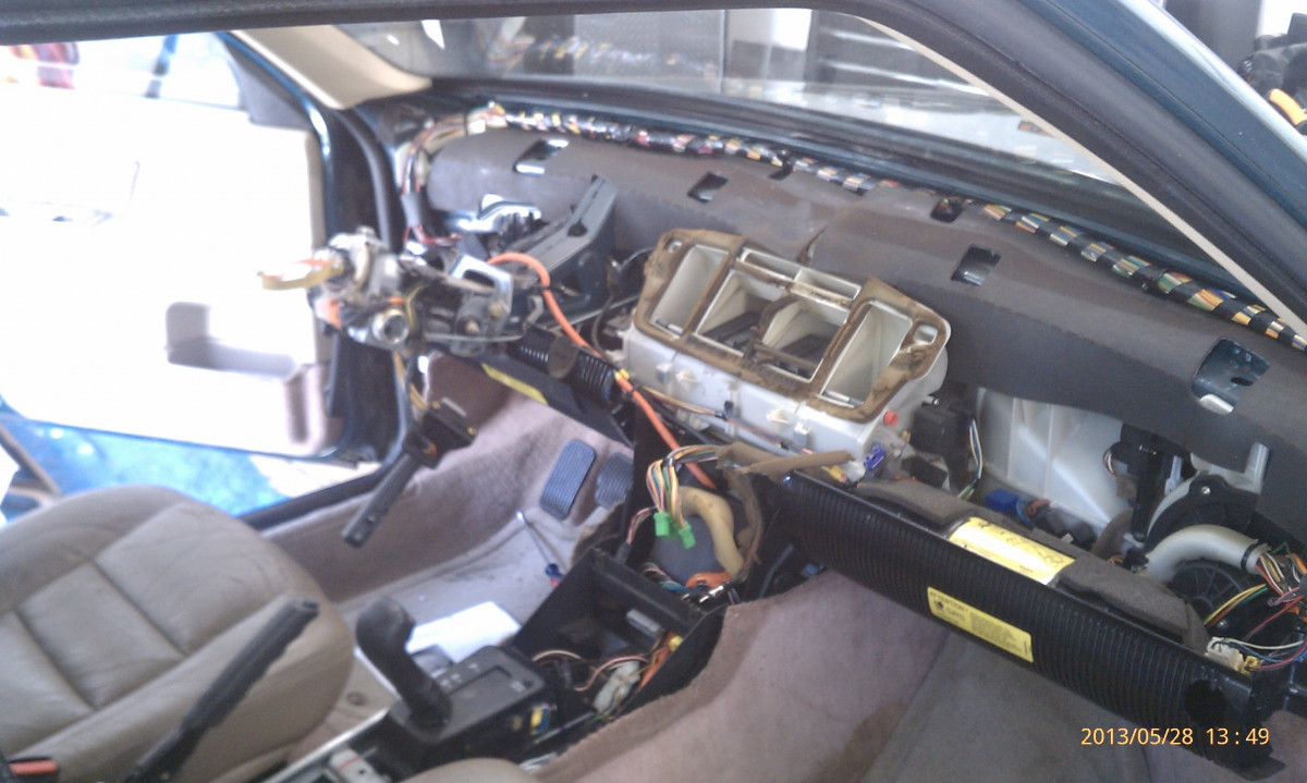

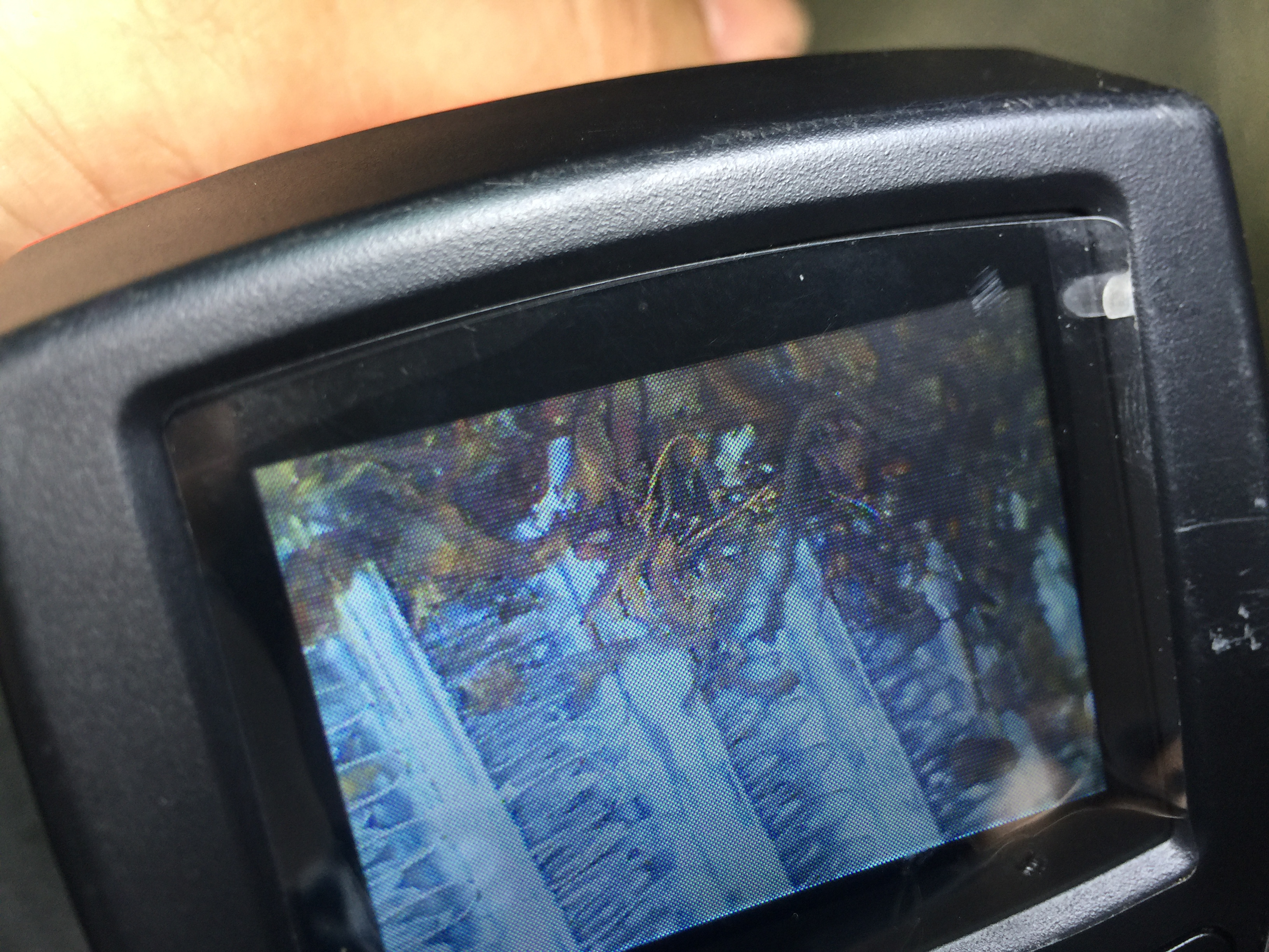

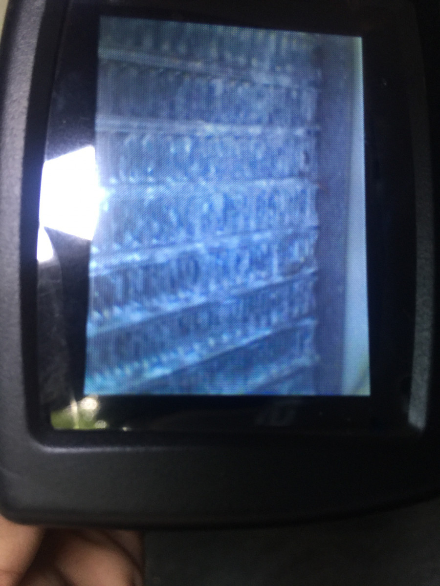

My foot vent gets bigger with every passing dayCIK7 wrote: 24 Jul 2020, 15:57hahahahhahahahahahahahahahahaha! rare passenger foot vent XD just stick it down there wont have to worry about a foot vent no more XD jkjk thank you for the info.abscate wrote: 24 Jul 2020, 14:30 Sorry , I don’t know why I wrote that you cam borescope the evap from the air filter. That’s not right.
Here’s how.
Remove glove box liner and lower passenger kick plate.
Remove power transistor
