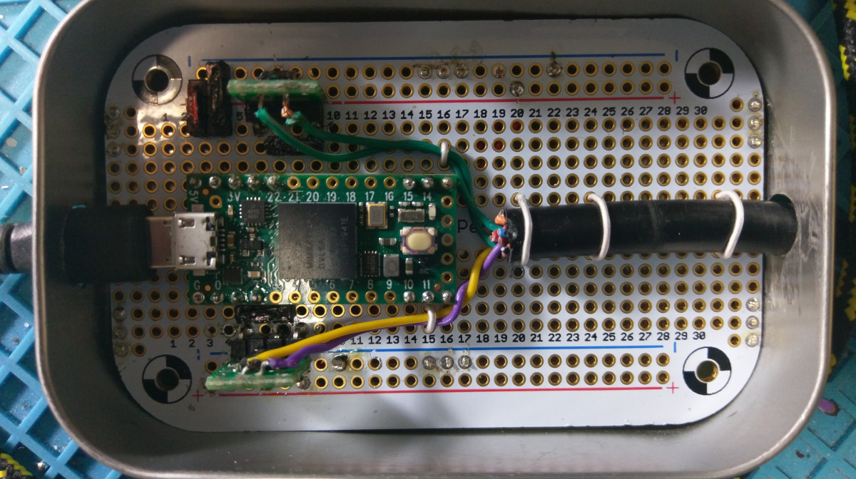

RHP PT V2.1 Its cracking.
Did way with the Buck Converter. Tennesy 4.0 100mA, Bosch CF160 80mA. 100 mA + 2 x 80mA = 260mA. Not going to over load any USB port. No terminating resistors. Just the Tennsy 4.0 and two Bosch CF160 CAN transceivers.

RickHaleParker wrote: 02 Aug 2021, 01:16 260mA. Not going to over load any USB port
Easily: a 5-port hub connected to already subpar laptop port that drops voltage even before the load reaches 0.5A ;)
Congrats on your successful crack.
RickHaleParker
Posts: 7205
Joined: 25 May 2015, 14:30
Location: Kansas
Has thanked: 8 times
Been thanked: 980 times
Post by RickHaleParker »
vtl wrote: 02 Aug 2021, 10:14 Easily: a 5-port hub connected to already subpar laptop port that drops voltage even before the load reaches 0.5A ;)
They do make USB hubs that draw power from a external source.

5ft24
Posts: 203
Joined: 14 Apr 2013, 12:27
Year and Model: 2005 XC90 V8 AWD
Location: Sedro Woolley, Washington
Has thanked: 20 times
Been thanked: 12 times
Post by 5ft24 »
But who wants to pull an extension cord to the car to plug it in...
RickHaleParker
Posts: 7205
Location: Kansas
5ft24 wrote: 02 Aug 2021, 14:03 But who wants to pull an extension cord to the car to plug it in...
The one I have runs off 5V and has a USB port for power input. Use a high current 12 - 5V USB adapter.
Google "Powered USB Hub" and take a look.
