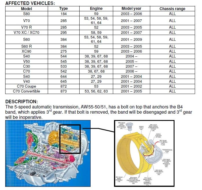

Another very important thing alluded to here in this thread, the BOLT THAT SHOULD NEVER BE REMOVED!!!
Note everyone- if you remove this, thinking this is the fill hole, you've bought yourself a new transmission or you're parking your Volvo. Volvo has gone out of their way to try to warn owners:
