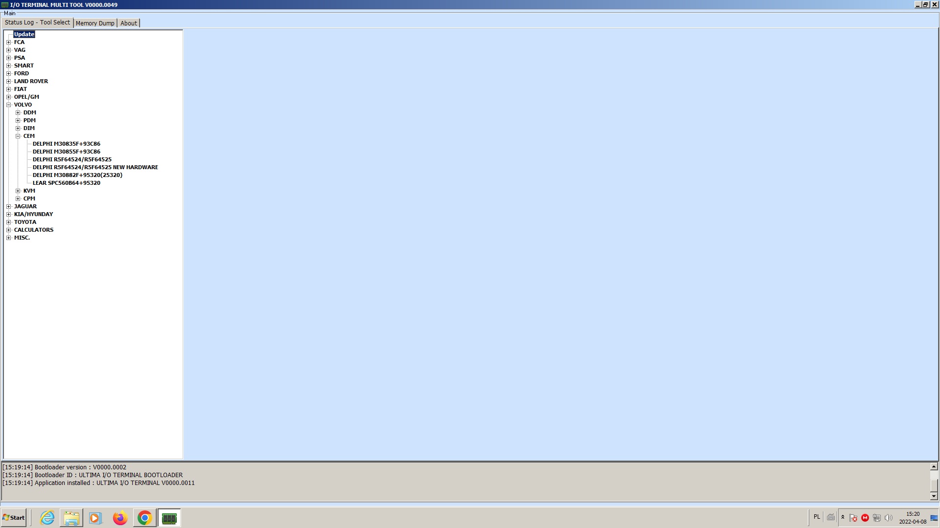

What are you using to flash the CEM ?

IO Terminal works fine. R/W without any problem, but, first you need to read CEM PIN.
IO supports CEM P2 with M32 and P3 with R32 proccessor.

IO cannot get the PIN for the P2 CEM with the MC68376 ? We struck out. Vdash strikes out IO strikes out.

IO cannot get the PIN for the P2 CEM with the MC68386 ? We struck out. Vdash strikes out IO strikes out.

IO cannot get the PIN from MC68376, unfortunately.RickHaleParker wrote: 08 Apr 2022, 05:12IO cannot get the PIN for the P2 CEM with the MC68376 ? We struck out. Vdash strikes out IO strikes out.
But for P2 facelift working like charm!

What do you mean exactly? Does I/O Terminal crack pin code now? Or it knows where to look for the pin in the flash dump?urosm wrote: 09 Apr 2022, 01:23 IO cannot get the PIN from MC68376, unfortunately.
