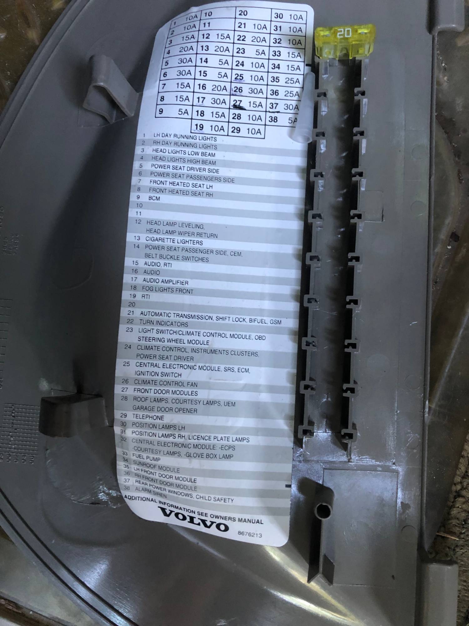

One more question, how can I pull power to the fuel pump to get it to crank without spraying fuel everywhere? I'm kind of embarrassed to ask but it's not immediately obvious.

Yes which one is it? It's not clearly marked

On the XC70 last time I just unplugged all 5 injectors. However, I think they wouldn't fire again until I reset the codes.

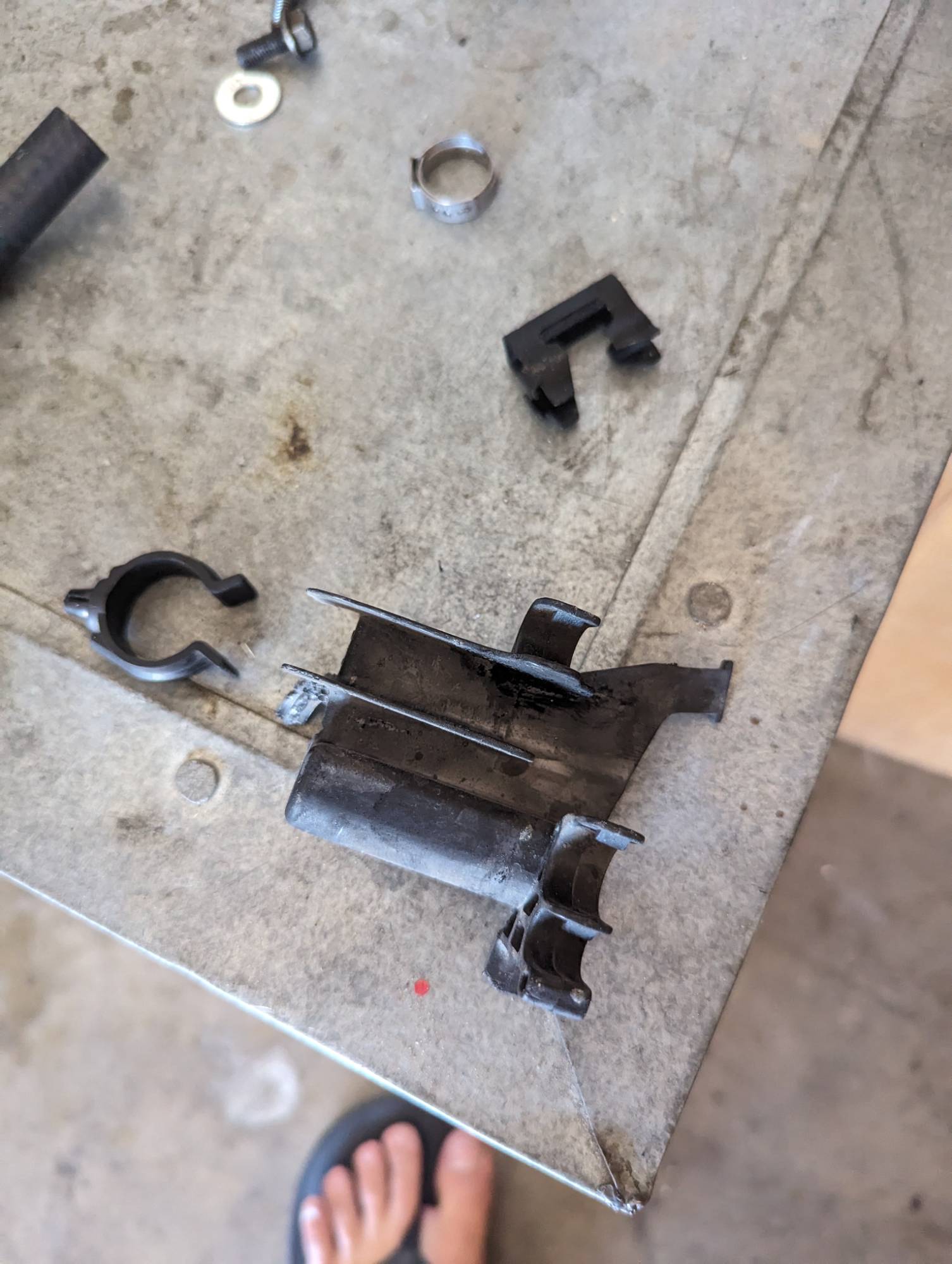

Does anyone know what these parts are? Leftovers from the job... I think the plastic hose routing thing goes near the pct or somewhere near that gaggle of hoses but I can't remember
