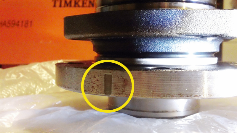

I will install one at each front wheel. Looked closure at its character and compared the two, there are plenty of rust speckles and burn marks all over it. But one shows a visible shaved surface, see below. Would it throw-off anything since this topic is about "early failure".

The visible "shave" you refer to showed up on some genuine Volvo brake rotors I installed. I questioned the parts supplier about it and was told it is a balanced part and the shave is done to balance rotational weight (kind of like putting wheel weights on to balance a wheel). I was somewhat skeptical as I had never encountered same with any brand of aftermarket rotors I have used, but I did not notice any wobble attributable to an out-of-balance condition so I assume it is fine.
