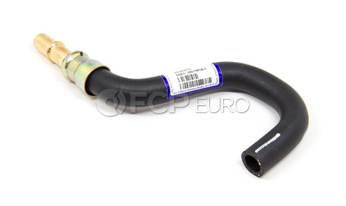

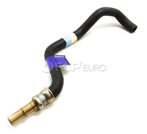

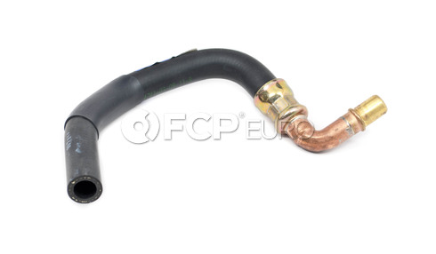

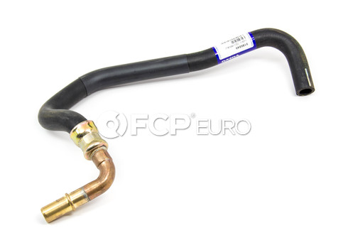

98 S70 N/A heater hoses:
98 S70 T5 heater hoses:
The distance looks a little similar, no?

Distance look similar... main difference is the hard line. Honestly you might be able to fit the turbo lines on an N/A, but you might have tighter bends in the hose, which could kink it and restrict coolant flow.
