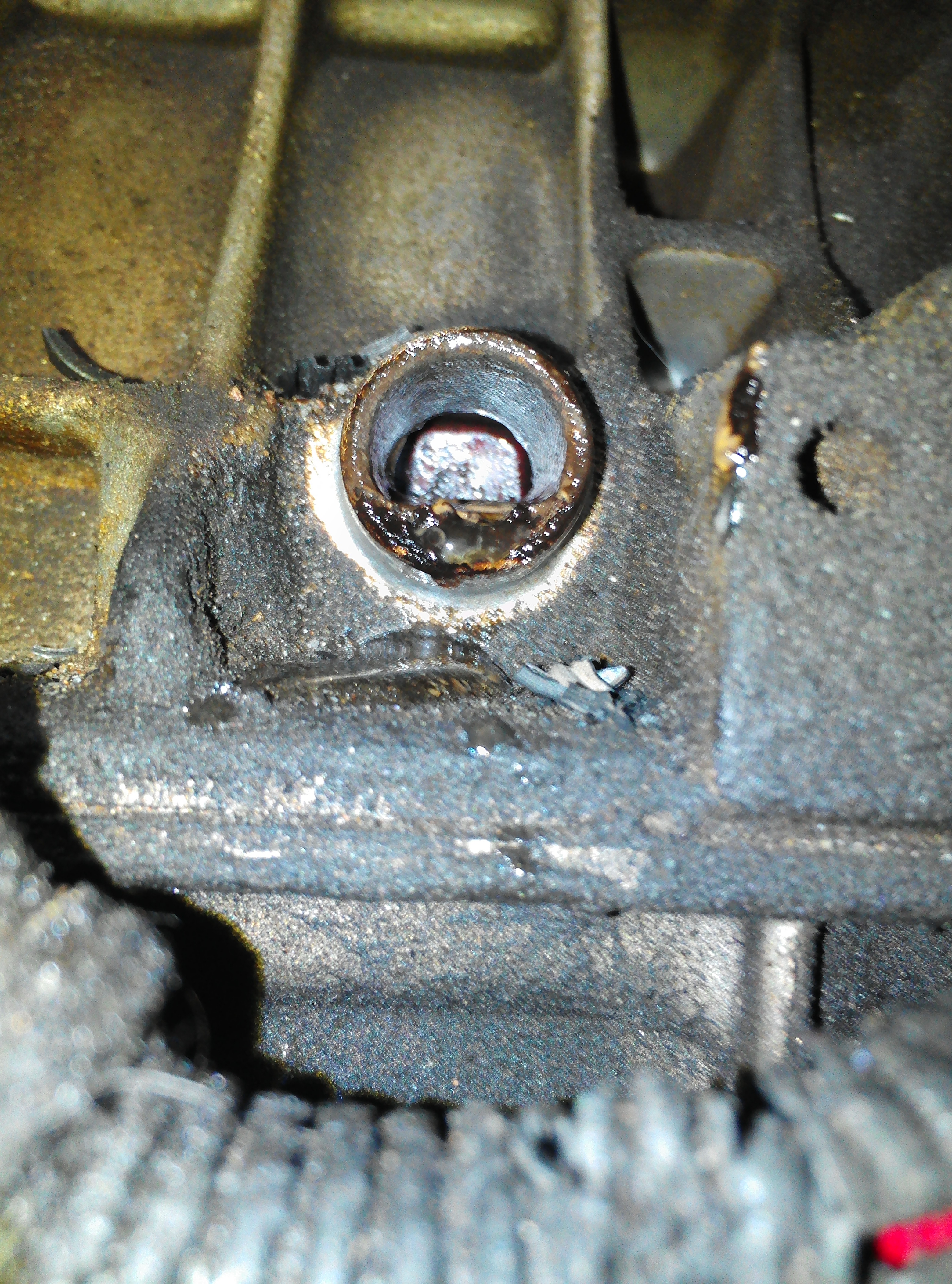

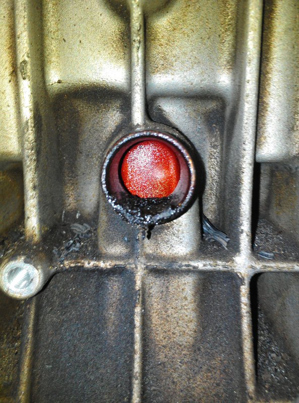

Here's a couple of photos of the top and bottom oil holes in the block as they were. I will do the tube blow check as you said although if it was blocked I would have expected the hole to be blocked and oil and crud to have run out in quantity when I removed the oil catch tank. Surely oil would have been collecting.......

That's not too bad. Get the hose on it, I bet it's open.
Run synthetic and that will clean up nicely.

Those ports into your engine block really aren't all that bad. Both of my cars were a bit more blocked right at the port lip, especially the lower one at about 50%. But once I pulled out the main "clob" I was able to blow air quite freely into each of them and out the oil filler on top of the engine.
