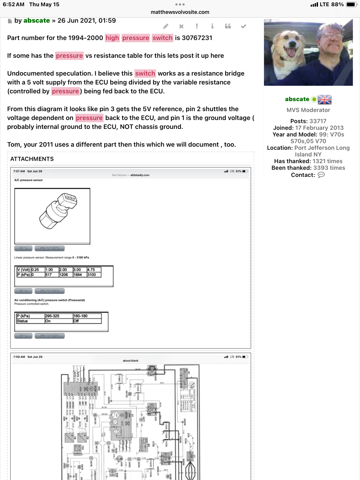

High pressure switch electrical data here
