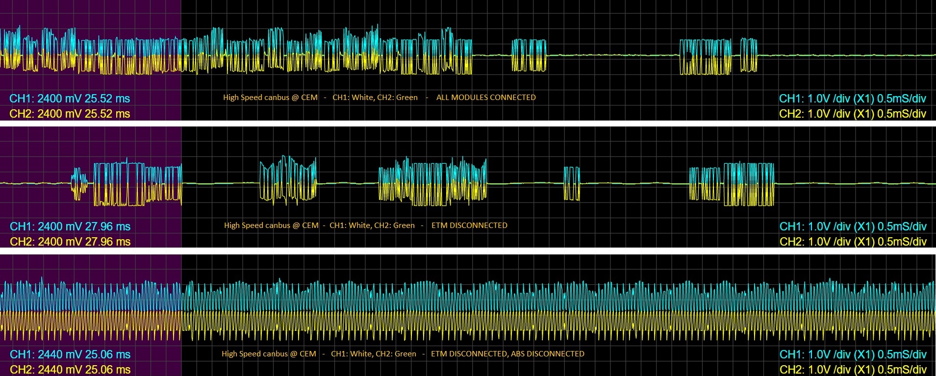

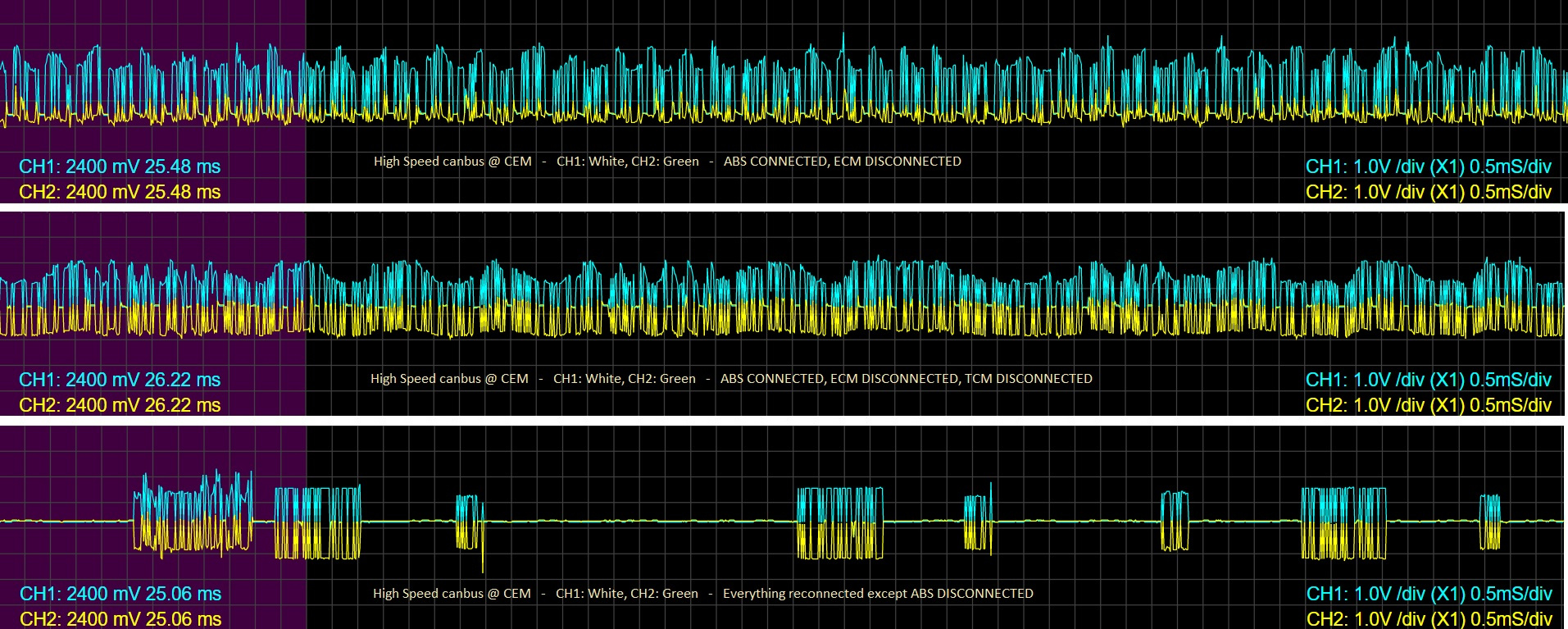

Ok, I hooked my scope up to the high speed bus at the CEM and here are the results:
This was all with the key on II.
I turned the key off between plugging/unplugging, then turned the key back to II, and took a screenshot. Figured out how to use this scope a bit better and captured a longer time sample.
Nothing really jumped out at me as a smoking gun... what do you think?

The 3rd waveform with the ETM & ABS disconnected is the only one that the ground reference isn't pulled out of whack, but the waveform is junk
