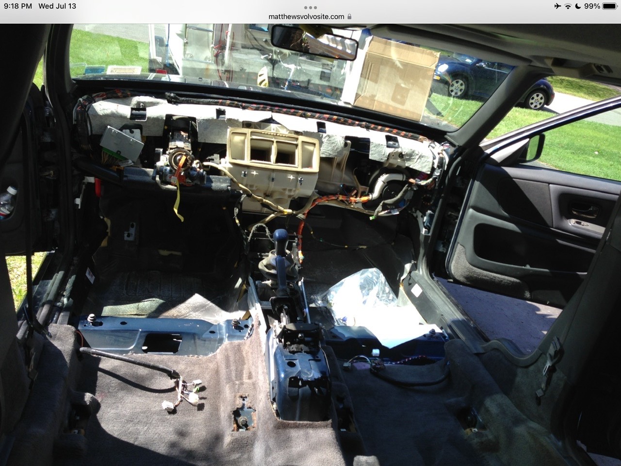

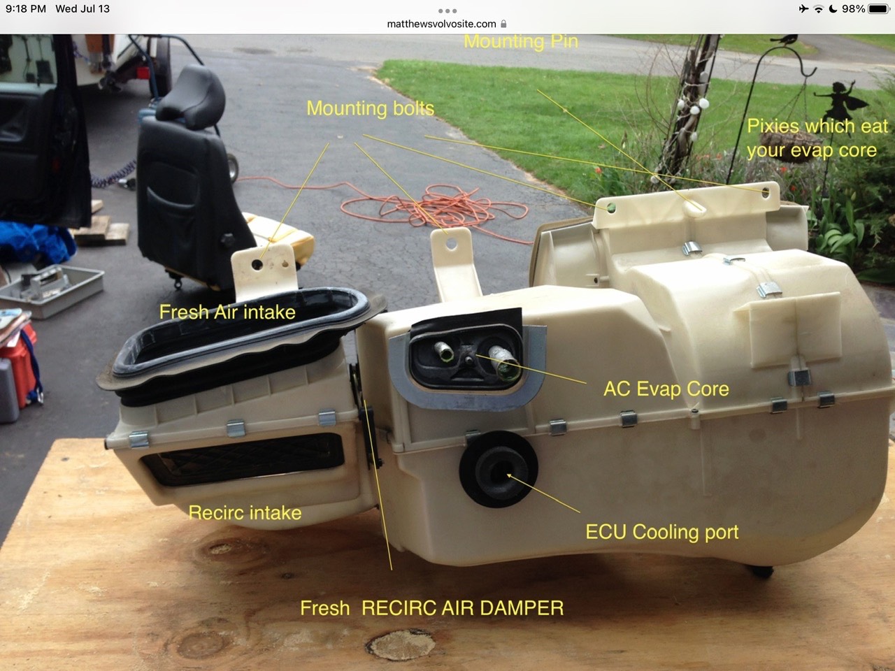

Pictures here..
viewtopic.php?t=56005&hilit=1999+v70+t5&start=30
The white plastic thing gets pulled out of the car, with or without the heater core, then you remove the shiny metal clips to expose the evaporator core
- Posts: 15487
- Has thanked: 2199 times
I am clearly wrong on this. You will have to remove the whole air box as I had forgotten about those clips on the rear against the firewall.
Heater core will have to come out.

Man. Those clips make this a complete disassembly project.
- Posts: 36147
If tailless monkey me can do it, anyone can. It’s much more daunting on paper than when you get to it.
