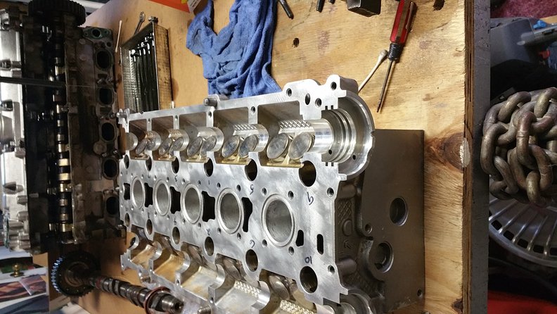

99 S70 n/a Jumped timing belt, now replacing head

Bummer. The front seals won't work with a standard camshaft and I think the oil passages got shifted around so even if you have the CVVT hub I still don't think it would work properly on your block. A phone call is certainly in order.

Head gasket will have crushed and mated with the unique texture of the first head.
I would replace it. Why the head bolt refund? They can be re-used.
