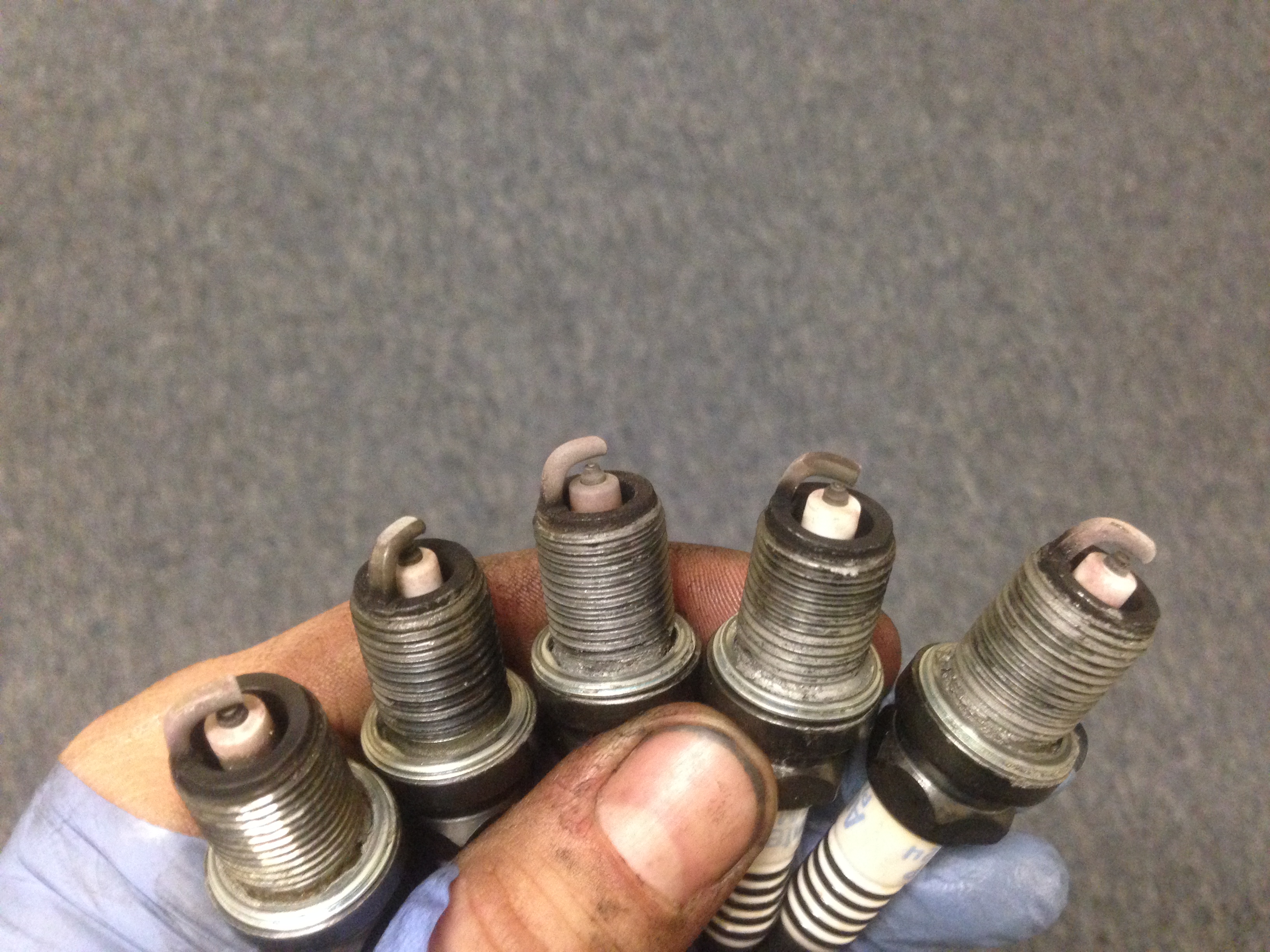

All right, I got my spark plugs out today (left to right 1-5). Compared to the pictures they seem ok. What are the pros thinking?
The middle one ist the dirties one of all. I also could see that some oil entered the channel which might be the reason for the plugs. I dont know about the manufacturer of the plugs. Its called AutoLite Platinum (AP3924) Are they any good or should I switch out for better ones?

Spark plugs looks ok but i would replace them anyway since they are not Oem Volvo and as part of regular maintenance.Just for a piece of mind.You will not go wrong since they will last for another 100k.
Also,i would check cap & rotor.Be carefull with bolts which holds the rotor.They can easilly be stripped.

They look a bit lean running to me but I'm used to air cooled VW which are always uglier than my water cooled cars. Clean and gap fir now and sort out your hoses...which will cause lean running....
