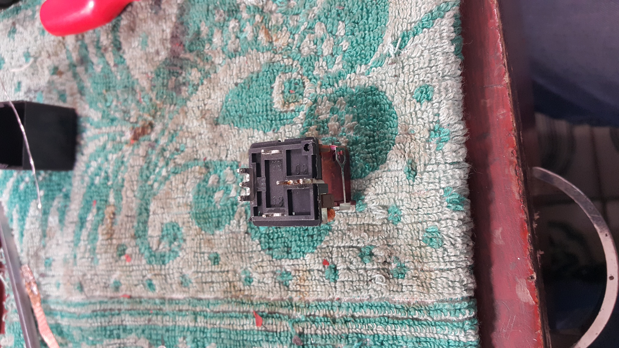

Bad guy. Seems to have mechanical issue. Just stuck in open position. After disassembling started working but anyway replaced.
Pins cut
Pins cut
Bad guy replaced and the top is a bit treated with varnish

Nice job there, anything in particular I should think about when/if I do it?
Do you got the pin layout for the relay? I suspect that the relay I got for replacement might be in wrong pinout order.

30 & 85 should be control pins
86 & 87 main pins.
You can check by applying 12v to 30 & 85.

Then I gotta change it for another. Wrote down the part-no that oyu had so gonna go and buy some of those later today.
