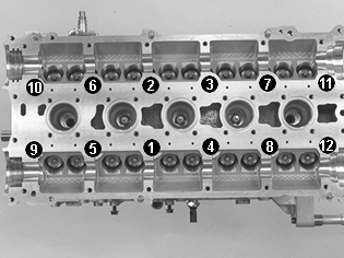

I've spent a little time looking around but haven't been able to find the sequence / torque specs on the head bolts,,,, for that matter the cam cover bolts too.
Cylinder head
Tighten the screws in sequence from the center and outwards.
Stage 1........20 Nm
Stage 2........60 Nm
Stage 3........130°
