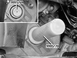

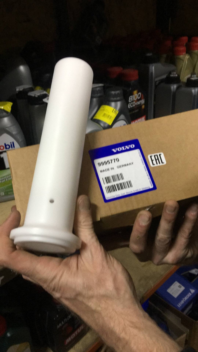

Per Volvo dealer, when installing RH axle seal, their techs use...9995769 and 9995770 tools.
Not sure what 9995769 is (it might be a faked axle shaft so the drift can slide into it, just a guess), but 9995770 is definitely the seal drift tool.
I will make my own tool and report back later...

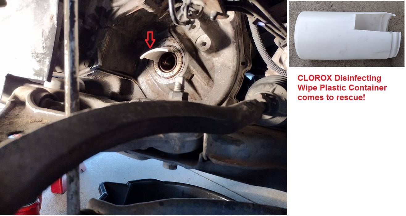

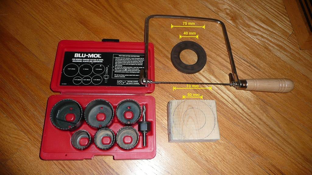

I do not have this tool (installation tool for RH side, Auto Trans)...but this is what I found on the internet. It appears that the depth of installation is about 4 mm or 5 mm?
Since the seal itself has O.D. of 75 mm and I.D. of 40 mm, I suspect the tool Inner Circle is probably 73 mm (to clear the housing bore) and maybe 46-48 mm (to clear the faked axle shaft)...
Does anyone have this tool lying around and can provide dimensions so we can make it out of wood?

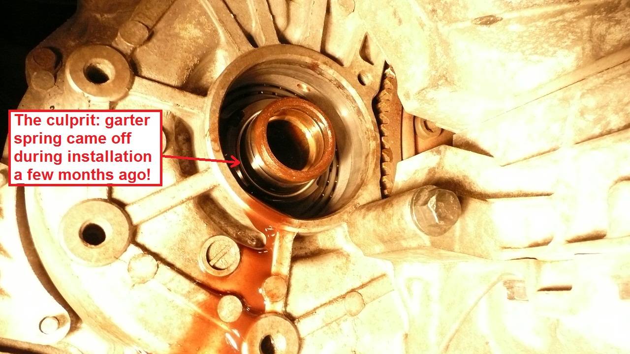

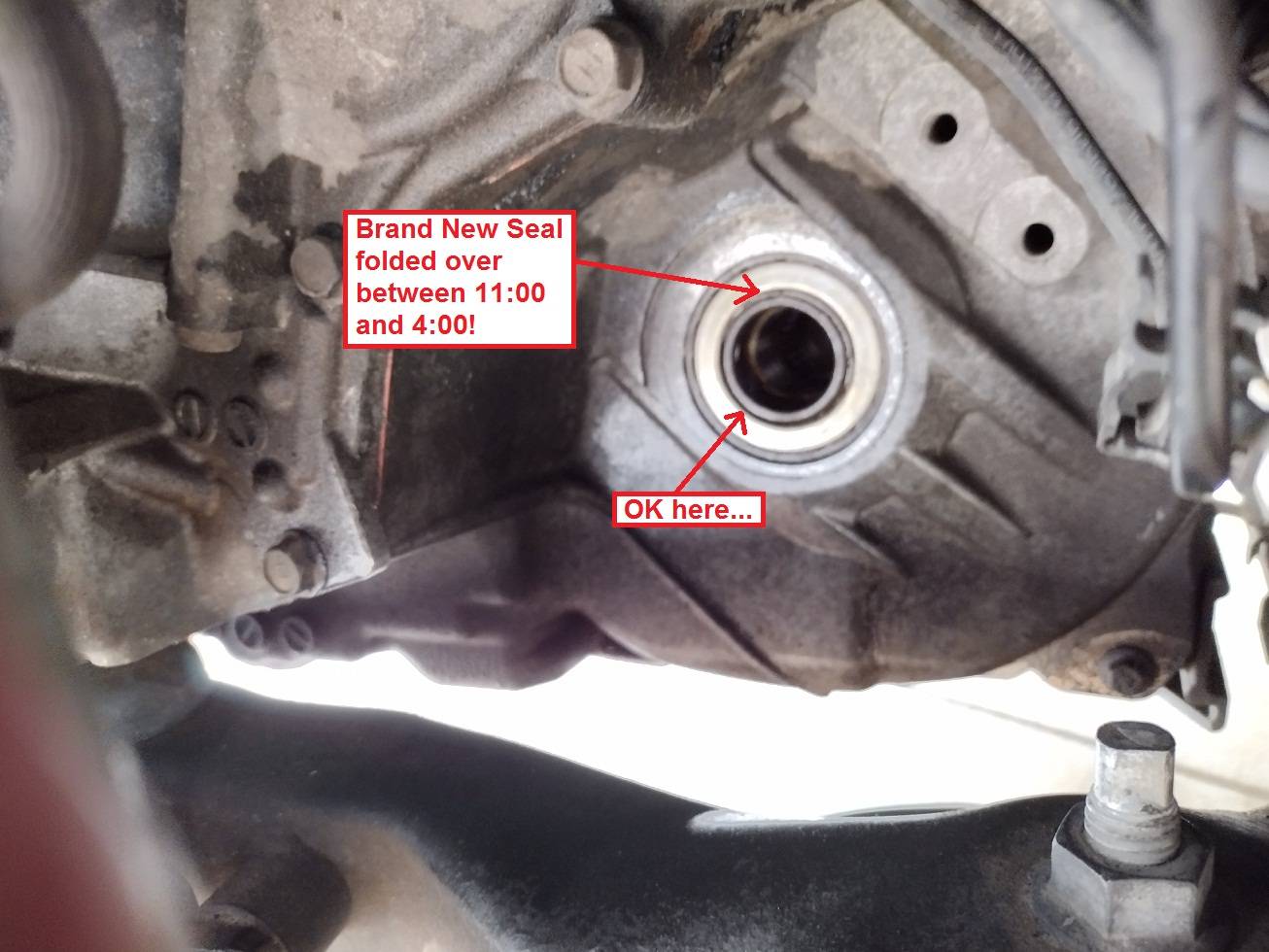

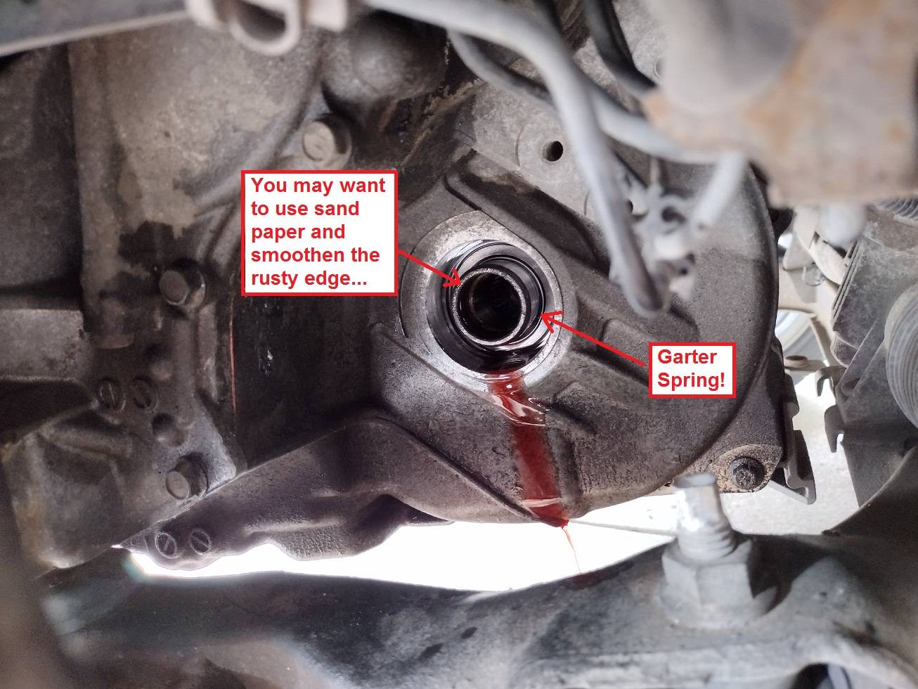

Update on my 2006 S60 with brand-new axle seal leaking on the R side after 1000 miles of installation!
What happened was: the garter spring came loose!!!
The video below (by a Mercedes tech) is a must-watch using Red Tacky Grease.
I learned my lesson. From now on, every seal will get this Red Tacky Grease treatment lol...

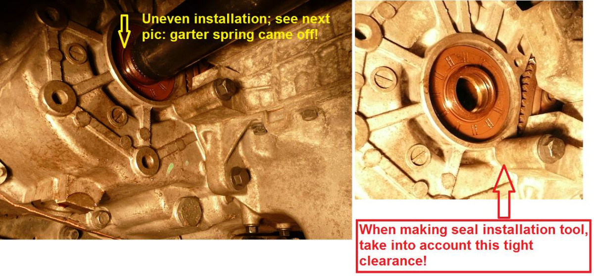

Update on the 2006 S60 with 106K miles...the Trans seal (Corteco) that I installed a few months (1,000 miles) ago.
I did not have the installation tool and installed it deeper than factory.
It started leaking after 500-1,000 miles, even when parked on the driveway. It turned out that the "deeper than factory" installation
was not so much an issue.
The main problem: the garter spring came loose during that installation!
See the video posted above by the Mercedes mechanic in the thread above!

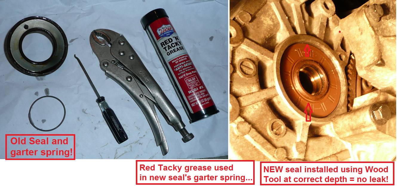

The trick: use Red Tacky grass to hold the garter spring in place during installation.

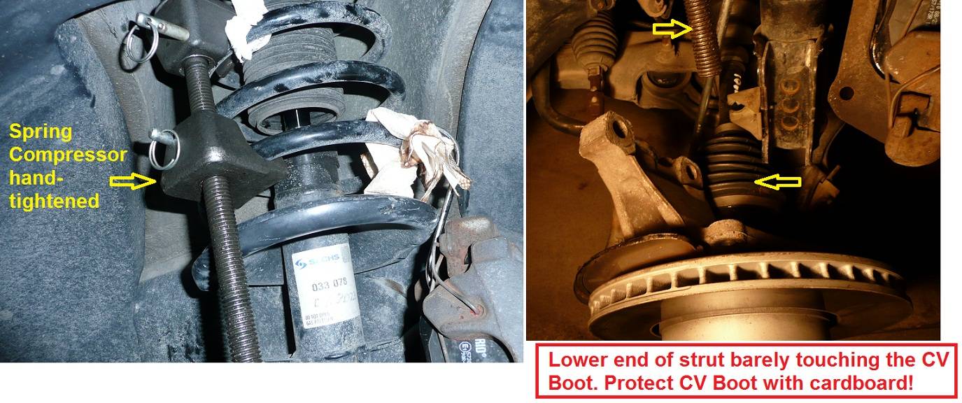

NOTE: in a previous post, I mentioned that it is 1000x easier to disconnect the strut 2 bolts at the kunckle.
However, the strut can extend down another 1 cm or so and can touch the CV Boot.
So, I hand-tightened the spring compressor before disconnecting the 2 bolts: this helps hold the spring a tiny bit up to avoid
damaging the CV Boot. You still need to cover the CV Boot with cardboard anyway to prevent damage to it.

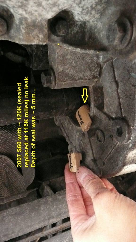

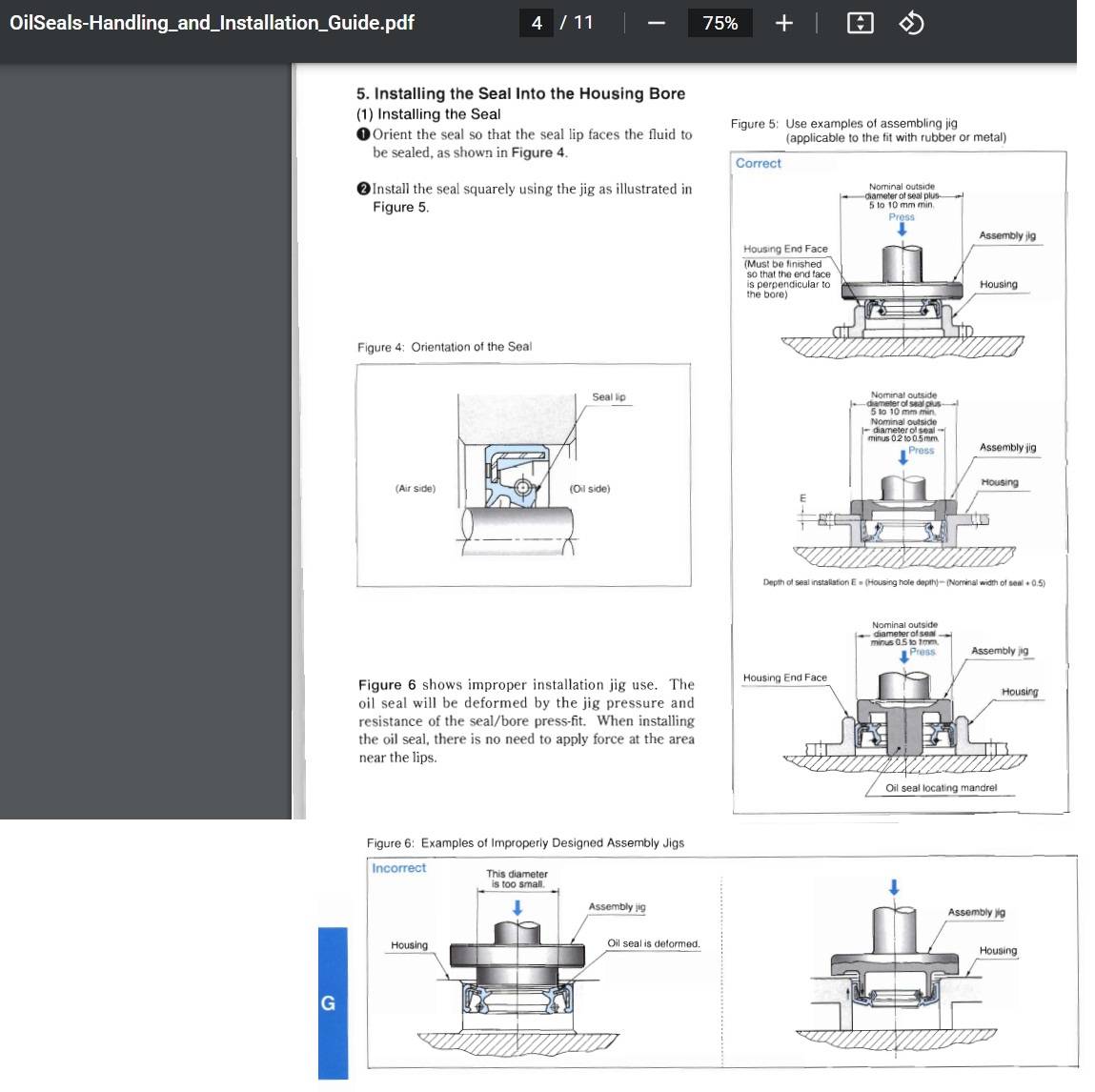

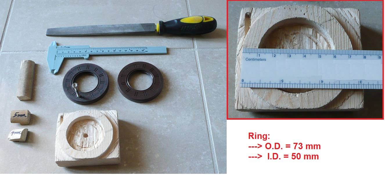

1. A different car (2007 S60) had the seal installed correctly at 5 mm ---> no ATF leak.
I cut a few pieces of wood with different depths as a gauge...

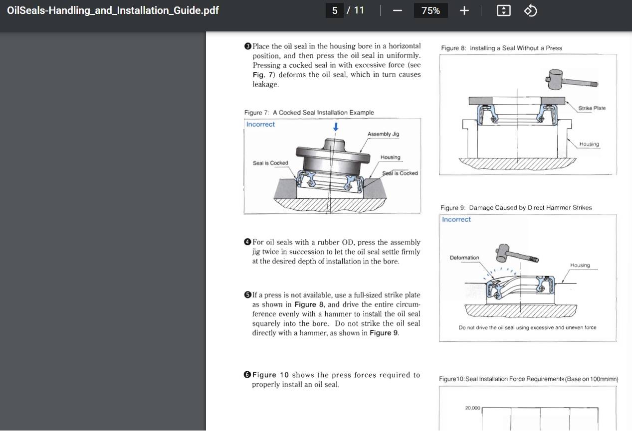

* Please see attached pdf document by Corteco-NOK on how to install new seal properly and pitfalls.
Examples:
2. Tool ideas:
* Electrical conduit washer is a perfect fit (Menards hardware has it).
* PVC coupler looks good too.
But for both of these items, you need to control the depth of installation. For the washer, use a piece of wood and hammer it in, the depth is ~ 5 mm. The PVC coupler: drill holes so you can only go to 5 mm, then use drill bits or sth similar (coat hanger wire through the holes) to stop the installation at 5 mm.
* Wood.

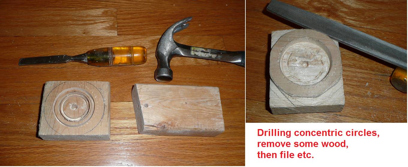

3. I decided to do it the hard way so I can learn making seal tool using wood.
I used the 2 x 4 wood and made the tool as shown.
As long as you cut the wood at 73 mm, it will fit in that tight space bc of the indentation on the housing as shown.
If you have the door lock hole saw as shown, it makes cutting the I.D. side easier. For the O.D., I did not have a hole saw big enough, so I cut it by hand such that it is ~ 73 mm, which fits perfectly bc it is 2 mm smaller than the bore side (75 mm).
Remember that the tool needs to exert force roughly about 1 mm INWARD from the edge of the seal. This is the vertical part of the metal cup (which is coated in rubber).
4. This 2006 S60: you can see that I installed it too deep at ~ 8-9 mm. But that was not the problem. The problem was: the garter spring came loose during installation bc of hammering.

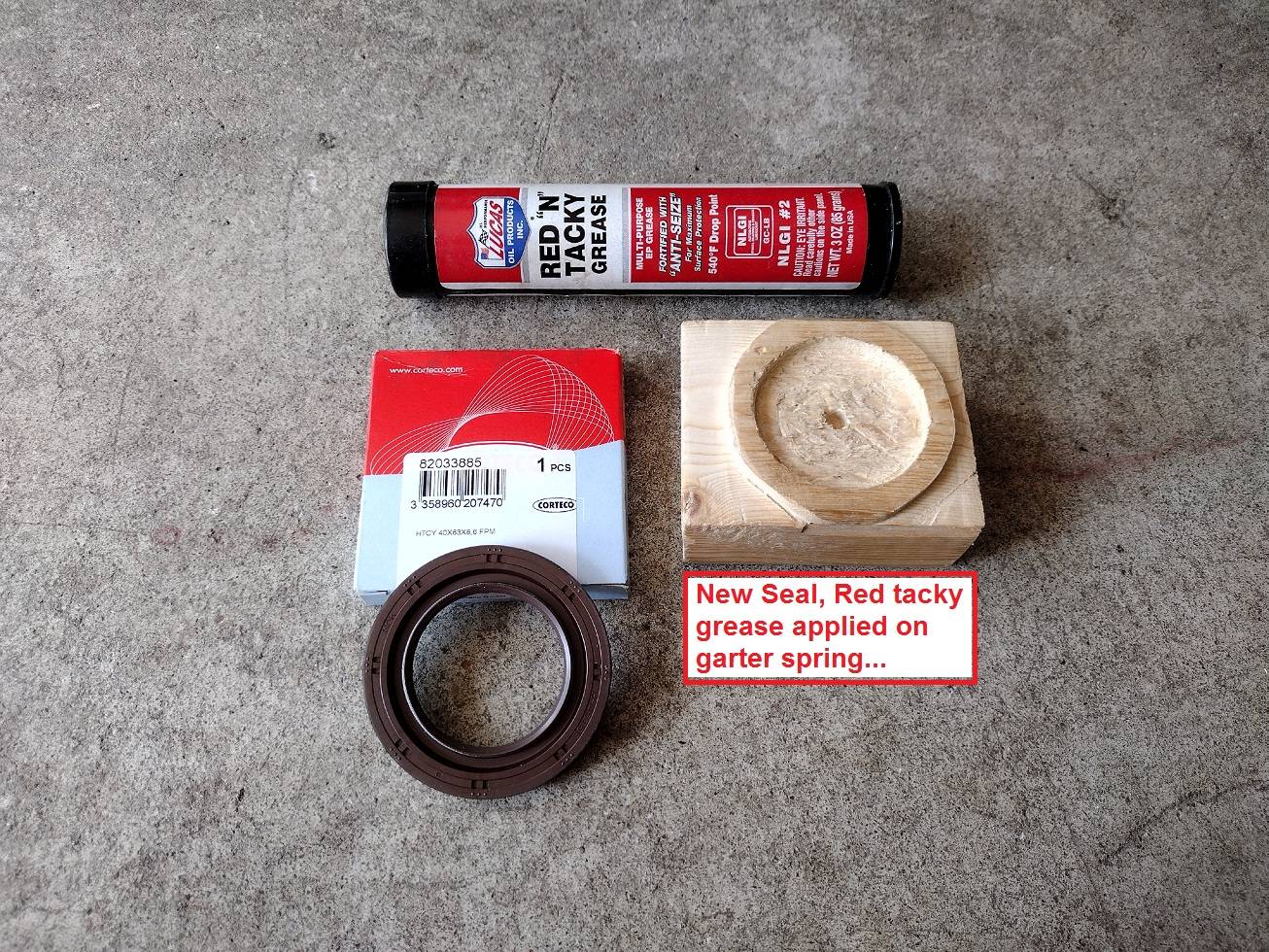

5. New Corteco seal + Red Tacky grease to help hold the garter spring in place + Wood Tool as shown. Don't forget to oil the sealing
lip before installation.
You can see the seal sits perfectly square by using this tool!
In a perfect world, you use a press to push it in, but there is no place to do it.
So the alternative is hammering it in, but the key thing is: use only enough force to tap it in to prevent dislodging the garter spring
(which already had the Red Tacky Grease treatment anyway).
Every minute spent making this wood tool is worth it.
Examples:

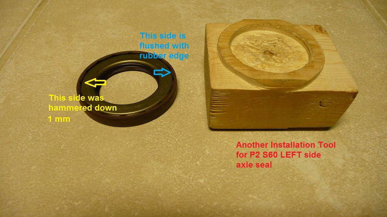

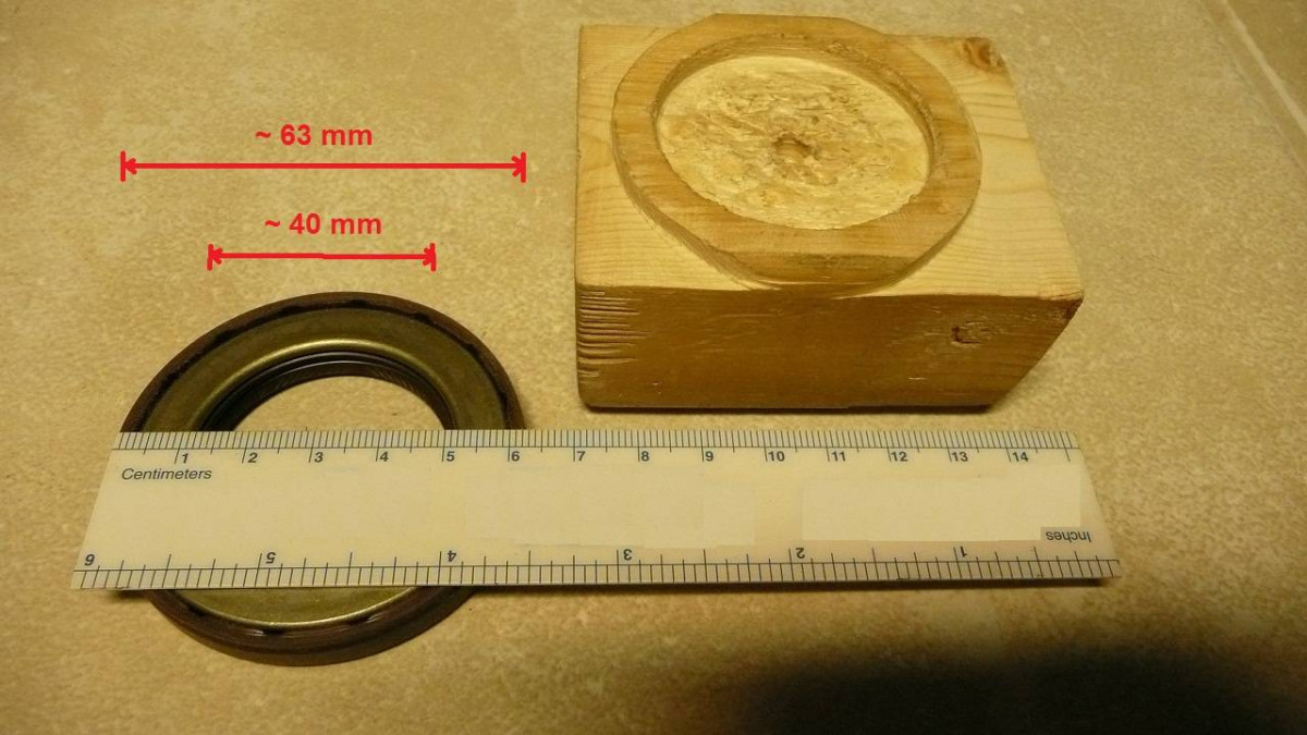

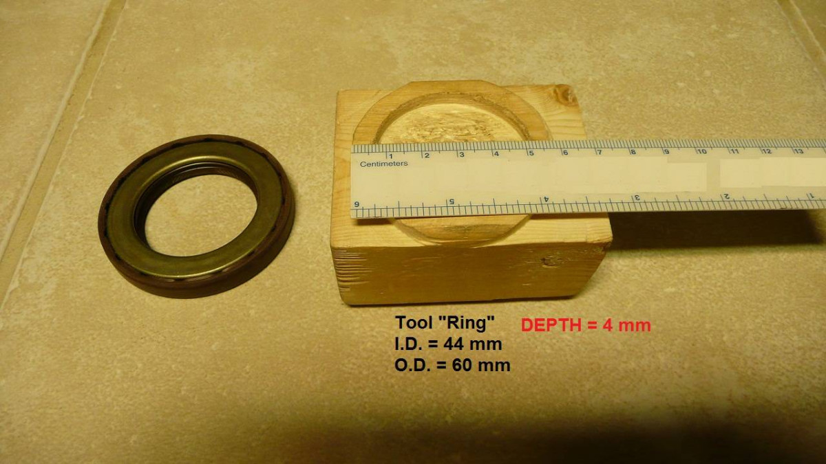

For the LEFT side axle seal, it is somewhat interesting...
Attached is the photo of a P2 S60 seal that was only 2 weeks old, it was leaking so I replaced it a few years ago.
Not sure what the cause of the leak was but you can see the design:
- It has a thicker rubber edge (than other seal) around the metal cup.
- The metal ring is on the inner side of this rubber seal.
- You can see on the side that I hammered on the metal ring: it sunk a bit 1 mm deeper then the rubber ring.
- I just made the installation tool for the LEFT side, dimensions as shown.
For this particlar seal with O.D. of 63 mm, it is important for the tool to press on the very Outer edge of the rubber.
So, in this case, the Outer Ring of the tool is about 60 mm to 61 mm.
- Anyway, seal installation is tricky business with so many different designs, pitfalls and you only learn it the hard way...

Another Update, this time it is the 2007 S60 with 125K miles...
I previouly redid the R seal in 2006 S60 with 106K miles in 2024.
The 2007 S60 LEFT seal leaking, I am becoming the seal expert lol.
I installed new Axle seals for the 2007 S60 in 2022 (3 yrs and 10K miles ago).
NOTE:
1. ATF leak at bottom of Transmission:
2. Note the garter spring came off during installation in 2022:
3. Note the 3 year-old seal with edge folding over. The fold-over section is between 10:00 and 2:00, so only leaks
ATF when driving.
4. New Seal, Wood Tool and Red Tacky grease (to be applied on the garter spring).
Even so, the brand-new seal folded over and thus destroyed, simply bc the only way to remove the brand-new seal is
to drill a hole for the sheet metal screw!
5. Luckily, I had another seal lying around.
- I used a piece of plastic. Do NOT use metal, you will regret bc if you score the metal sealing surface on the cup side
(the trans side), it WILL leak.
- So, I used the empty Clorox Disinfecting Plastic Container.
- You can use 1 piece or 2 pieces at opposite sides.
- Make sure you wet the plastic piece with ATF, go around slowly to be sure the seal lip is in correct place, it is very tight.
- To pull it out, do NOT yank it. Instead, rotate it around the sealing surface and slowly pull it out as you rotate it around
the seal.
Lastly:
1. Double-check, triple-check to be sure the seal lip is in the correct place.
2. Don't forget to add some ATF. In my experience doing the seal, some ATF will leak out during the job.
All you need is about 200 mL of ATF added at the end, when everything is buttoned up.
ATF when driving.

Hi guys
One of Russian volvo lovers (https://www.drive2.ru/l/709101163227644748/) shared me a blueprint of the tool and I asked another friend to create a 3D model and print it using 3D printer.
So he did. He used ABS plastic for printing. If you have a 3D printer or have any friend/company who can print, feel free to take files from the git: https://github.com/DJ-Glock/volvo-9995770
Hope it helps someone.
P.S. I have not yet used it for installing a seal into the car, but it should fit.
