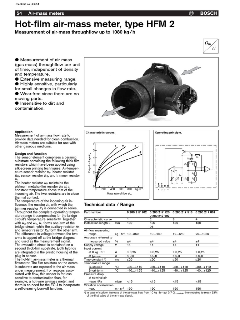

781 15 1 A 106 might be characteristics data. Electronics parts manufacturing is still an artform. One cannot just do a bunch of equations and poof one gets exactly what one wants. Electronics parts are manufactured shotgun style more or less. Then the characteristics are graded into different part number specs. Sometime a electronics manufacture will need to grade even more so then the component manufacturer.erikv11 wrote: 10 Apr 2021, 22:41 For Bosch 0 280 217 107, the sensor-only part number appears to be 781 15 1 A, possibly with 106 appended:

So, back on task; are you inferring/implying that your original suggestion:
probably won't work after all?RickHaleParker wrote: 10 Apr 2021, 13:09Remove the sensor from the housing and get the Bosch part number off the sensor. ...

It might still with some leg work.
From the data sheet above I discovered these cars use the same sensor.
1997 & 1998 Saab 900 2.0L & 2.3L.
1999 Saab 9-3 SE 2.0L.
There might be more ...
