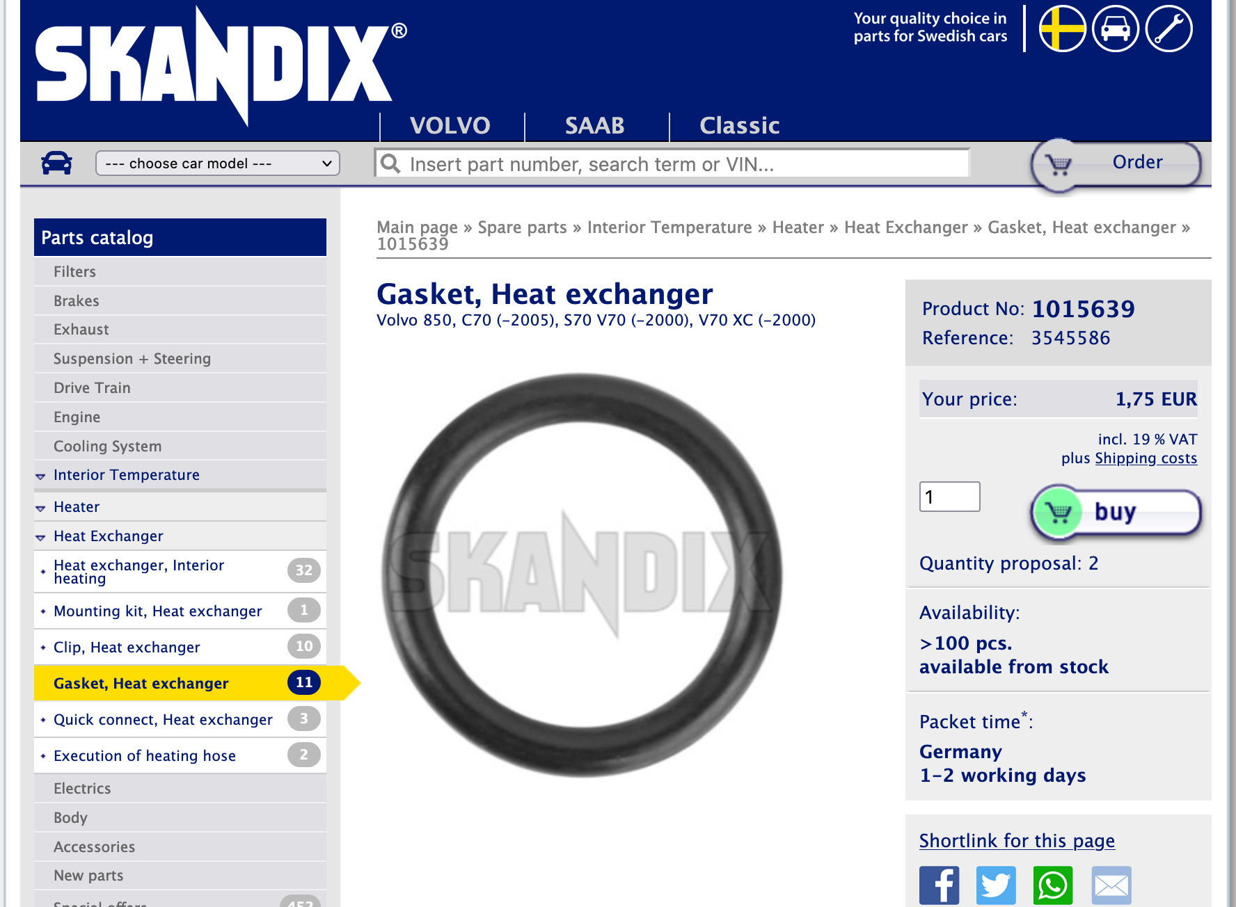

misha wrote: 16 Jul 2022, 08:24 This far i could only find 20x2.0mm and 20x3.0mm.
O ring master thread says 20x2.3mm for heater core o rings.
Will dig some more.
300 microns of width difference wont alter function. 20x2 will seal fine. I didnt report the error when i made those measurements either.
Sometimes Skandix in Germany reports actual o-ring sizes so maybe put that part number into their engine and see what it says?

Tried that allready....no measurements data.
Can green...ac system 20x2.0 o ring be used on a heater core pipes or i need black ones?
Edit...
I asked my ac specialist and he said that i should not use ac o rings for heater core pipes.
You can use AC orings, which are HNBR material, in standard applications but not the reverse.
The”h’ makes them more resistant to the refrigerant and oil inthe AC

He will check if he have the ones i need...i sent him a picture of o ring you posted here.
Still waiting for evaporator price and availability.
Volvo part # 3545586 doesn't show anything at most car parts shop.

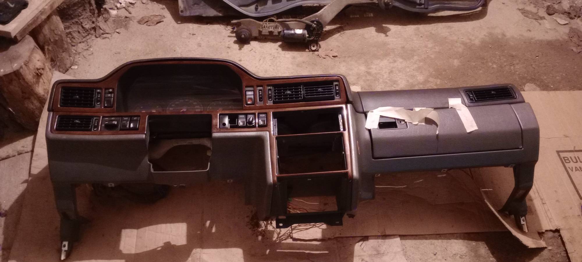

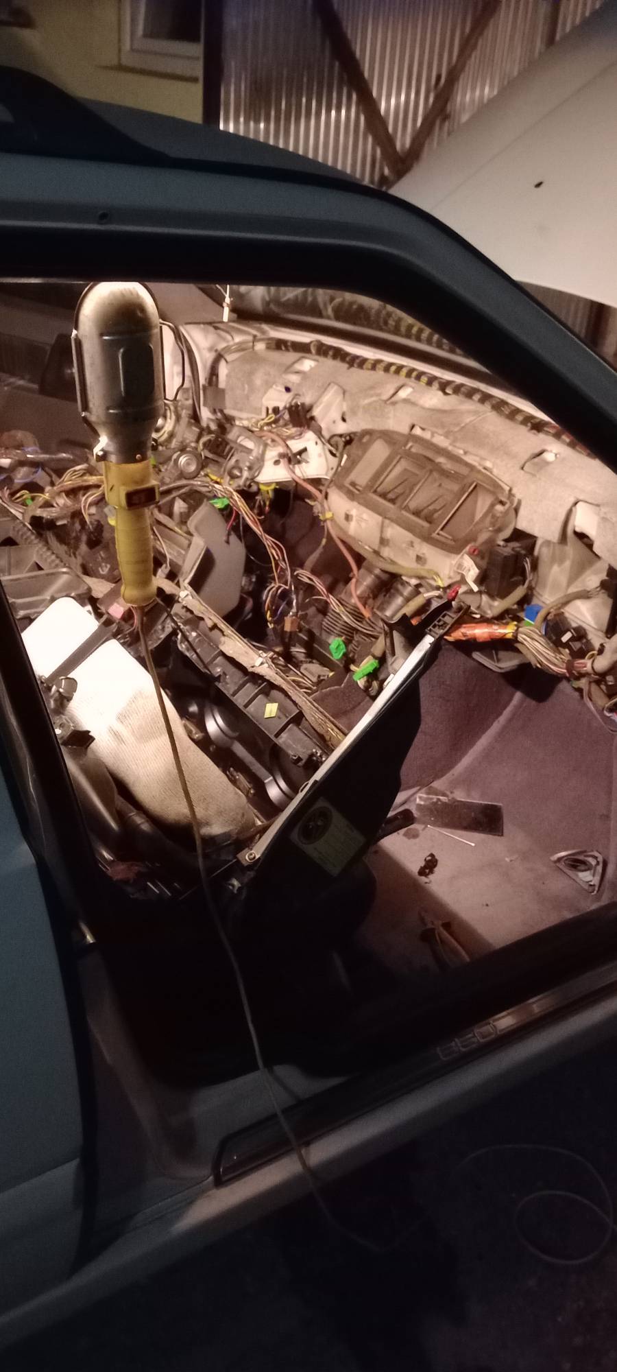

Dashboard removed,tommorrow HVAC system should be removed to replace evaporator and heater core and to sort out aftermarket alarm system siren.

Don’t be afraid to Dremel off the evaporator snouts rather than fighting the springs.
Much easier to remove short snout piece on bench.
Warning. The hard pipe goes deep into the evap so make sure you cut as close to firewall as you csn
