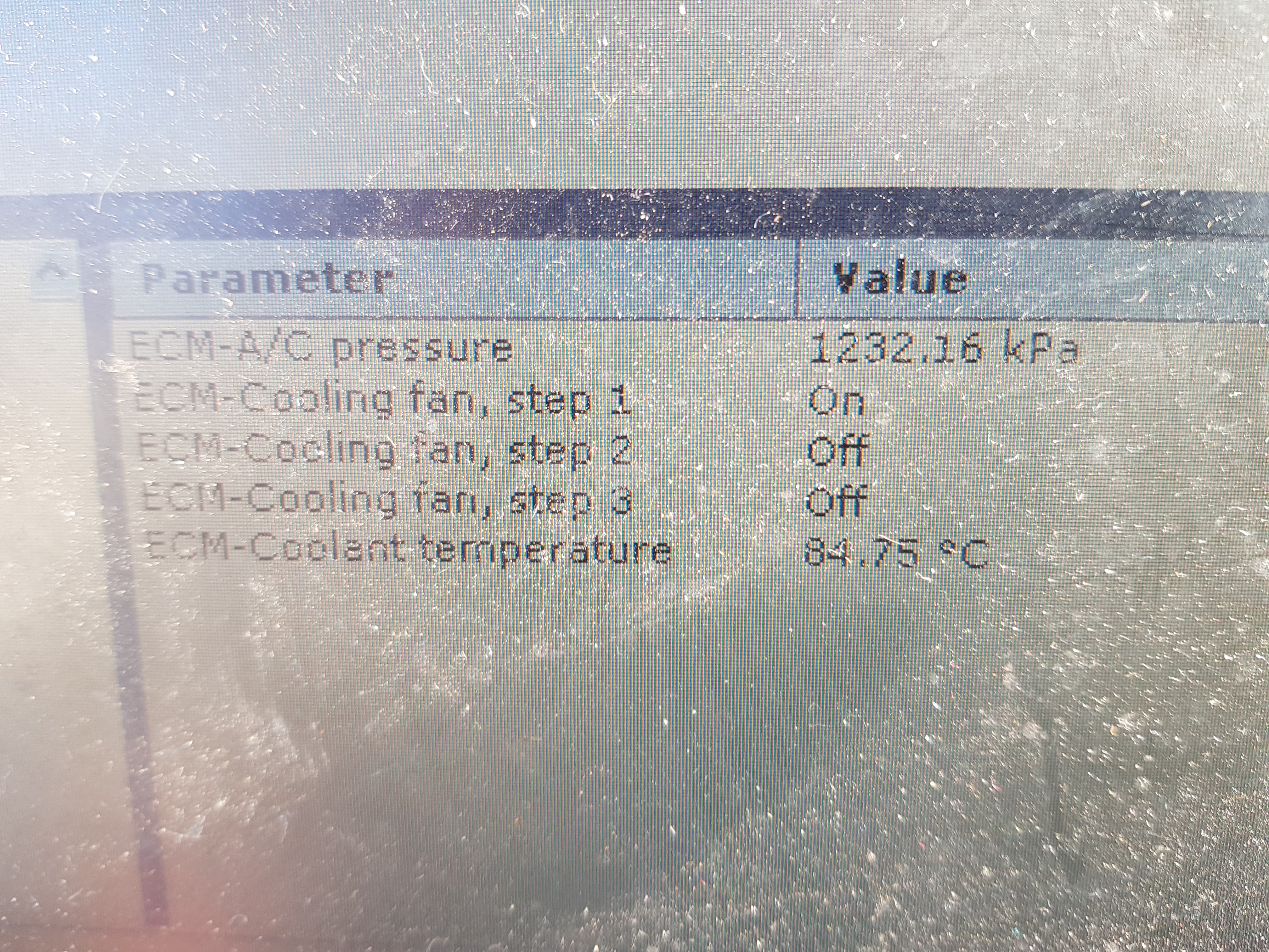

Just tried this on my 2001 T5 and finally the compressor stays on at lowest temp setting (it used to cycle)
Vida shows 1232-1340kpa and the cooling fan is running at step 1 all the time as it should though during operation at higher temperature (say 21deg C) it would cycle along with the compressor (not simultaneously though)

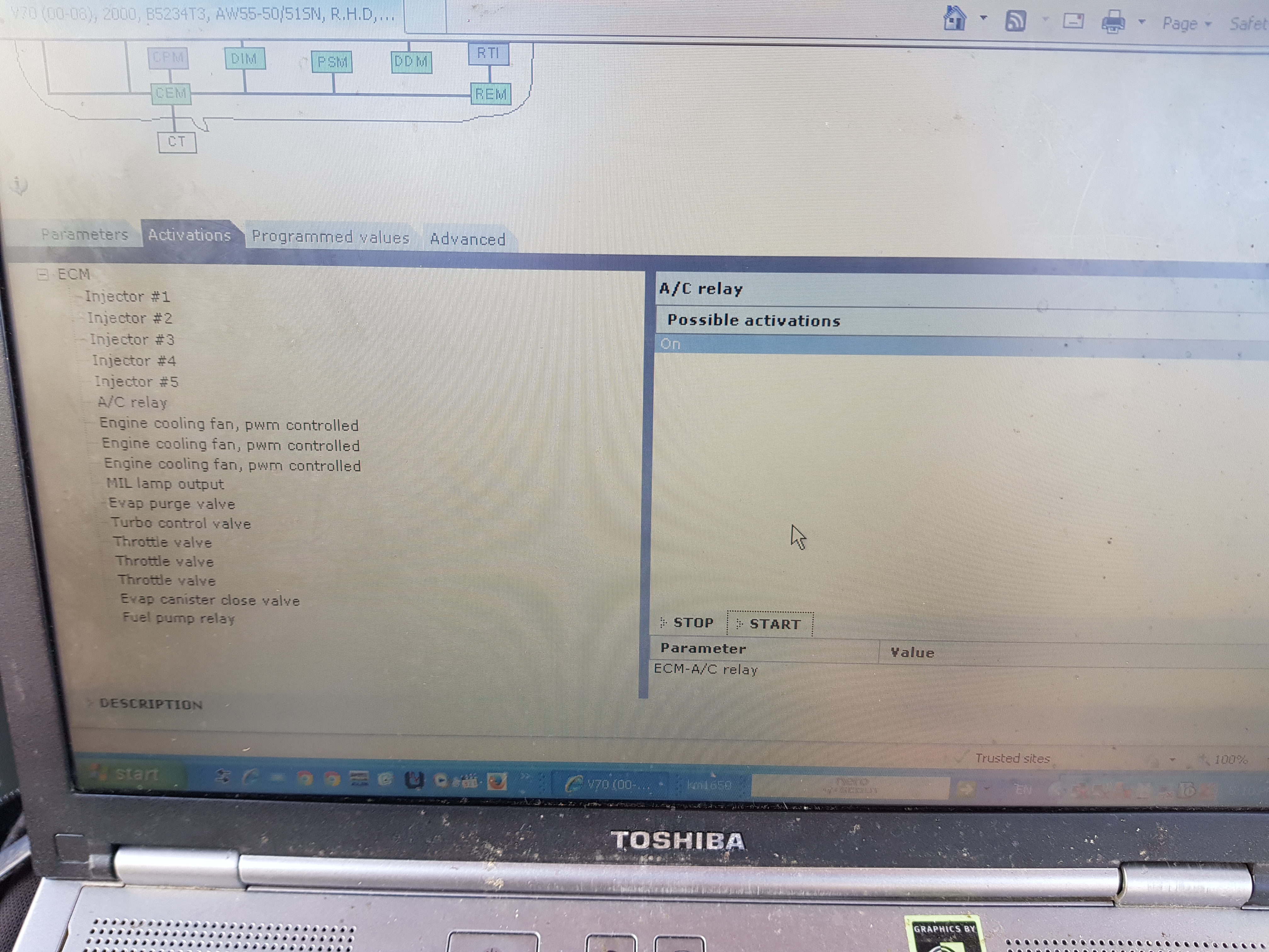

I used Vida to activate the A/C clutch and this made inserting the ties a breeze. You could do the same thing with an alligator type test lead hooked to the grey A/C connector feeing 12V+ on the compressor though I would disconnect the grey lead from the motor loom first to avoid feeding 12V back into the ECM.
I used zip ties and they seem secure enough. Only time will tell if this is a good fix. Weather has cooled here with the beginning of Autumn so may not see temps high enough to test it properly for a few months. Wasn't until I posted that I realized I had the dustiest screen ever posted on MVS!!
