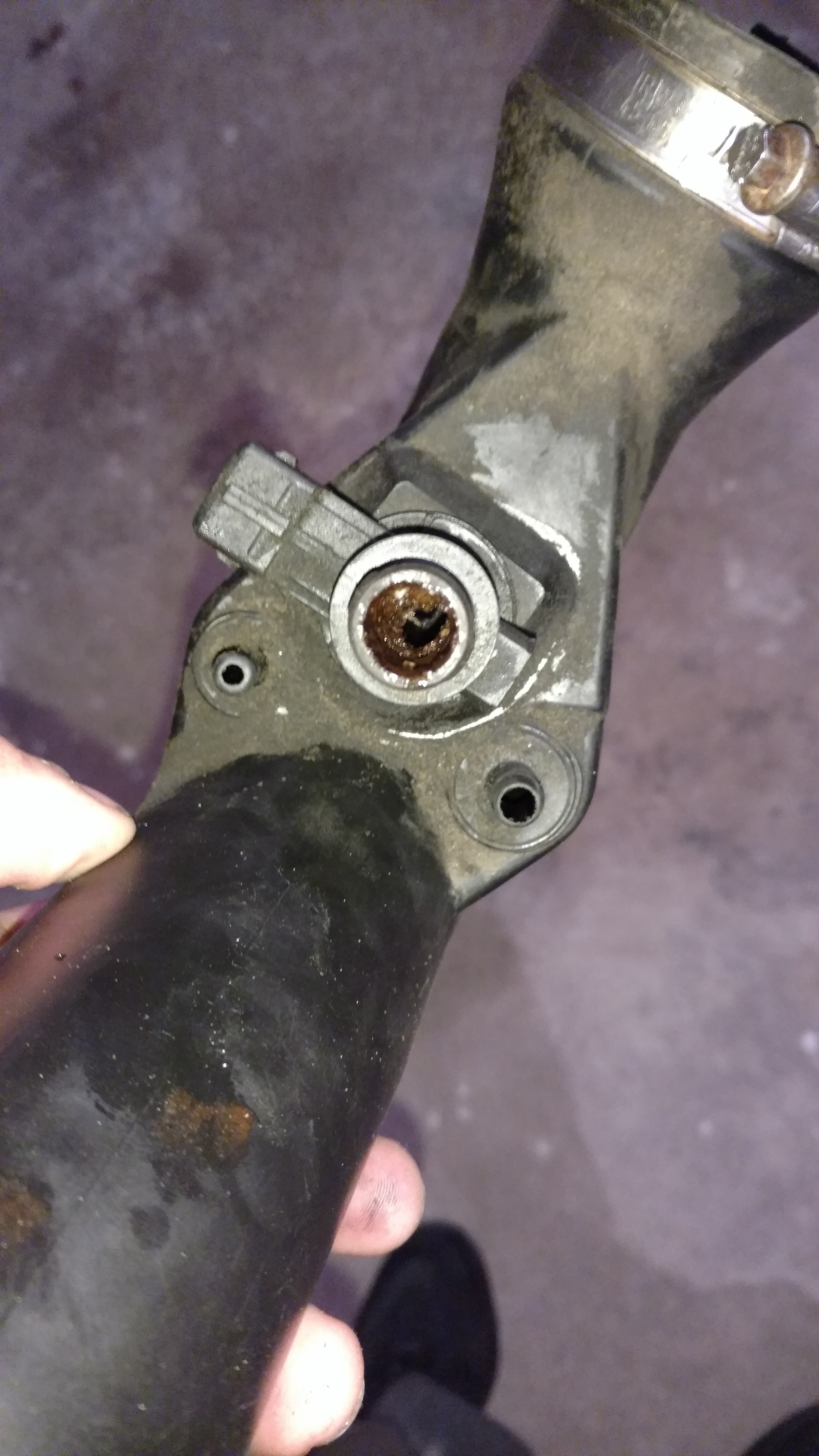

Thanks for the write-up and info, cleaned mine out about two weeks ago.
That turbo inlet clamp was a PITA! I bought a replacement at hardware store because it was difficult removing. When I took it out it was rusted or something and I sprayed some liquid wrench which made it work fine.
Took pic after I poked a hole through the blockage. The vac lines were clear, and hoses were fine. I replaced the clamp at nipple with a regular clamp from hardware store and it's holding up fine.
Going toreplace PVC parts in coming weeks, still getting dipstick smoke and positive pressure out of cap.
Forgot to snap picture after cleaning
