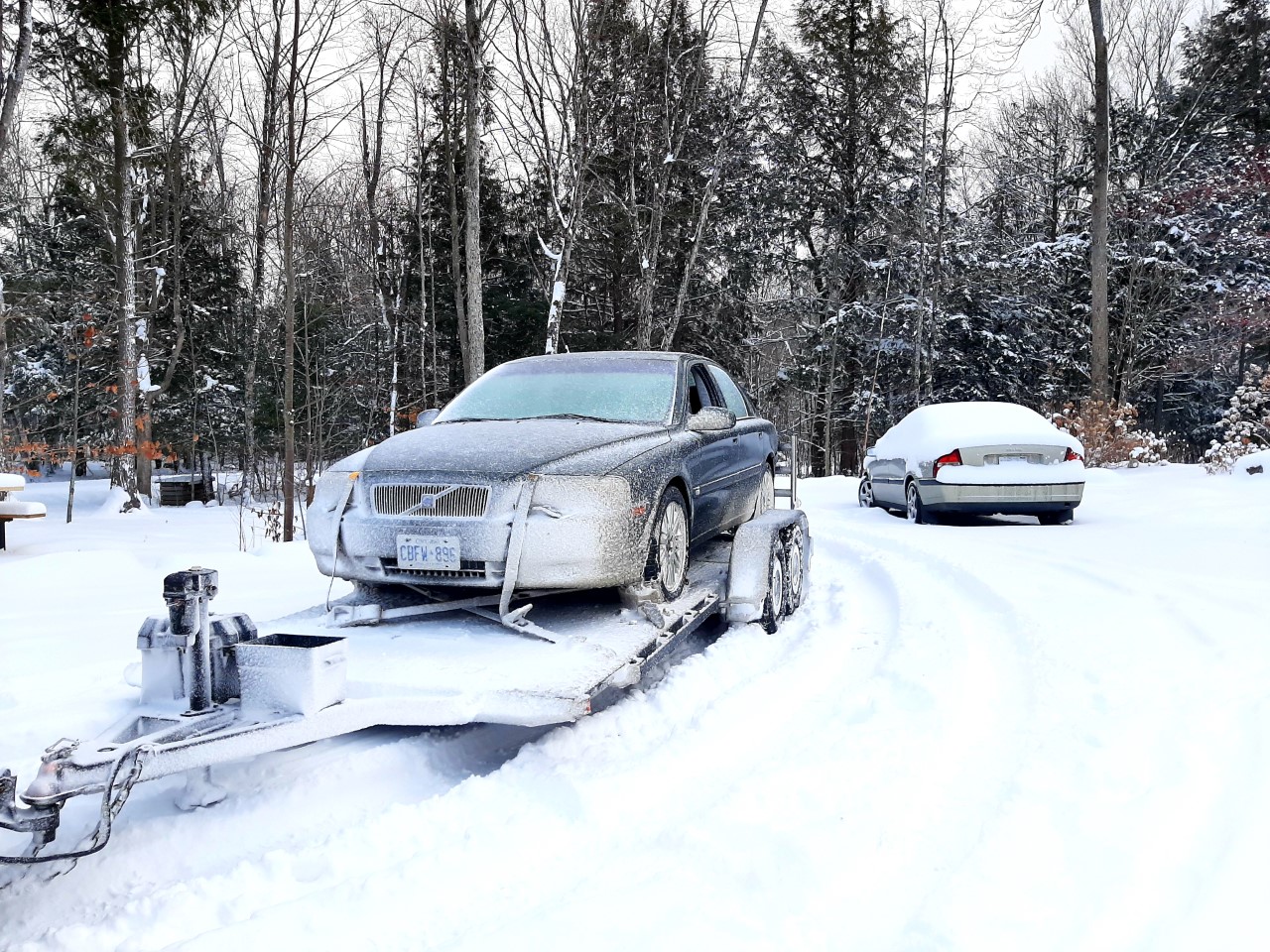

I've found a MY2000 s80 t6 that I am going to drag home today and start swapping modules between the two cars. I'll be swaping everything on the HI speed loop
CEM
TCM
ECM
ABS
and ETM if required.
Can anyone offer any insight into what modules are VIN locked and will also need to make the journey from the 2000 to the 1999? I'm aware there may be issues with with the key/immobilizer and will swap the ignition key if required.
Thanks! I'm so fed up with the BRAKE FAIL nonsense. Game on!

Damn, the ETM has to go with the rest eh? Normally i'd be all over it- no question about swapping every last module HI and LO, but..... its mid december in Canada!
I got the donor car home, I'll start pulling modules shortly. As much as I don't want to swap every single module on account of the weather (garage is full with a project car, not my daily driver lol) I'm worried that a single failed module could have caused all of my troubles here, and if I get lazy and don't swap everything I may be right back where I started. I should probably change the seats to match the power seat module to the cem, and door modules, uem, etc.

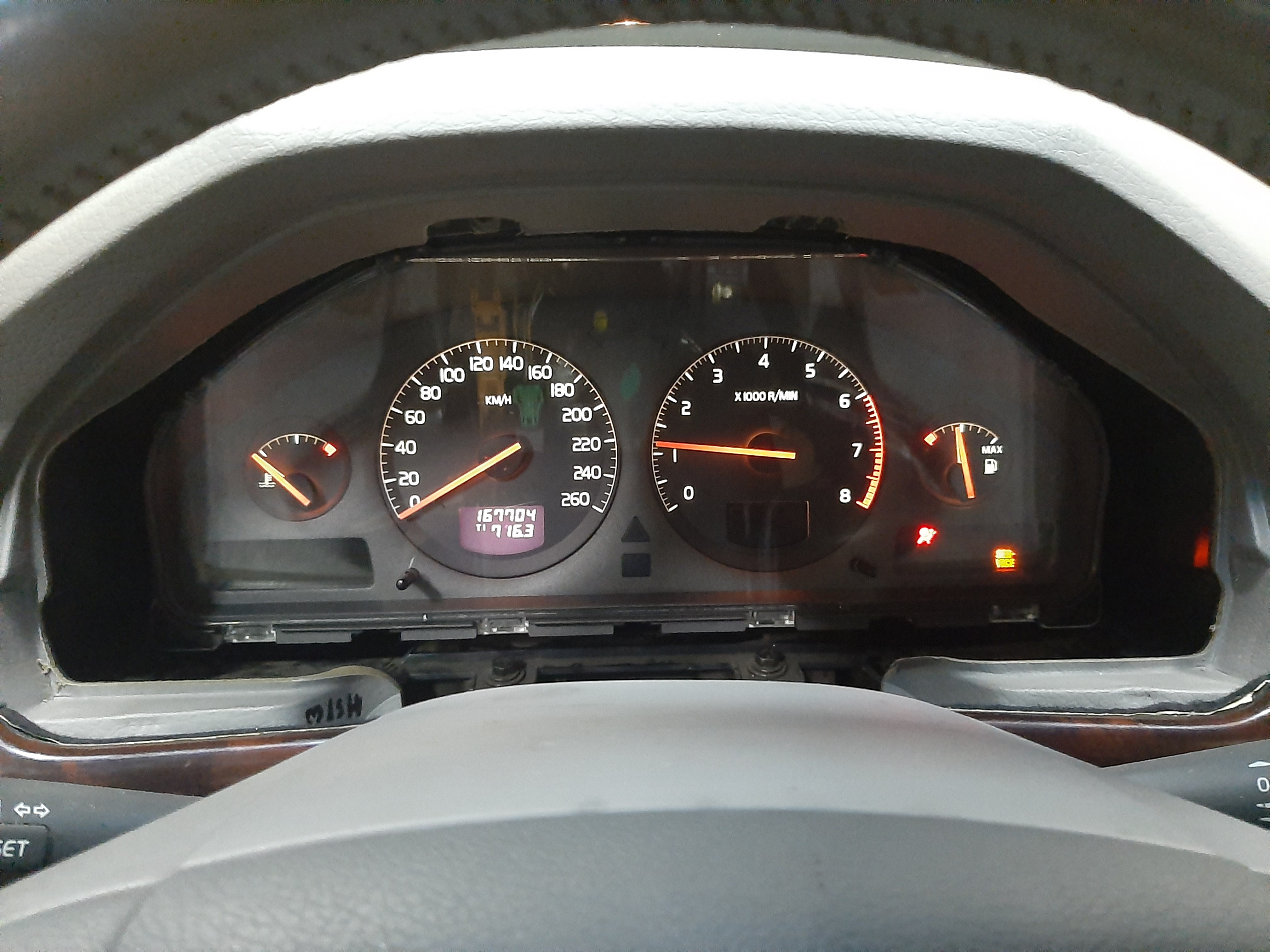

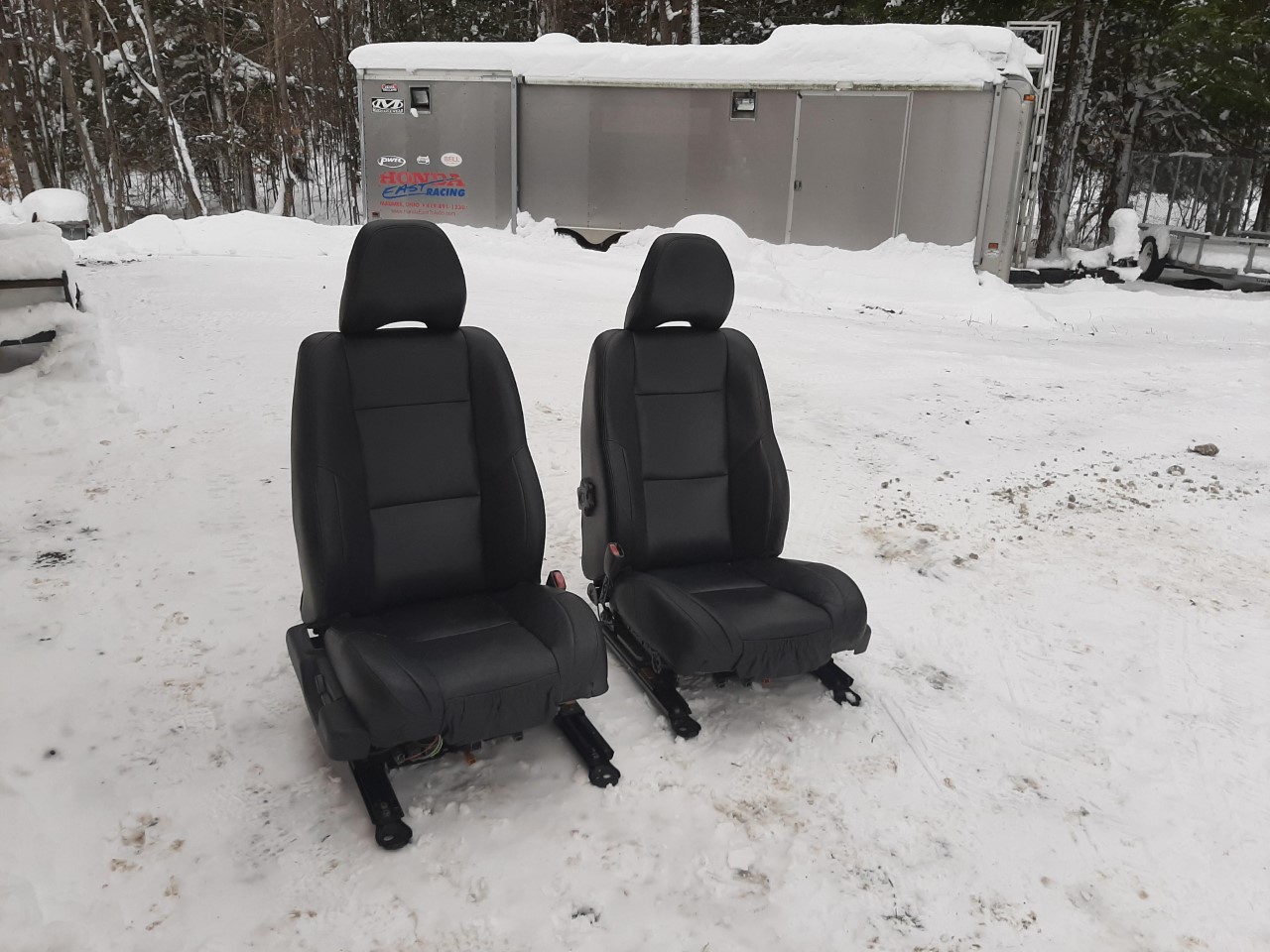

Here goes nothing...
I pulled the CEM, TCM, ECM, ABS, ETM, DDM, PDM, PSM, ISM, SWM, UEM, REM, SRS, DIM, and CCM from my donor s80,
Along with the seats as the psm is there and my driver's sips was an error that wouldn't clear in vida.
These are going in my car tonight, wish me luck
