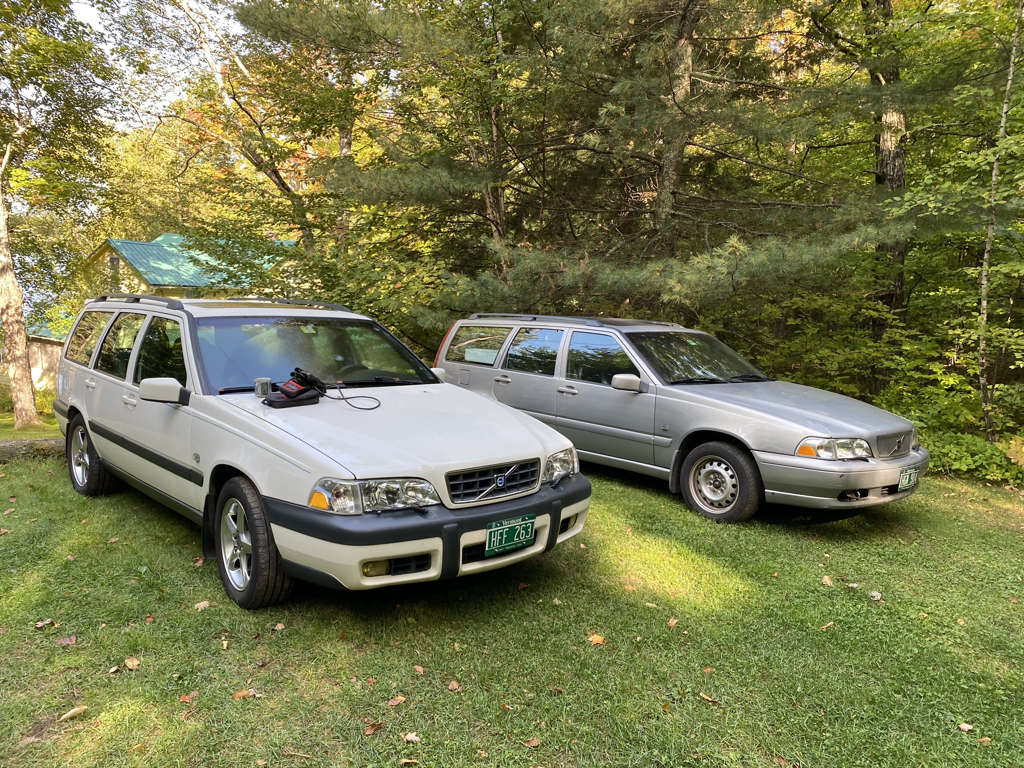

We got the Duchess of a Earl back home safe and sound. We had a wonky idle which cleared when we unplugged the Idle air control valve so that probably needs cleaning. Thread bumped.
Here she is, back with her family!
