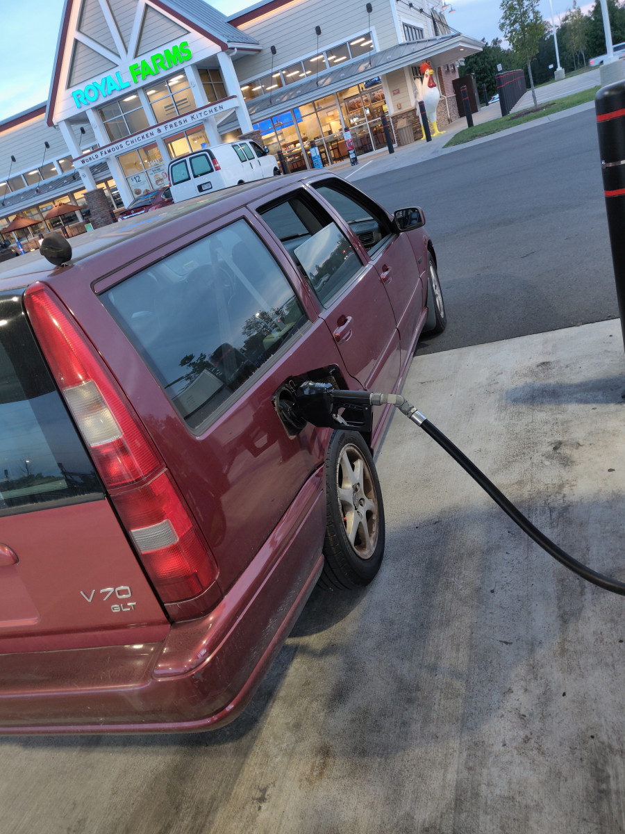

Right after I bought it, filling up with gas

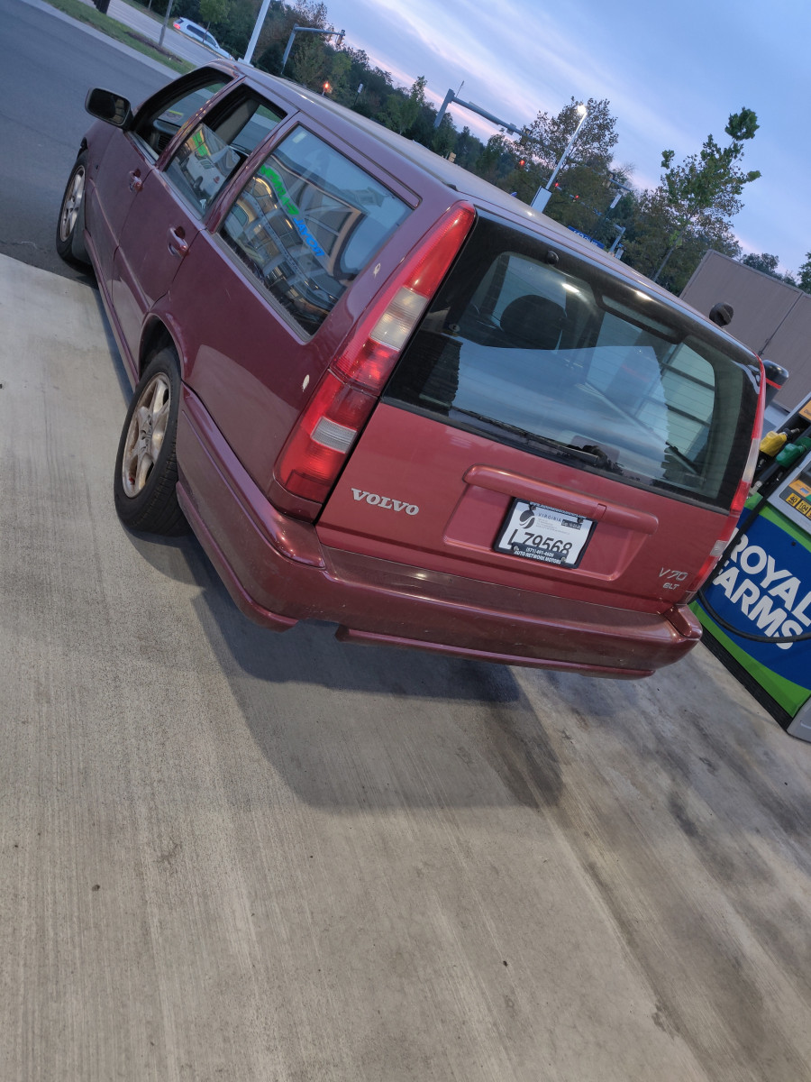

And I did some custom Italian Tailpipe Work....aka ITW....as shown in this pic...

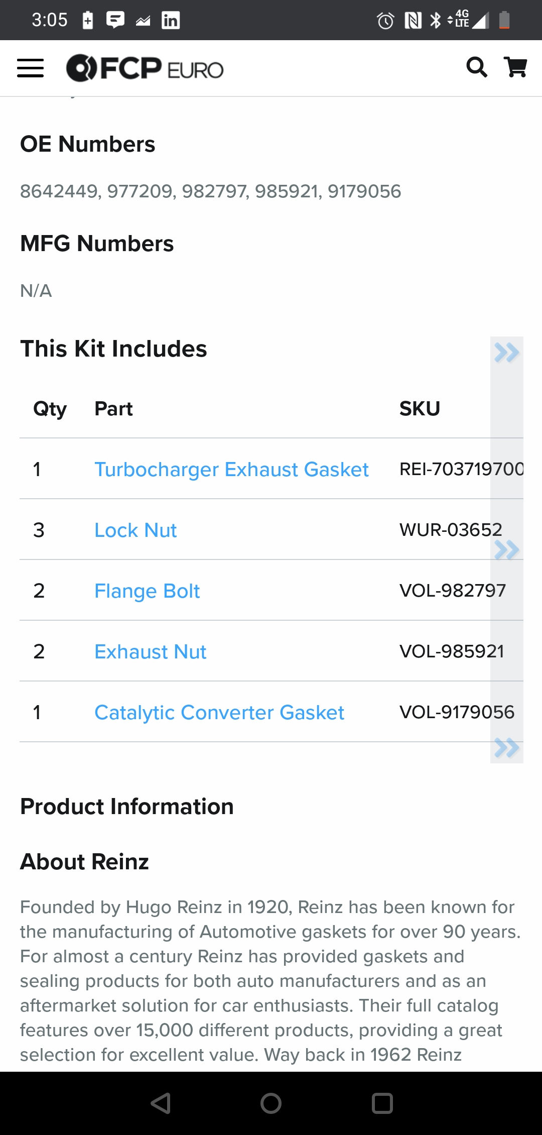

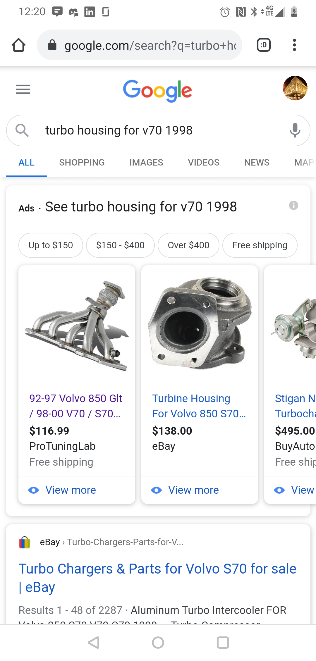

Ok, so I got some things on order.....I didnt get the manifold, but I found one that seems cool and performance oriented!
I am starting with these gaskets from fcp
Pics enclosed! I will get the car on the lift and get a good look at what is going on.

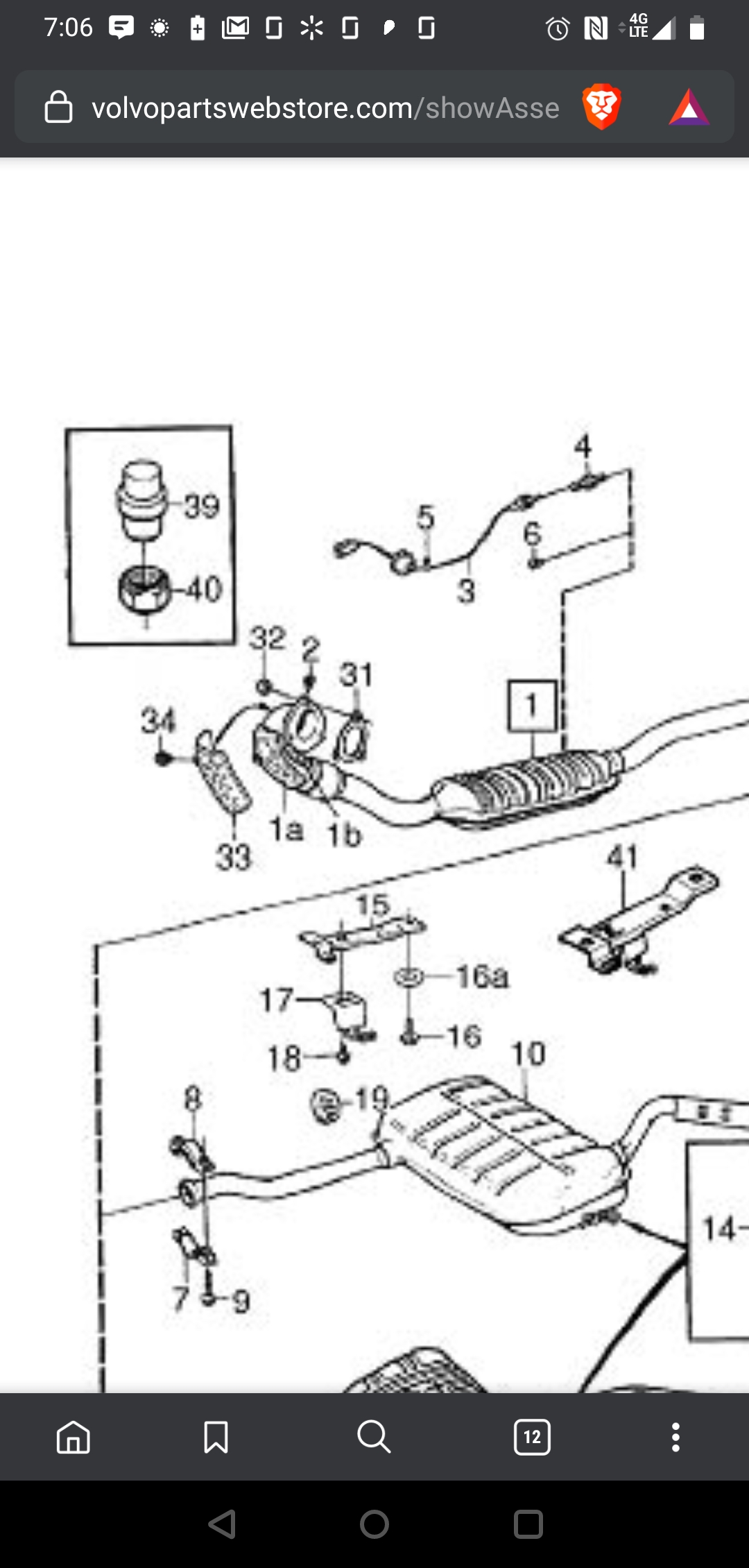

And everyone, Thanks for the help. I ordered the exhaust gaskets. The ones from the turbo housing to the downpipe, and the downpipe to the midsection. I think. Lol
Trouble is finding something that shows this exhaust in a good and easy to read and see exploded view!
If I end up doing this whole job, from cyl head to tail pipe out the back....I will post a million pics to help those in the future!
I know the engine cyl head goes to the exhaust manifold, and then......
The turbo block is next.....
And then the downpipe.....
After that it gets unclear----
So, on the downpipe....where is the connection on downpipe to the cat?
Cat gasket. Where is this? At the other end of the downpipe? And then connects to the midsection? Help if ya can....
I can't find any pics..... Help?
If I pull the whole exhaust and replace, I will take lots of pics. Lots to share the knowledge.
Anyone else do this or have a threads I could check out?
Thanks!

Diagram (junky one) of exploded view exhaust.
Exhaust mani and trunk block

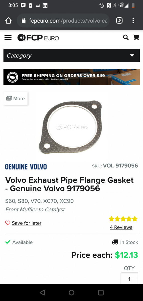

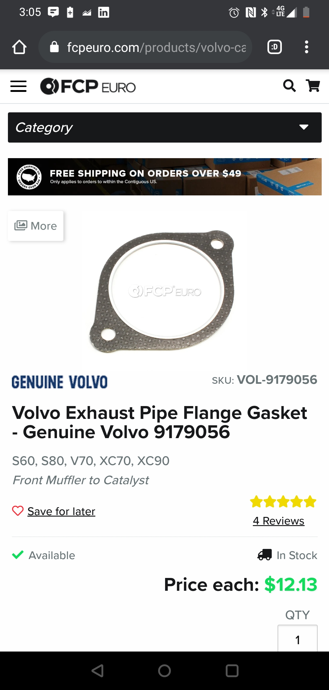

Cat gasket.  (Where is this?  At the other end of the downpipe?   Help if ya can....

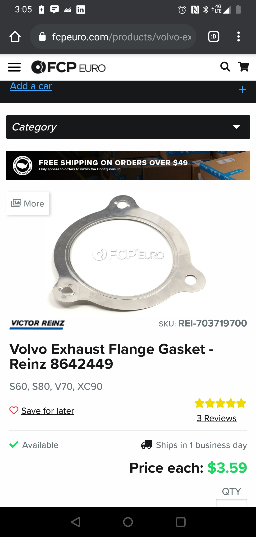

From turbo block to downpipe (I think)
Package was 32 bucks

erikv11
Posts: 11800
Joined: 25 July 2009
Location: Iowa
Has thanked: 292 times
Been thanked: 765 times
Post by erikv11 »
erikv11 wrote: 04 Oct 2020, 13:27 Oh and a very common place for these to leak exhaust is the joints for the cat, either the front or back joint. I think I have repaired all of mine now, Well, had them repaired - muffler shop.
These joints that leak are weld joints - there is no gasket. It is the weld joints in front of and behind the catalytic converter (number 1 in the diagrams), especially the one at the back.
There is one gasketed joint at the top of the down pipe, then the downpipe has a flex init and is welded directly the catback from the factory. That's it, the rest are welds all the way back, no more gaskets.

Ok thanks! And , the top of the downpipe gaskets to the turbo block....and then the turbo block bolts direct to the manifold, not gasket, correct? Any chance of it leaking there?
Also, I read in another thread that the color of the smoke is important. I will take a look again, I think it's blueish grey, maybe oil.
I may just put a new exhaust on it and be done. I like that manifold. What is a good downpipe to get? And any ideas on a midpipe aka pipe with cat...(or maybe without). I am almost at the age of the car that it won't need emmsions.....
