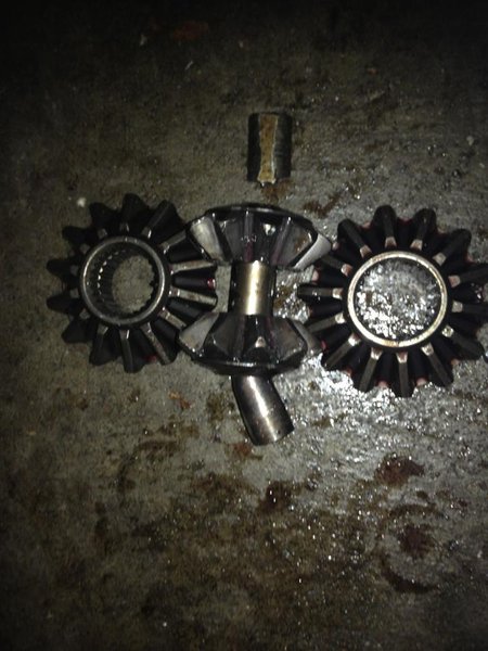

I think my car must have heard me saying I was considering this....
Whoops!

OUCH!
And a VERY rare failure.
DId the car have a high speed wheelspin with a sudden gain in traction as in connecting with clear pavement after spinning it over ice?

Nice huh? I was wondering that too, but not at the time it broke. Over its 225K mile life I'm sure its had a couple. Wife was backing out of a parking spot (at volvo dealer!) as she stopped, heard a clonk, selected D, heard a BANG!
I'm about to put the replacement in, as soon as I get the damn RMS out, which wasn't leaking but thought i'd do the "right" thing. Grrrr.
