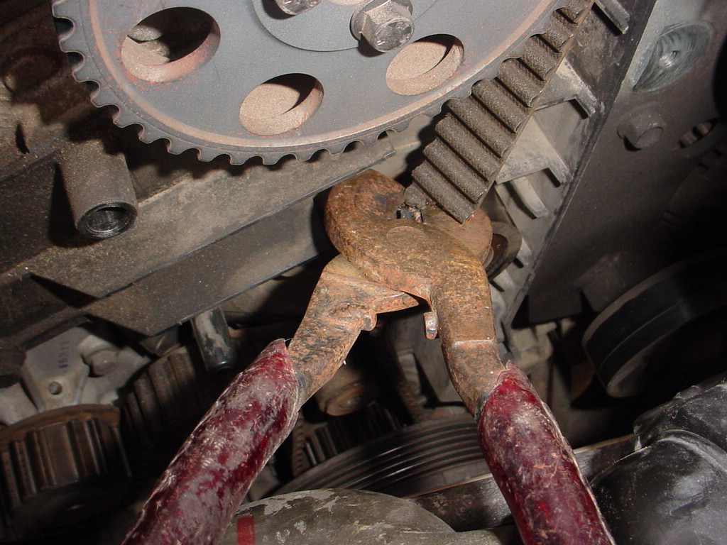

Thanks 1997Volvo850 !!
Great photos of the rubber stub under the crankshaft! Getting the old belt off was hard--it's interesting to see the thing that was making it so difficult. :D

Getting the old belt off is pure cake -- just cut it in half and be done with it. Tin snips or cable cutters will do the job.

I did the same just cut it with a pair of scisors, no time at all. :mrgreen:
