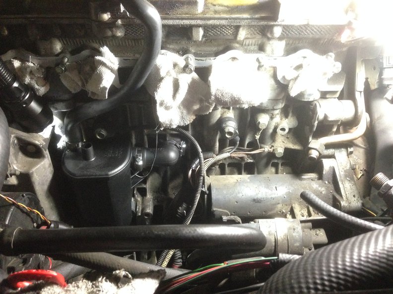

Oh I did service the PCV :) just put all the new parts in, checked the EGR, cleaned the PTC and replaced some turbo vacuum lines :)
It was a little overwhelming working on all that at once (working also for the first time on a car) but it is lots of fun though.
I still need to do some stuff. Still open is:
- replace broken caps and seals of the injectors
- cleaning the intakes
- and something else will for sure show up :)

Did you clean out the port from the bottom of the oil trap into the oil pan, or at least check that it is open? That is crucial, TBH.
volvofornia
Posts: 82
Joined: 27 Dec 2015, 15:17
Year and Model: '94 850 T5
Location: LA
Post by volvofornia »
erikv11 wrote:Did you clean out the port from the bottom of the oil trap into the oil pan, or at least check that it is open? That is crucial, TBH.
Yes, I cleaned both ports out. Wasn't a lot of stuff inside but I made it clean anyways. Thanks for the hint!
