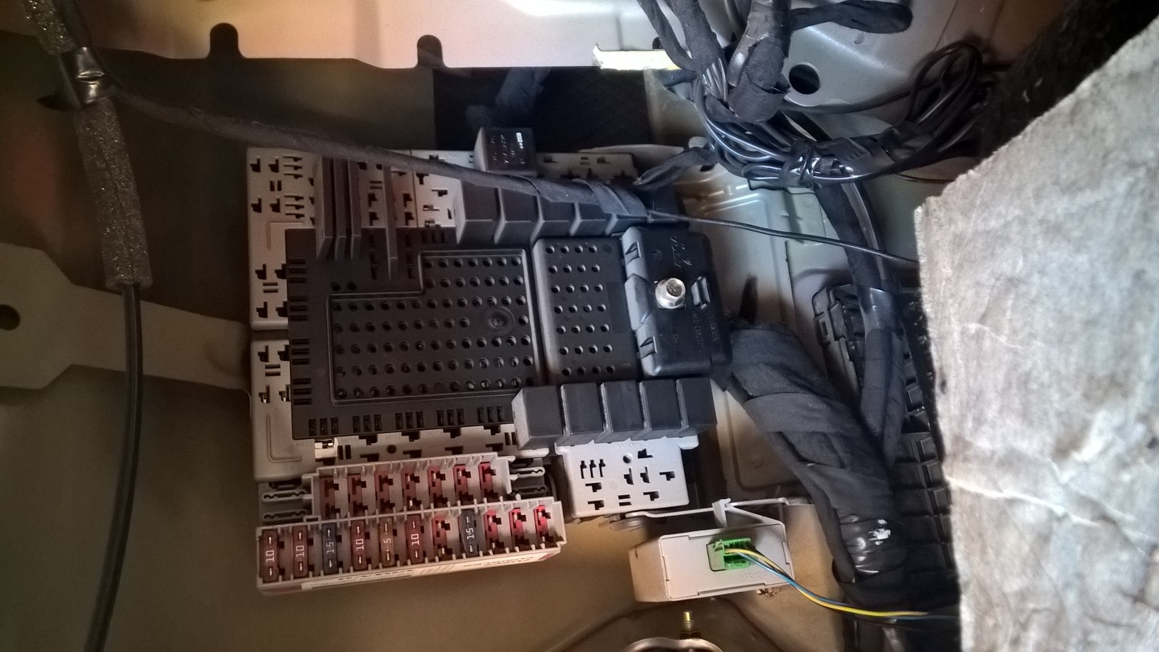

I'm going to try to fit the SIM type keypad in my 2001 V70T5 and see if it still works. The rear of the car is filled with a heavy printer for a few days so I can't take a photo of the rear phone module. I may need your rear phone module if it's up for grabs so don't throw it away just yet.
I recently used an IPD non-genuine PCV kit for a 2001 XC70 and I was VERY impressed that absolutely EVERYTHING was packaged in the kit including injector O rings and new crush washers for the 2 banjo bolts on the PCV pipe. Keep this in mind when/if you decide to replace the PCV.

I took a Photo at the left and the right side of the luggage compartment: no phone modul found - sorry!
