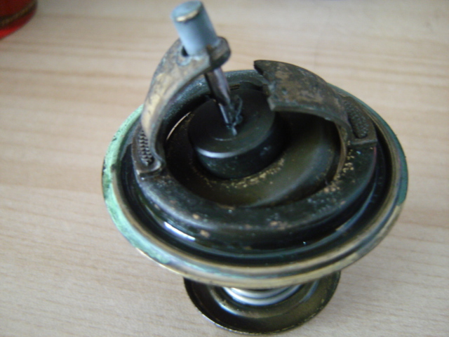

Just look at this! funny thing is, it NEVER ran hot. I made the decision to replace because it took forever to warm up and got cold going downhill.
