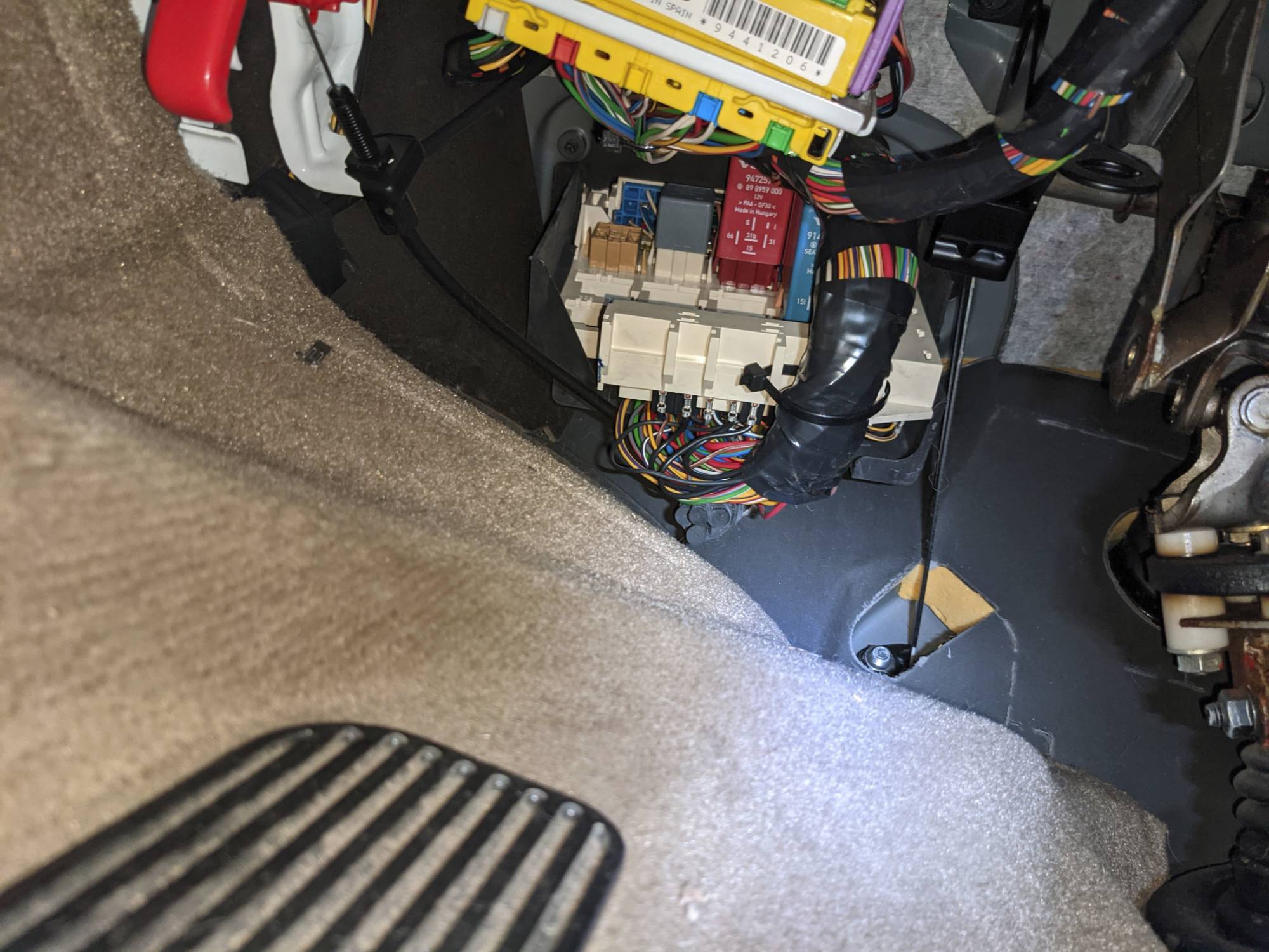

Thanks for the tips. It appears that the 2000 without heated seats has the wiring for the switches under the coin tray (see picture). Does that picture show the fuse box behind the steering wheel which you're talking about? It's above the left foot rest near the hood release lever.

That is the connectors for the heated seat buttons in the coin tray. Weird though there are no blanks in the tray t give access to them. I you can't find one let me know as I have several.

No that's the relay block. The fuse box in the -98 P80 is on the other side of the firewall, under/in the cowl.
https://www.matthewsvolvosite.com/fuse- ... -xc70-c70/ but it doesn't show the circuit breaker positions, 39 and 40. Does your 99 have the same fuse box?

99-00 also has the same fuse box, as well as the kidney shaped one in front of the brake booster. The reset fuses are normally in there, but I don't know if the heated seat ones are.

Here ya go, the circuit breakers in a pic, on an '00: viewtopic.php?t=56327
