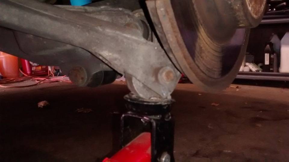

Do I simply jack up at the blue arrow, below the rear shock, remove the two bolts circled in the picture, and then the trailing arm comes off? Installation is the same, jack up and then the two bolts? Can I lower the jack after removing the trailing arm or should it stay compressed? Anything else in tension that might break?

I found using a longitudinally positioned floor jack is easier than conventionally placed jack + strap. This way it pulls the control arm closer to the front of the car when you jack it up, which makes it possible to align holes.

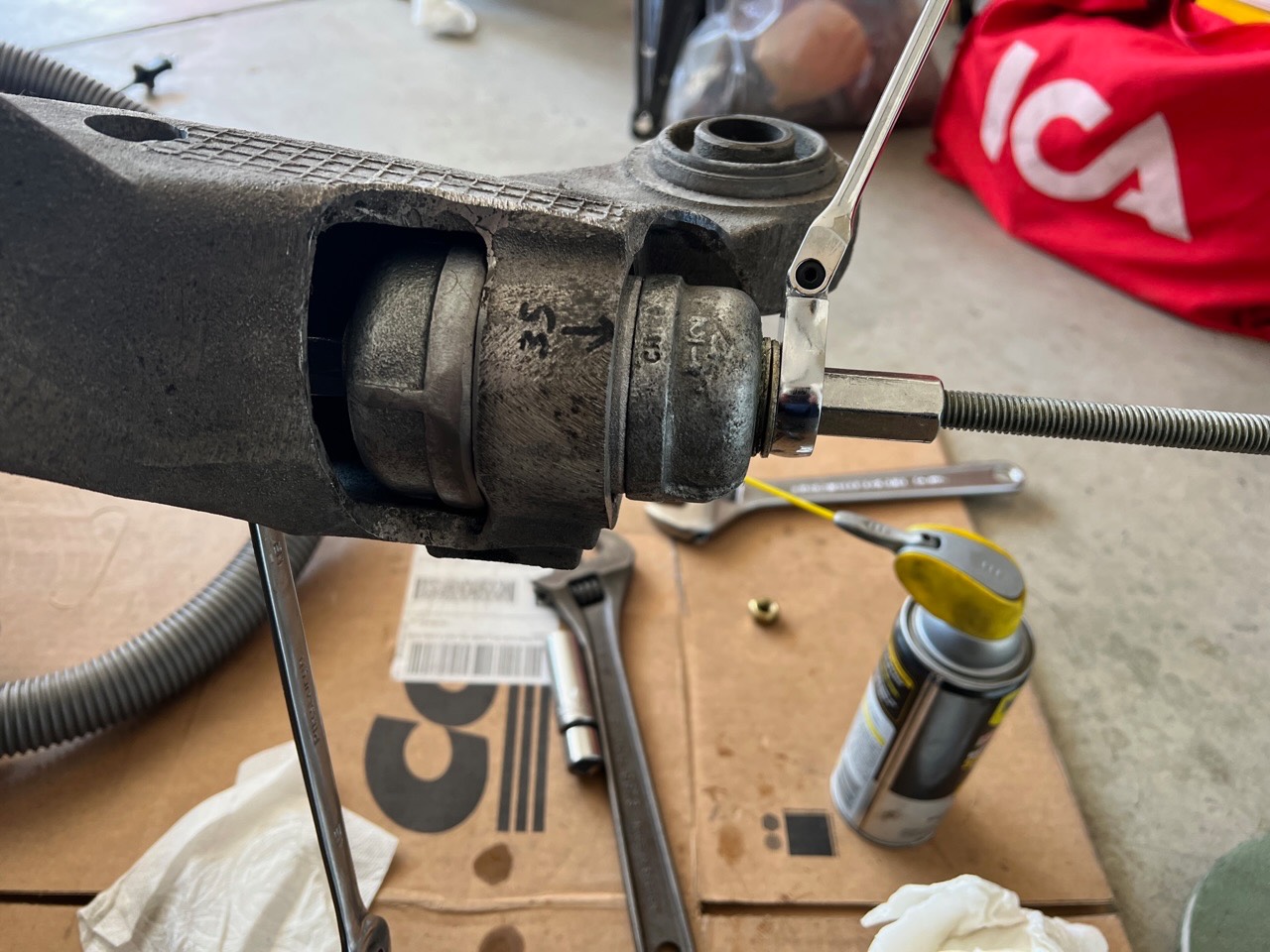

Doing the same bushing replacement on our 2006 XC70. I ended up modifying galvanized end caps. Al you need for tools is a 1/2” drill, drill and grinder with a flex disc. All parts can be purchased at Home Depot. See the pictures for the parts I purchased (FYI threaded rod I used was 6/17 thread, 1/2” was a backup plan) The small end cap needs the trough hole and the casting burr’s removed at the bottom.
The larger end cap burrs from the bottom, chamber on the bottom outside edge and the inner threads removed with the grinder to clear the bushing outer dimension. Make sure to apply grease to the threaded rod and washers.
The bushing went in smoothly with a bit of silicone spray and leaving the bushings in the freezer overnight. I did not want to risc it with plastic parts breaking half way and loosing the effect of putting the bushing in the freezer.
Also it is much easier to setup than with a heavy c-clamp and many loose parts. Did this on other bushing replacements.
