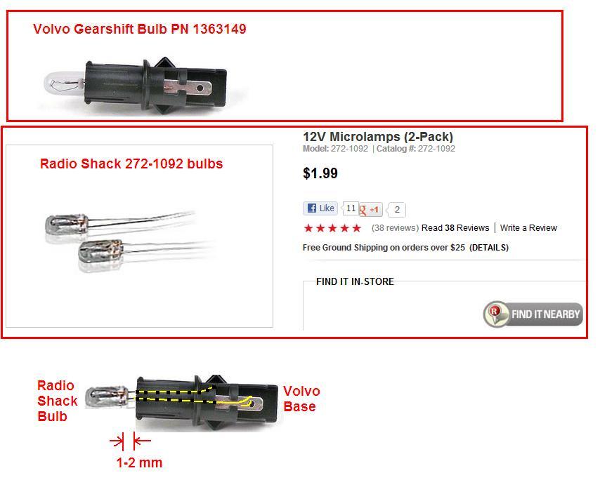

It appears that the bulb is the same for 850's and S/V/XC/C 70's (first generation). and looks like this (by the way, it's the same bulb for the cig lighter):
Although a part number is not mentioned in VADIS for the 70 series, for 850's it is #1363149-4 (also #30710781 in other places) and is listed for both types of cars as a 1.2 watt with description as "special." In other words I'm afraid you're not going to find it in a regular car parts store or at radio shack. If someone does, please let me know. Put 1363149 in the search box at http://www.foreigncarpartsonline.com/ and you'll find it for $10.30. IPD sells it for $9.00 at http://www.ipdusa.com/version.asp?strPa ... &V_ID=4546

The photo posted by MadeInJapan is it. Notice the little copper wire extending to the metal tab. That wire is actually hard connected to the bulb (x2) and soldered to the tab.

This is an old post but I need to update the crowd re Shifter Bulb.
* The Gear Shift Light Bulb (PRND3L) is a special Volvo bulb as mentioned above, but it is expensive!
However, I was stuck on Sunday and had to get the job done, so I used Radio Shack 272-1092 with success.
Rotate the bad bulb sideway back and forth to break it from its base.
Look down the base, there are 2 tiny holes, thread the Radio Shack bulb wires through the base, then loop the wire in the hole of the spade connector.
Just make sure the 2 wires don't touch each other.
Believe it or not, the Radio Shack bulb is as good as the factory bulb.

I did not take photo but just made this diagram to illustrate what needs to be done:
- Twist the old bulb CW and CCW many times, it will break off the base.
- Thread the new Radio Shack bulb 2 wires down the holes and loop them around the spade connector as shown (yellow lines).
- I left the Radio Shack bulb sticking out a bit (1-2 mm) but I guess you can leave the bulb flushed with the edge of the base.
- As long as the 2 wires don't touch each other, it is fine.
Done is 2 minutes!
This is what happens when I am stuck on a Sunday afternoon with all stores closed, the console was taken apart and I need the car the next day. Some ghetto fix but it turned out perfect. Volvo Bulb = $10, Radio Shack bulb = $1.
Needless to say, the Radio Shack bulb was the winner!
