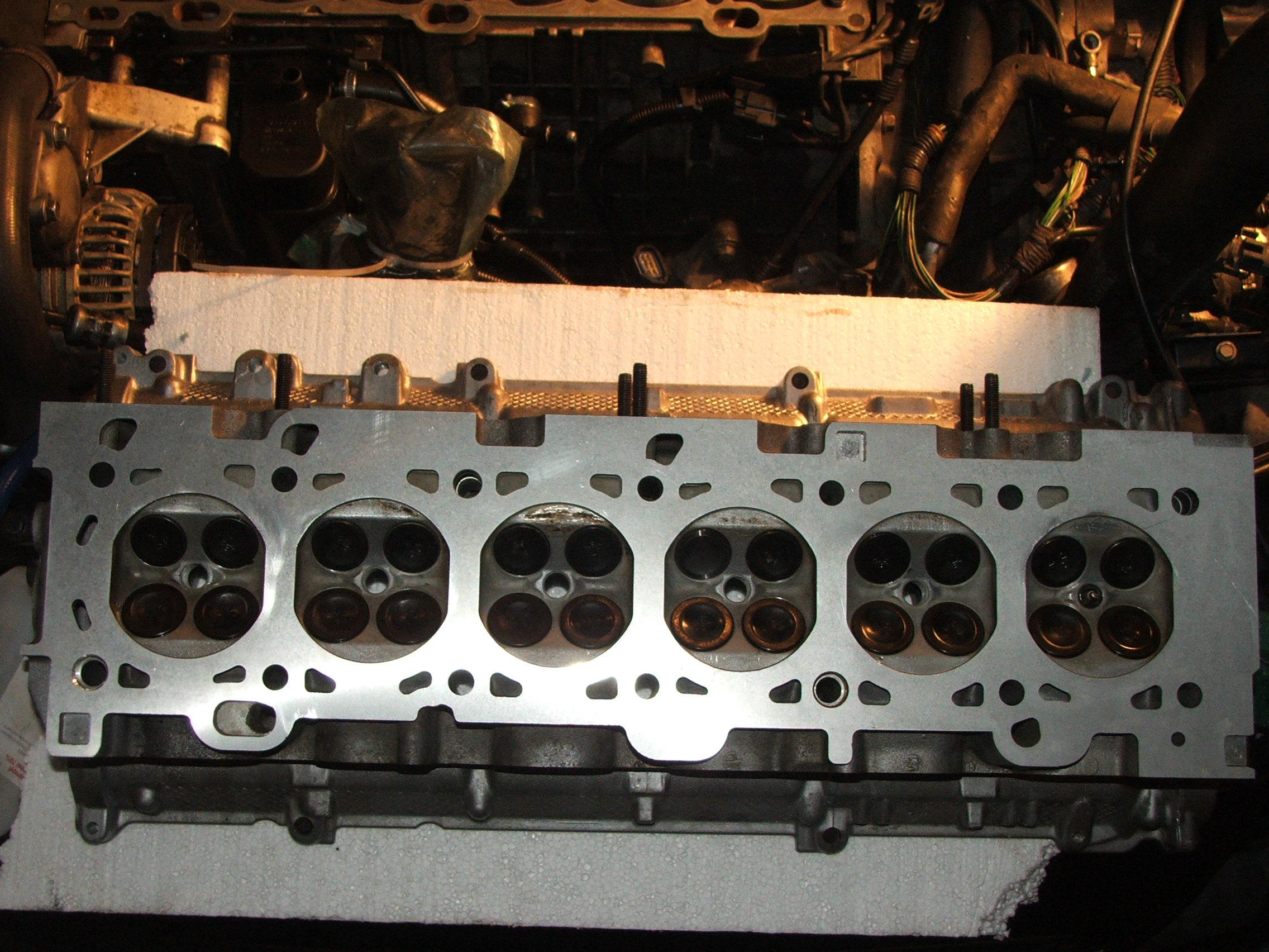

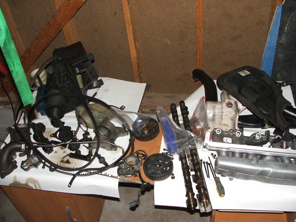

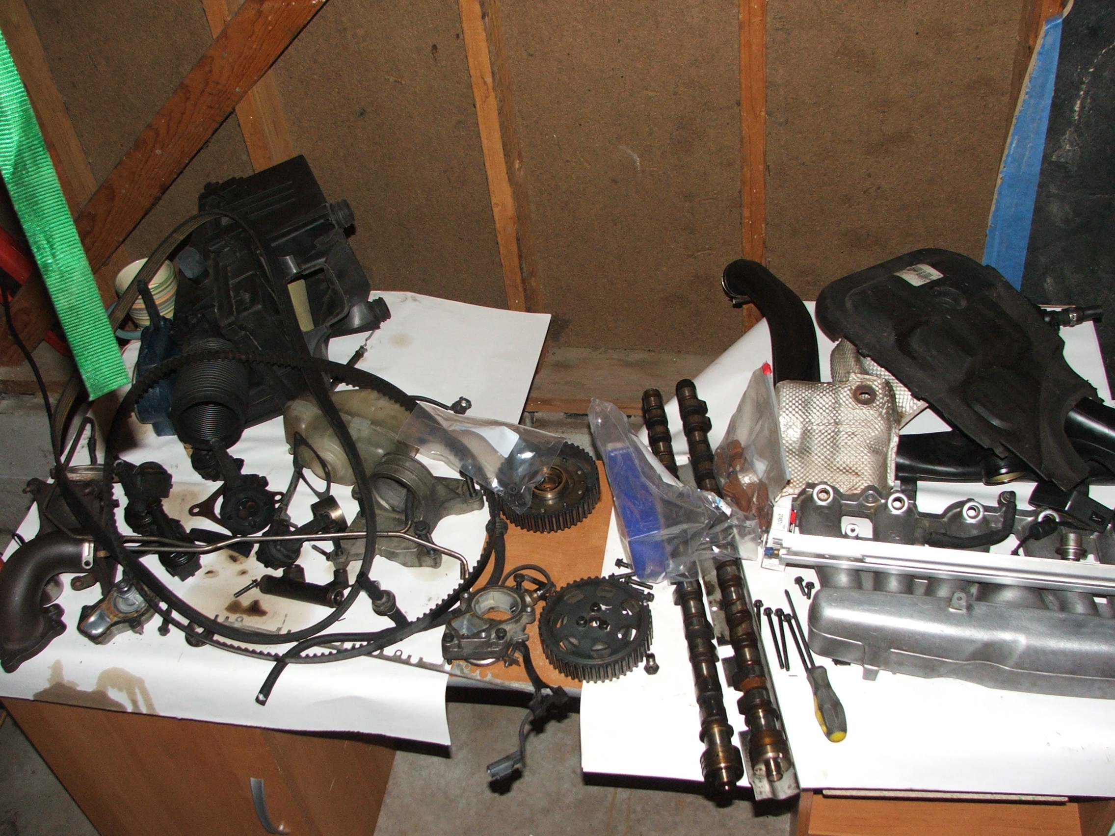

Fine mess of parts for me to put back together.

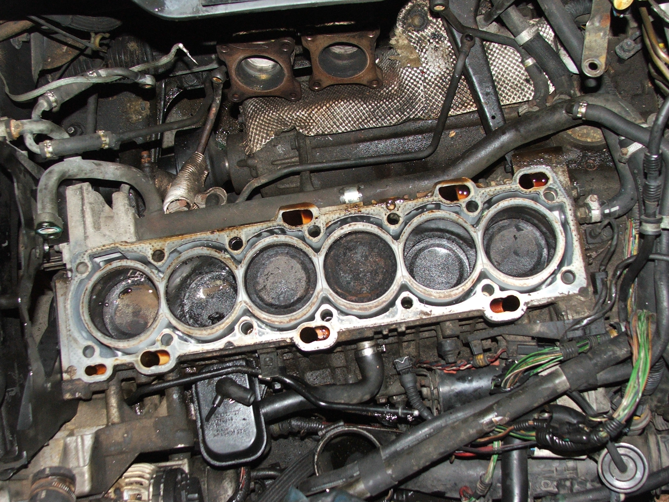

Pistons\Cyinders. Heavy carbon deposits. #4 was especially bad. LOT of carbon in there, loose too.

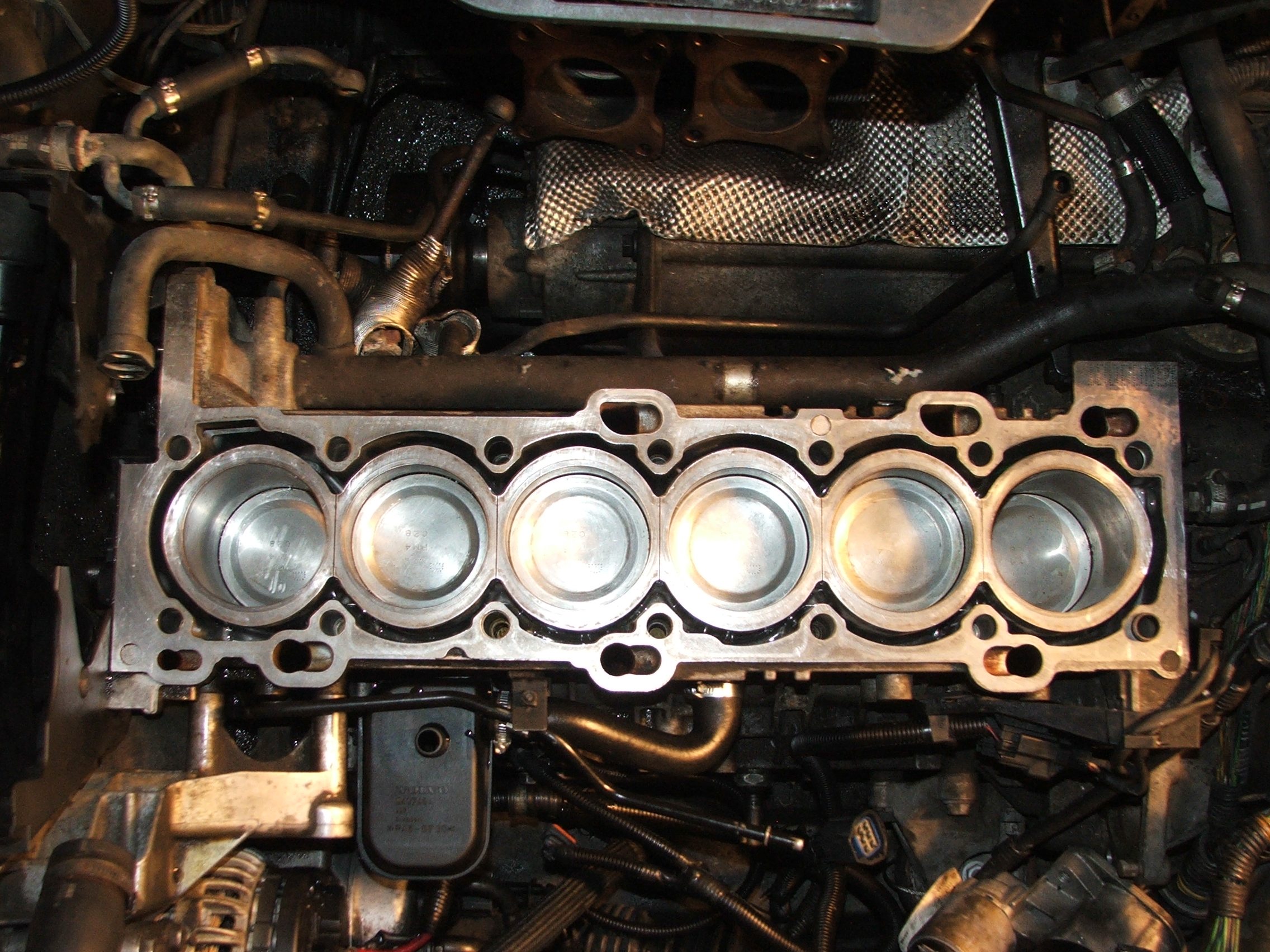

Pistons\Cyinders. Now much prettier :)

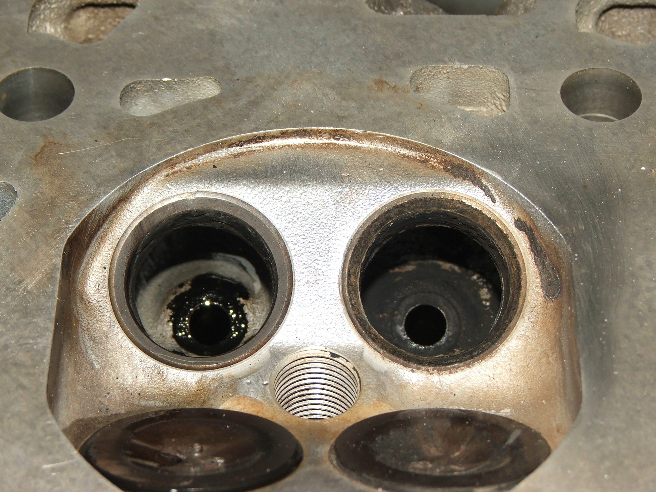

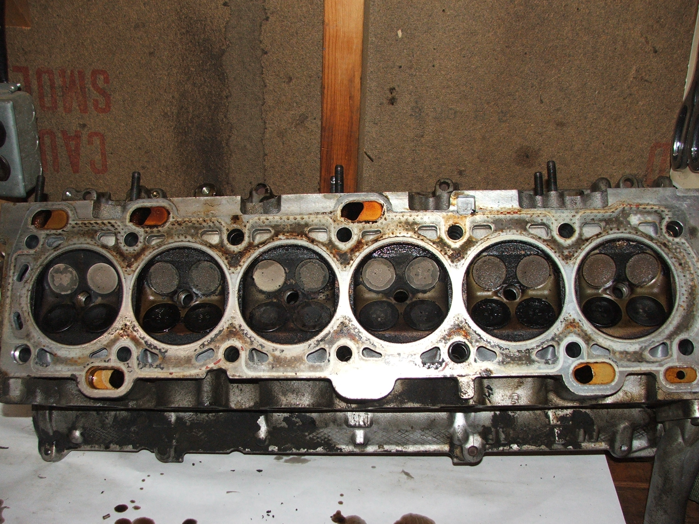

Combustion chambers in head before any work was done. A lot of carbon, but the pic really doesnt show it.

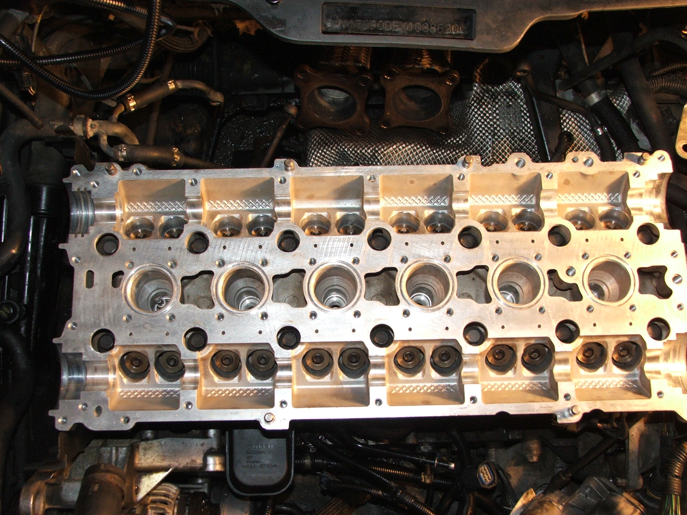

Head after cleaning, decoking and skimming. .006" removed to true it at the machine shop. I also reground the valves by hand and replaced the valve stem seals.

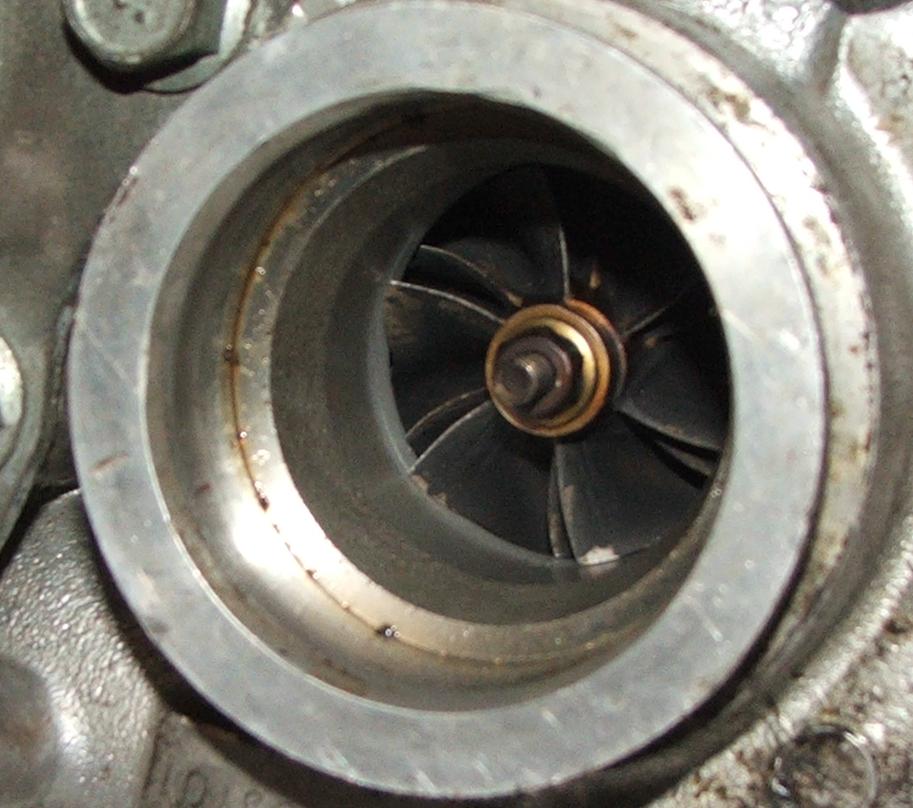

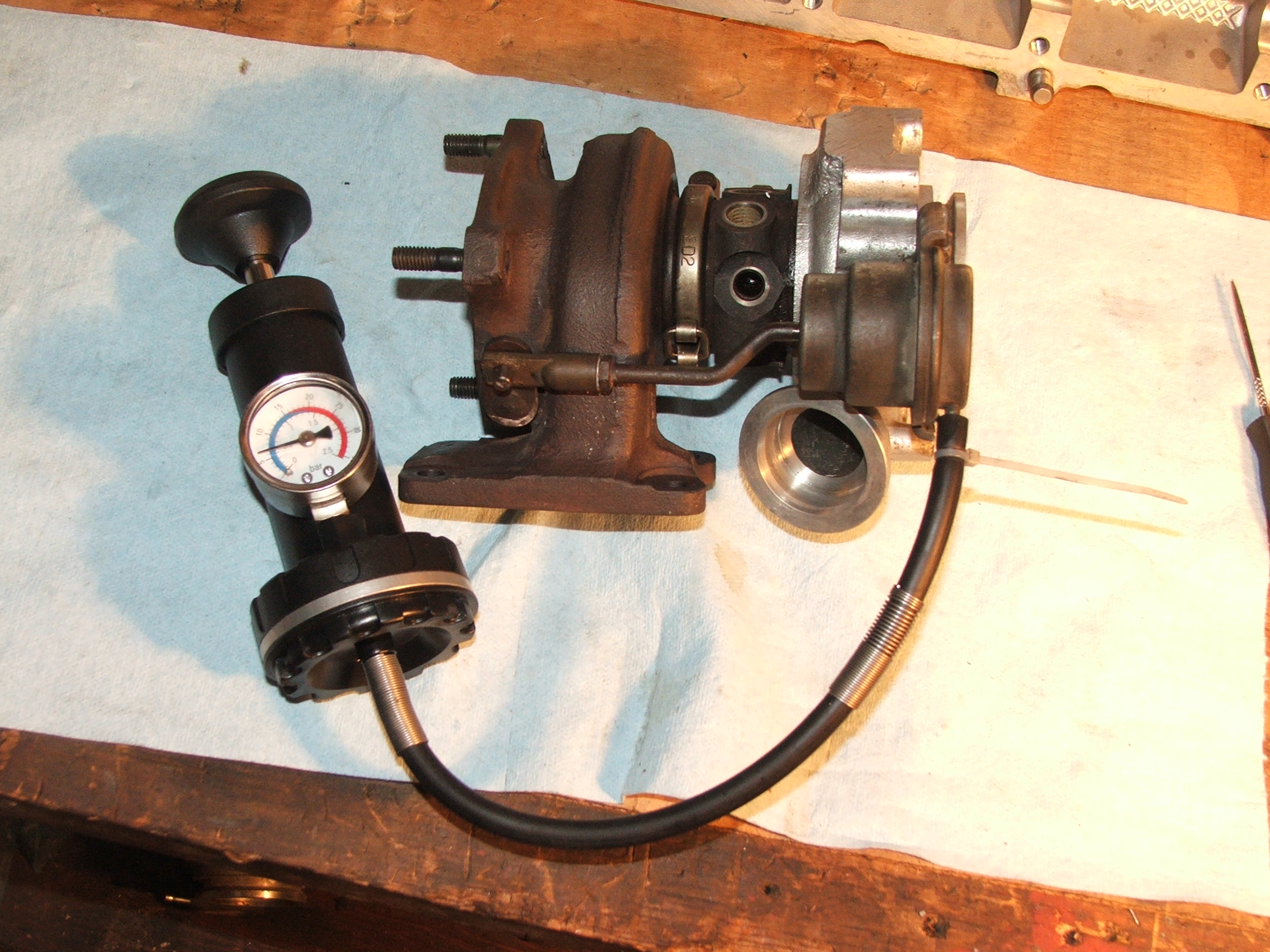

Panic time: Turbo #2 has evidence of the wheel rubbing the compressor housing. ##it!

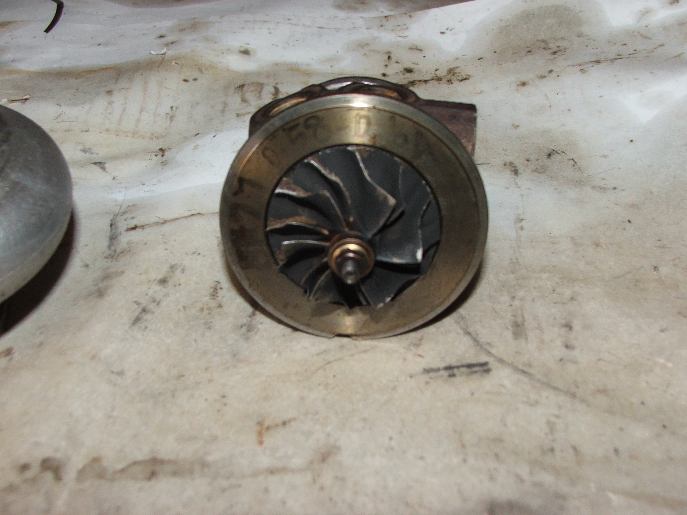

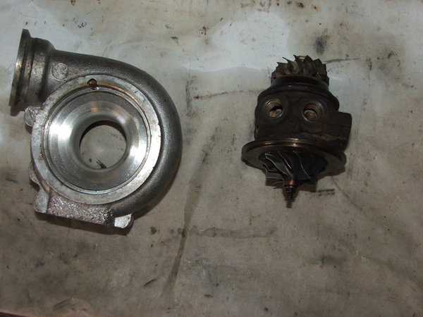

Turbo #2's CHRA (Center Housing Rotating Assembly) and compressor housing separated for inspection.
Compressor side of turbo #2. When I check the axial and radial free play it all came within spec. Writing on the CHRA and the different type nut on the wheels compared to #1 lead me to believe that it had already been rebuilt and the contact with the housing happened before I owned the car.
Hand-ground exhaust valve seats. After on left, before on right. Yeah, ideally you get a shop to do this, but I couldn't afford that. Besides, if you look at them it would have been hard to make them much worse!

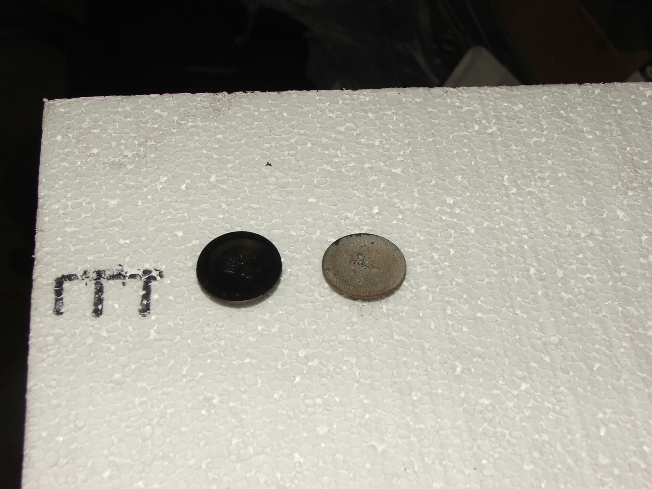

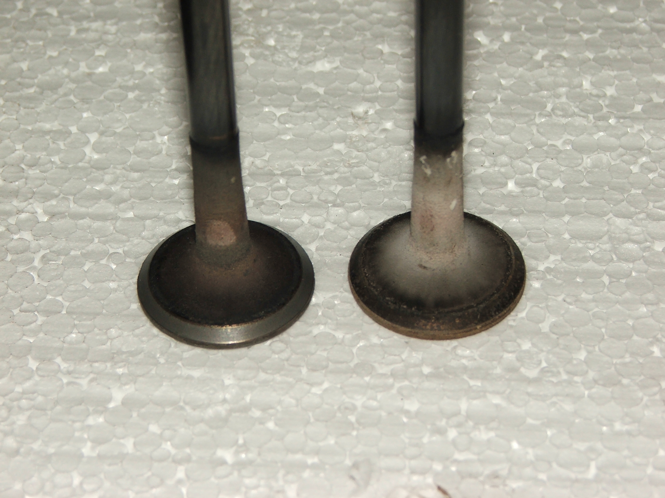

Exhaust valves. After lapping on left, before on right.

I see evidence of small coolant leak in cylinder 1 and even smaller in cylinder 2 . Was the head and block square?
Left most cylinder in your pics being cylinder 1
Retired

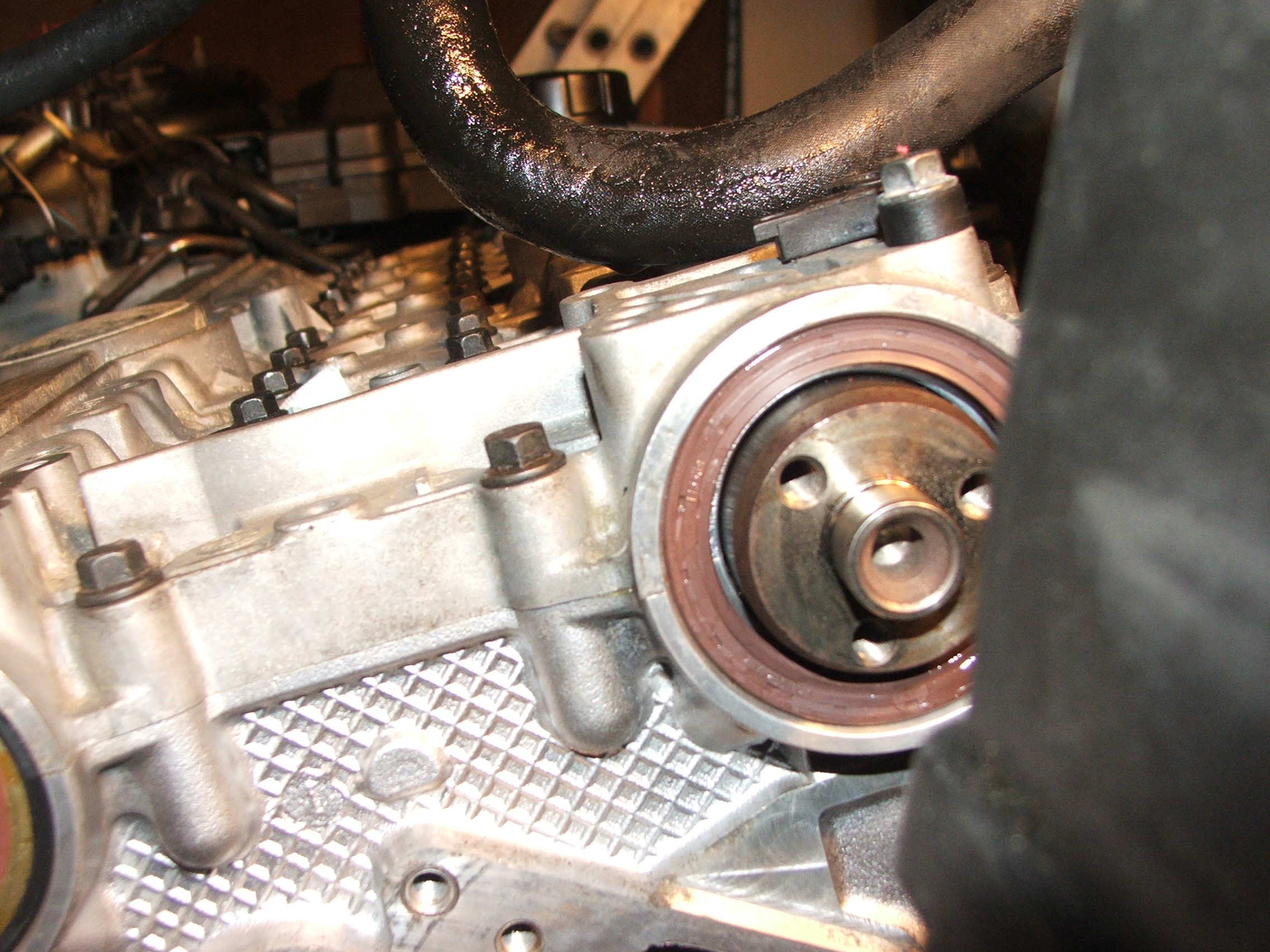

Do you have the tool that pulls the cam top half down to the head so you do not strip the 10mm bolts out when trying to pull the top half of the head down with them. or how did you do it.
boosted5cyl
Posts: 1100
Joined: 29 January 2010
Year and Model: '98 V70 T5, '99 S80
Location: St. Paul, MN
Been thanked: 1 time
Post by boosted5cyl »
I tapped the cam cover with a rubber mallet where the lugs were, then used the bolts gradually and progressivly to clamp it down. It required very little torque on the bolts in my case. Maybe it had been off before? But anyway, no tools used, just patience and a ratchet.
