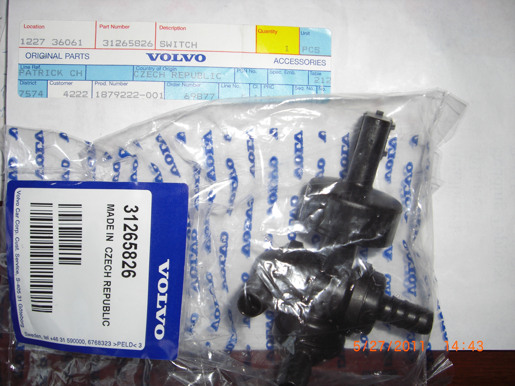

Thanks everyone for the information! You guys have really saved me alot of searching! I ordered the part from a local dealer (http://www.volvowholesaleparts.com)
The total price after shipping and tax was $66.08. The part number is: 31265826 and is listed under VADIS as "Cowl - Components on dash panel - Module Module 2003 – 2011" for my VIN. Strange place to post it, but the sales guy assured me it was the right part, and when I opened the package...BAM...it was dead on! :-) Here is a photo of the new piece, all shiny and nice...to bad it wont stay this way :-)
Thanks again guys!!!
