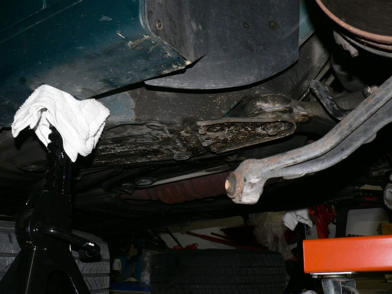

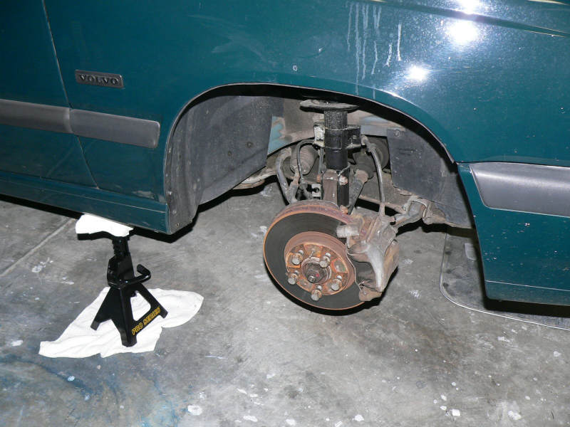

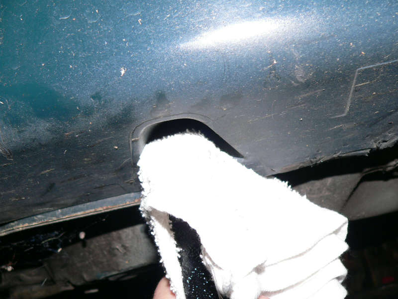

Under the door there should be a cutout along the frame that fits a jackstand perfectly. Not sure if this is the "correct" location but it's been holding since about noon today.
- Volvo 850 jack stand location
- volvo 850 jack stand location.jpg (96.5 KiB) Viewed 6961 times
- Cutout for jack stand to fit horizontally
- closeup.jpg (82.6 KiB) Viewed 6961 times
- Sub frame is clear
- subframe.jpg (83.46 KiB) Viewed 6961 times

Yep, just like wheelsup showed! See his tires placed under the frame as well in case it falls?xHeart wrote:Yes. A 2-1/2 ton floor jack to raise, and two 3 ton jack stands to keep it there. A small 2 ton trolley jack.jblackburn wrote:You have two jack stands right? Put one under each door. Lift by the subframe bar in the middle.
I hope you have an actual floor jack and aren't using that Volvo piece of junk. The car will fall off that thing and kill you.
Once raised and jack stand placed safely under the door-rail, do i lower the floor jack and pull it out from underneath the subframe?
