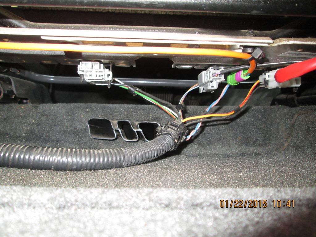

Thanks Lee. Just wanted to post some photos of the wiring. Sounds like the green/purple is for SRS. I might try disconnecting, cleaning, and soft starting the ECU. Likely wishful thinking. Do you think the SRS and heated seat issue could be related? They both occurred recently.

Reinie wrote:Thanks Lee. Just wanted to post some photos of the wiring. Sounds like the green/purple is for SRS. I might try disconnecting, cleaning, and soft starting the ECU. Likely wishful thinking. Do you think the SRS and heated seat issue could be related? They both occurred recently.
That is correct for the SRS wiring, no obvious issues jump out at me. I doubt they are related unless the wiring harness to the seat somehow got chopped.
