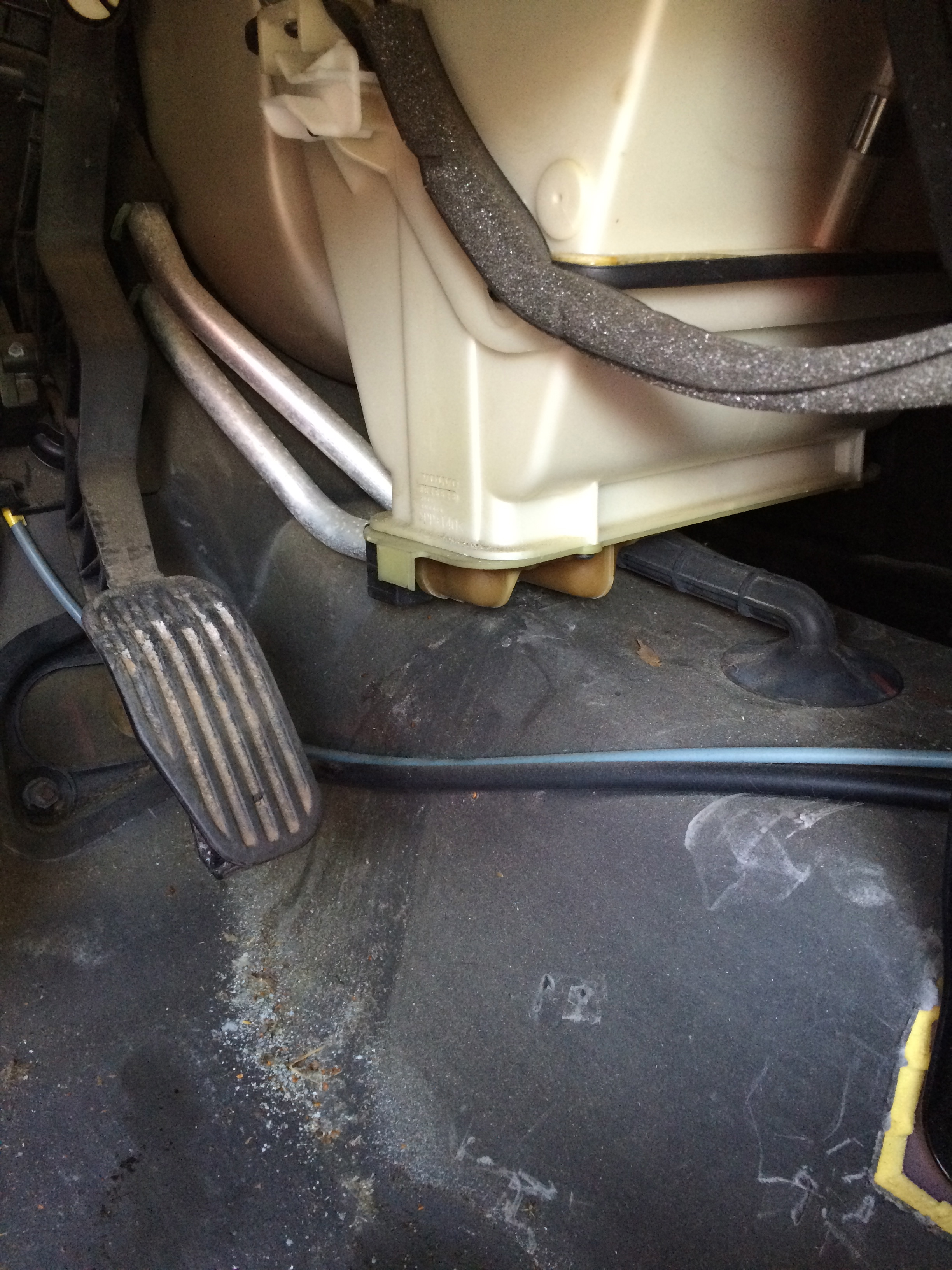

I've been getting some water on the drivers side floor mat for a while. At first, I thought it was just straight water leaking in from outside, but after digging around, I'm fairly sure it's coming from the heater core area.
The real question is: Is the leak from the heater core itself, or from the connection between the hoses and the core? Pic is attached. Follow up question. Assuming it is the heater core, what's the recommended replacement part? Nissen or Behr?

hard to tell from the pictures. Your car being a 96 I would go with the heater core. I have used the $49.00 heater core from ebay Sweedish auto parts. Seems to work well. There are a number of posts regarding this core.

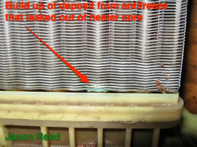

I did this a few months ago and wrote it up (using the "ebay" heater core):
https://www.matthewsvolvosite.com/forums ... hp?t=69238
- jreed
- Posts: 1665
- Joined: 08 Mar 2009, 05:43
- Has thanked: 384 times
- Been thanked: 221 times
I agree with the above. I recently replaced the core on my '97 as a preventative measure. When I got the old one out I could see places along the plastic-metal bond area that showed signs of weeping coolant.
I wrote up a short description of some of the methods and tools I used during the replacement process here:
https://www.matthewsvolvosite.com/forums ... hp?t=67723
